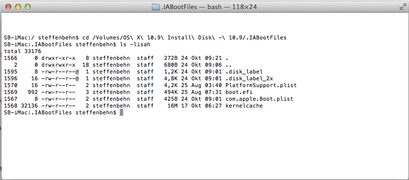

I checked the USB stick in another mac and the kernelcache is actually available at that location (screenshot). I also already tried to redo that USB stick without any success.
