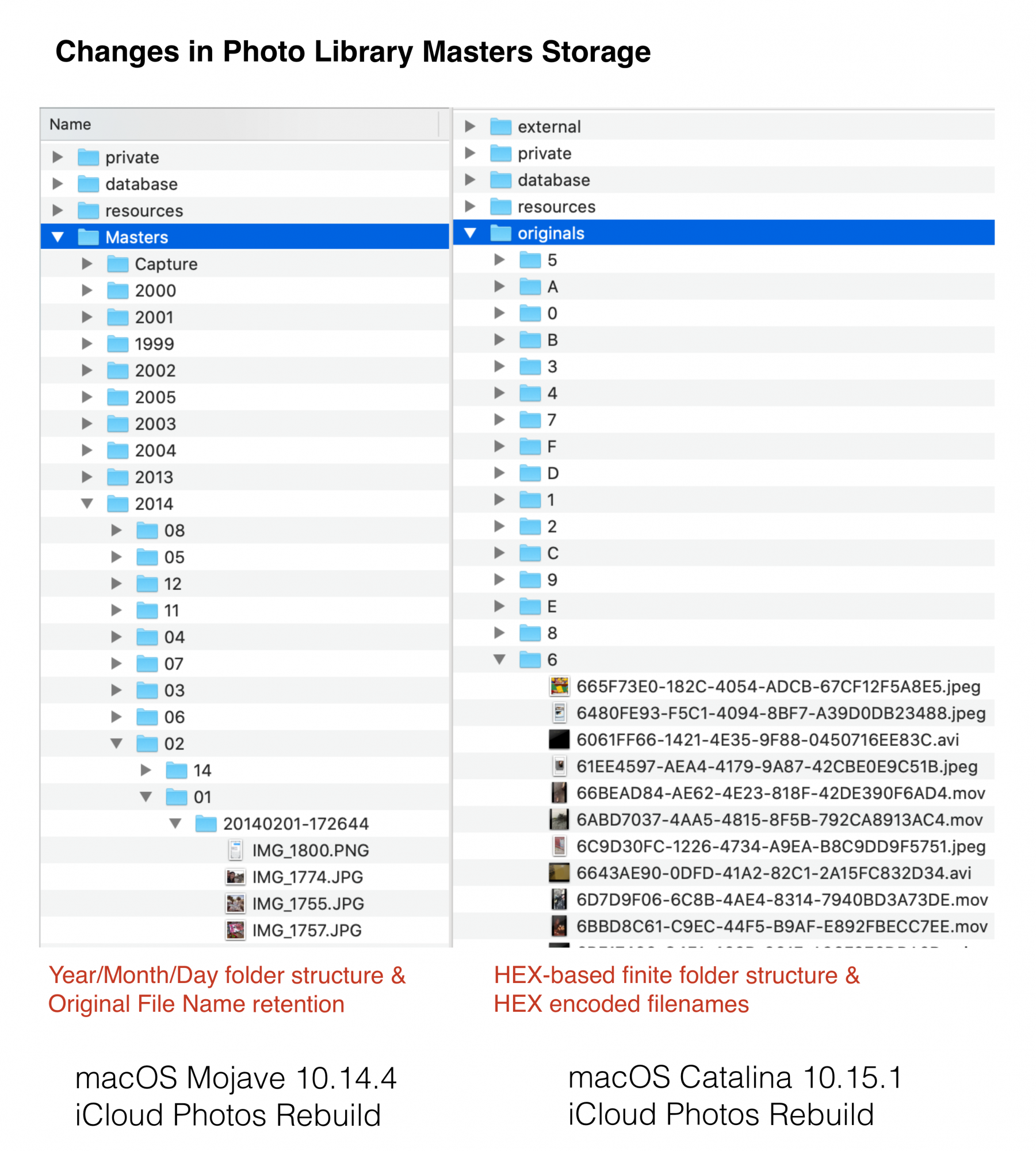

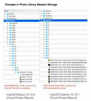

While it isn't visible in the app itself, there is something very odd with how Photos is rebuilding Libraries from iCloud in Catalina:
If you drill into "Show Package Contents" and compare to previous library file structures Photos is updating the Masters folder into the "originals" folder with a HEX filing method that is far less human-readable than before (see diagram).
Why does this matter?
If you've ever wanted to port your photo library to Windows, an easy trick was to copy the Photo Library to an NTFS drive, mount it in Windows and Apple had already made Bridge-friendly folder system under the Masters folder for browsing. With this new structure, the original photos must be "processed" by the Photos app Export function to be ported over and the organization can't be foldered by day, but only by generated "Moments".
This feels like a subtle platform lock-in by technical grief.
