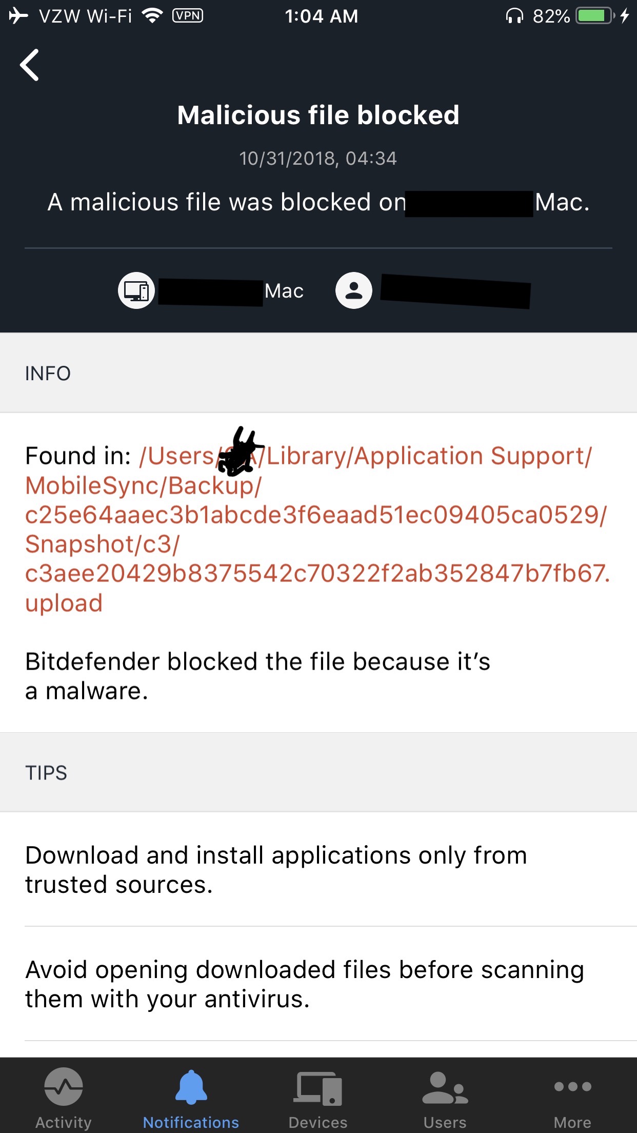

Unless I'm reading this wrong, it seems back-ups can be corrupted or have corrupted elements within and be ported over. I'm not sure how to get everything over clean as all of my backups are through the cloud. I do, however, try to protect against in the best way I can in order to keep my past important data going forward..
That is very interesting. But it could just be a false positive. Was that all via iCloud?
