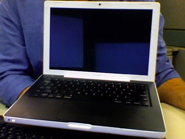

Well, the cleaning spray worked great. Of course, I destroyed a keyboard connector taking it off, but i have a spare blackbook keyboard.
Here's the temporary result (will put a white keyboard on it this weekend). Until then, I dub it "the PandaBook"

Wow that looks good…*You should keep the black keyboard but swap out the top case for a white one 😀
Well, the keyboard and top case are a single unit. I could swap the keys, but this keyboard is a late model, and the white spare I have is early. That means the Function keys are different. So this one, volme is f10-F12, and if I put on the white key tops, they'd be messed up.
I have two buyers lined up for it with a white keyboard. I'll keep the black one, and find some more broken macbooks and fix them up! (new hobby)

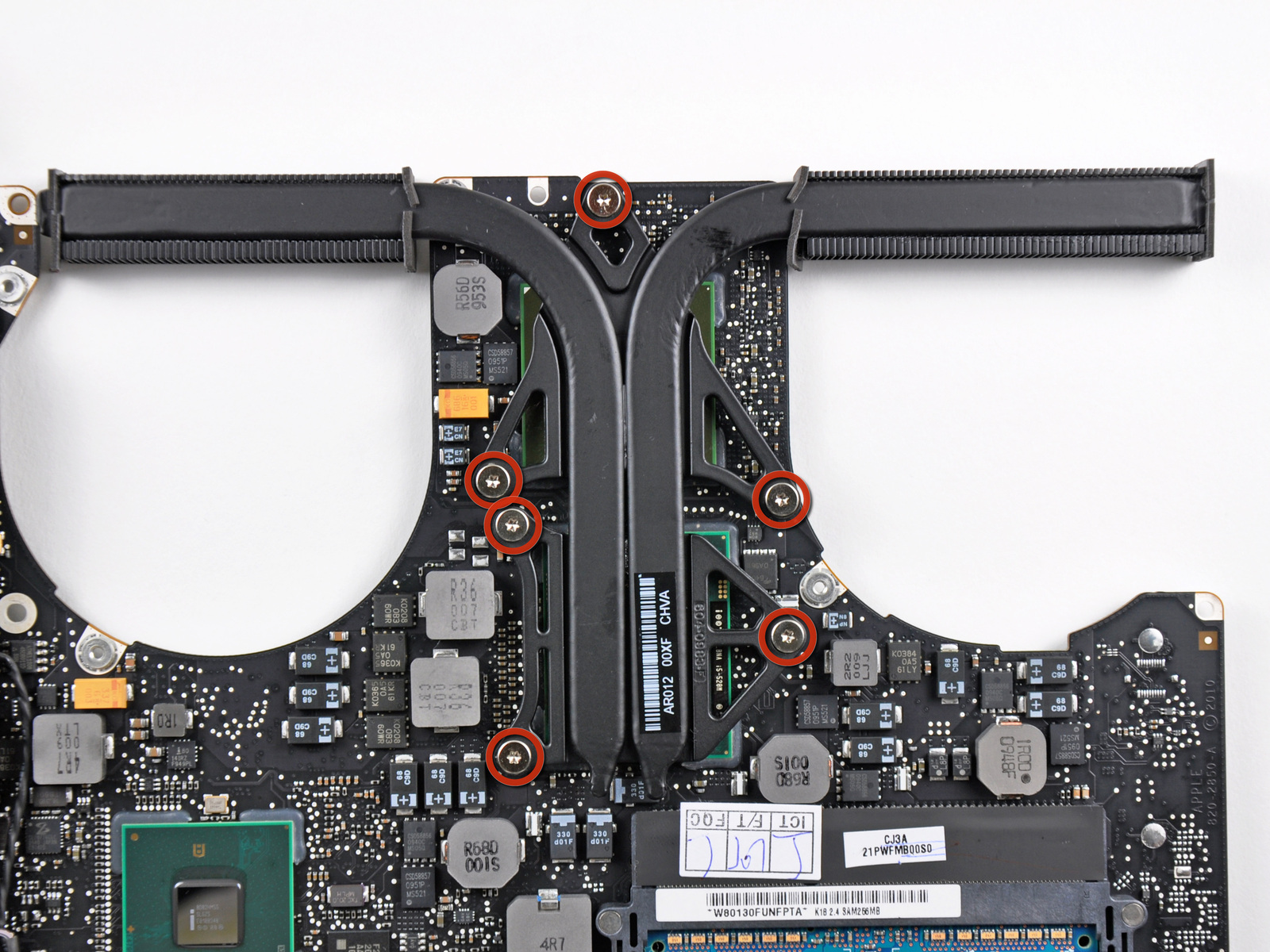

question
sorry to bring this thread back to life...but i had a question
when washing a logic board should you remove the heat sink..or is the water (~140deg) not hot enough to affect the thermal paste?
