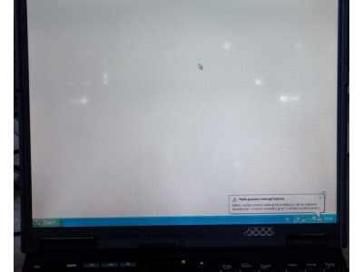

However in using the alcohol I think some may have gone through the headphone jack to underneath the screen. As a result there is kind of a cloudy appearance at the top half of my iPhone 3GS screen.
I currently have my phone in a cup of rice in order to remove the alcohol that may be present however there appears to be some bright white splotches and surrounded by a darker clouded appearance. The marks are similar to those which can be seen on a laptop monitor (e.g.

Yeah I'm going to leave it in rice overnight for the next few days. The alcohol gave a kind of clouded appearance which is now gone but the white spots are still there 🙁 I have noticed that they are not there when the screen is switched off but are there when it is on. They are not dead pixels though as they do show what they are supposed to show... just brighter and they remain the same with changing the brightness setting.. ;(
