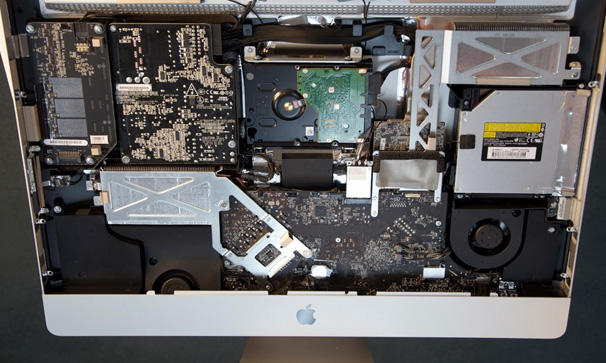

I've had my iMac apart and I really don't recommend this without opening it. I think the dust will mostly land inside the case if you don't. You should definitely clean off the intake vents, though.
Here you can see the problem. Of course, your model may be different.

The picture that Mr. Buzzcut offered is not even close to a 21.5-inch Late 2012 iMac.
You can look at the teardown at the iFixit site for your iMac model.
You'll see that there is only one fan. The intakes are along the bottom edge, and the outlet is the square vent underneath the hinge.

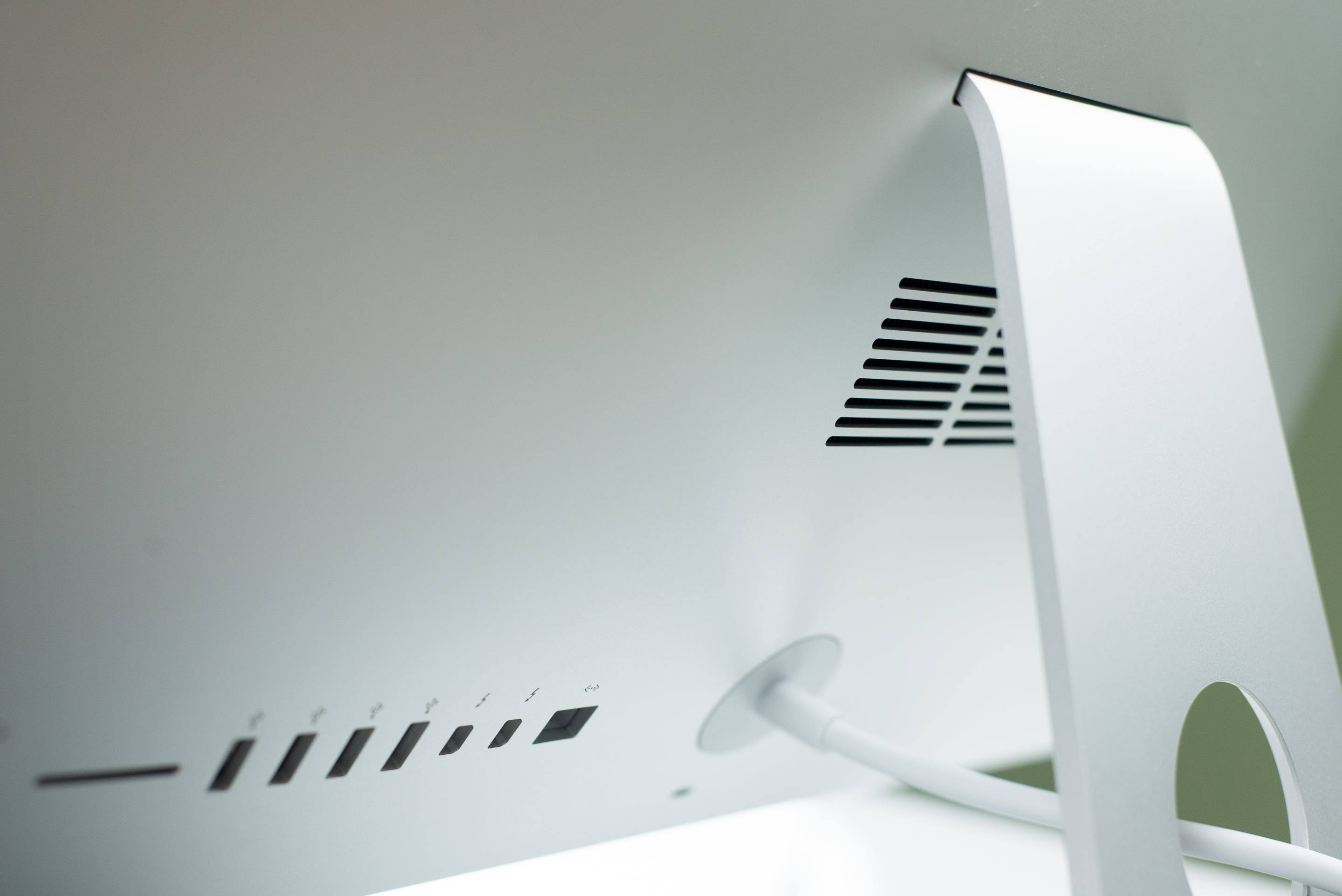

It seems you have the 2012 21.5" model. I didn't own this Mac, but after check it's layout. I suggest you switch the iMac off, and blow from the exhaust.
For turbine type cooler, this way works better. HOWEVER, this is mainly for recovering the fan's performance (if you assume the dust make the fan draw less air etc). And it cannot remove the dust from the iMac, because for the iMac design, it's almost impossible to remove the duty without open it. What you are doing is blow the dust away from the fan (or make them no longer attached on the fan), so, the fan can perform. And when you switch on the machine again, you can manually run the fan at full speed to try to draw out as much dust as possible (assuming the dust are free to move again).
I don't think it is worth your time to disassemble (cutting the case open) just to clean the newer iMac models - if that is your only goal.
Now, if you are considering upgrading the RAM, or swapping out the hard drive, then a full cleanup is something that you can do while getting everything else done.
My mistake. I overlooked the signature. I stand by my comment, though. There isn't going to be a good way to make sure the dust exits versus disperses within the chassis.
