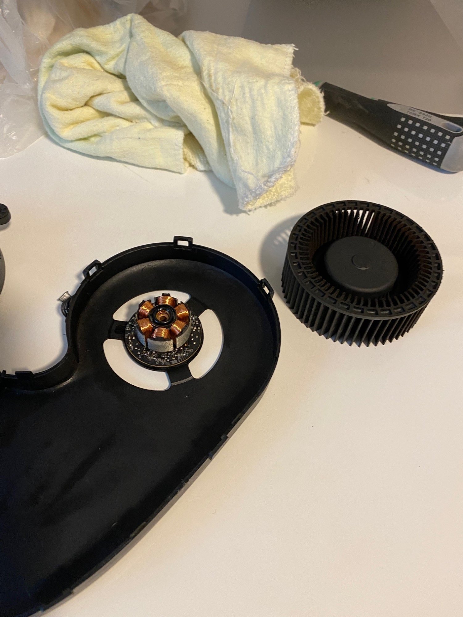

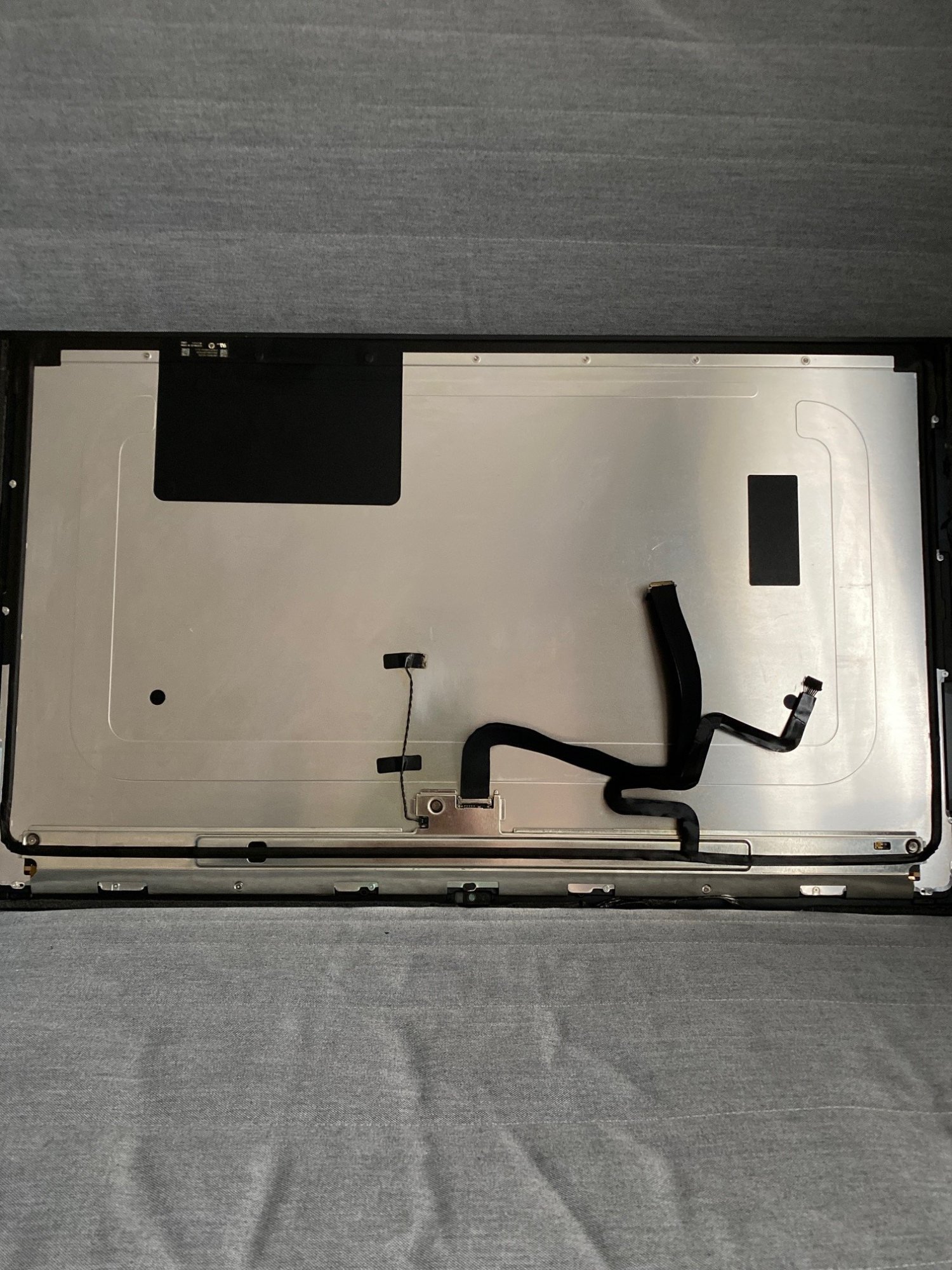

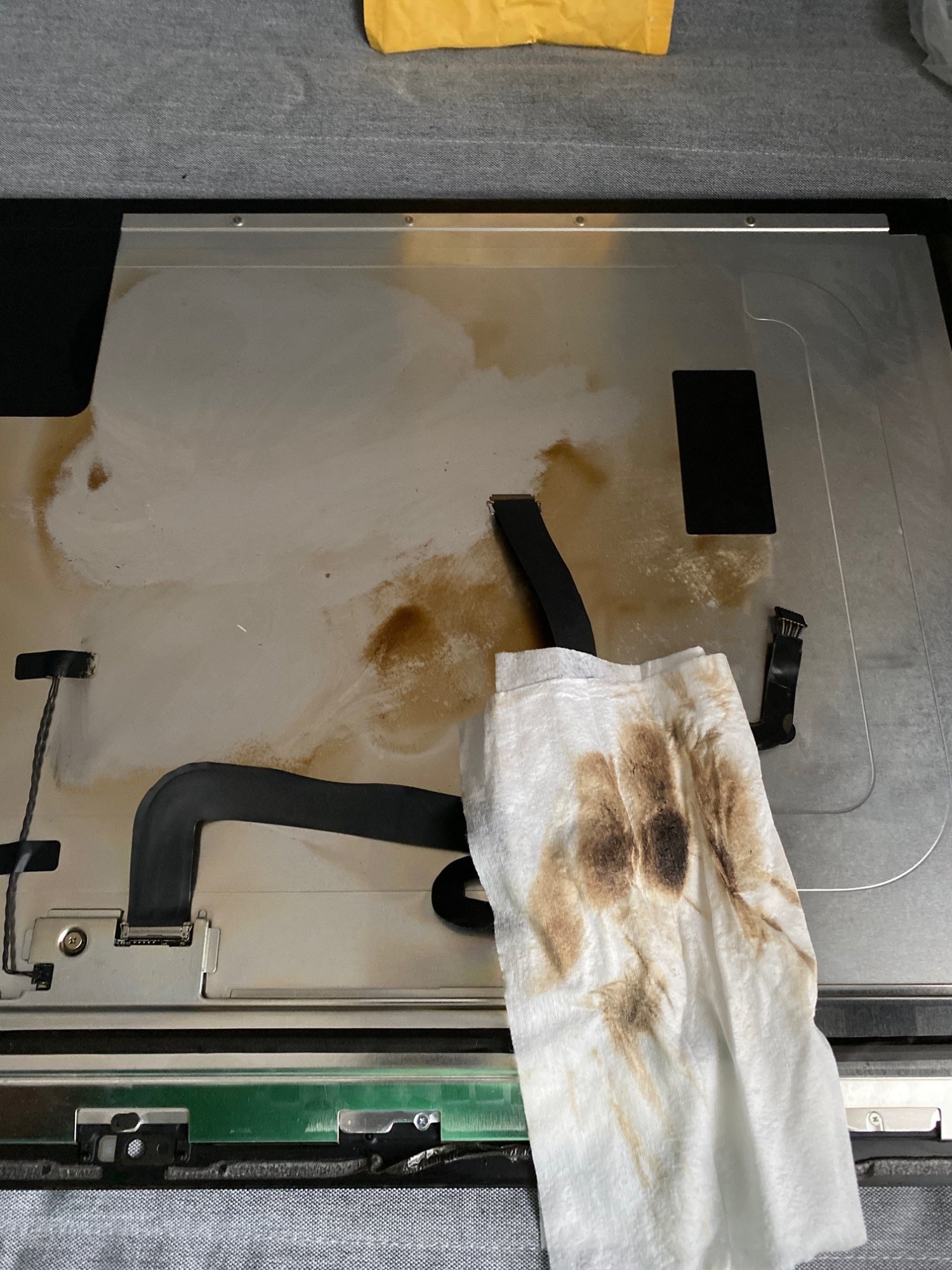

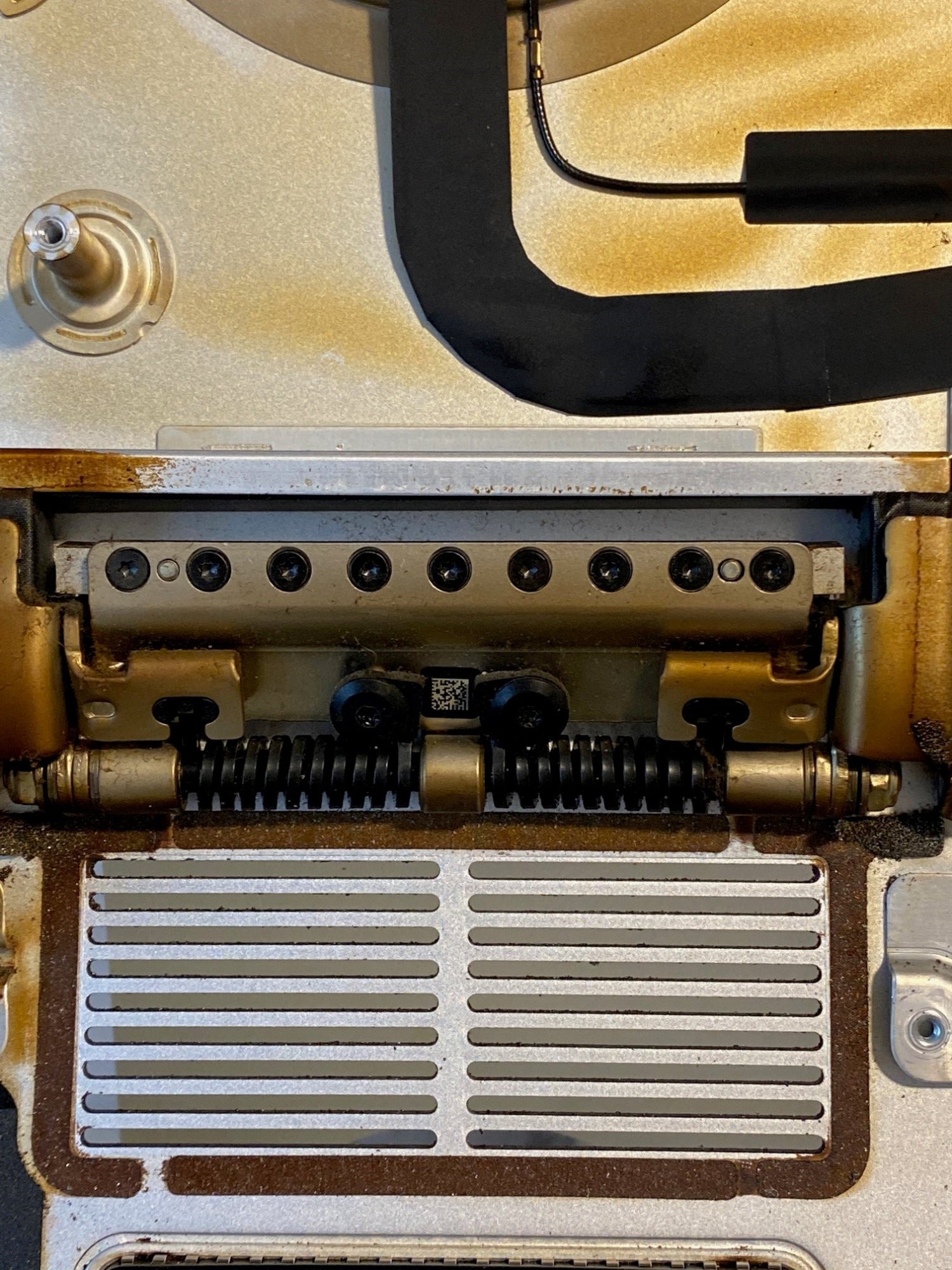

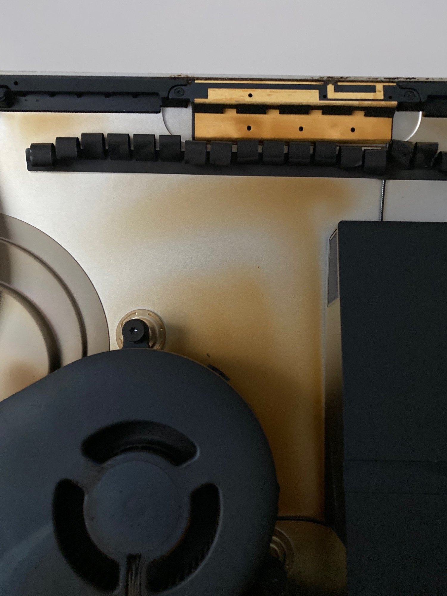

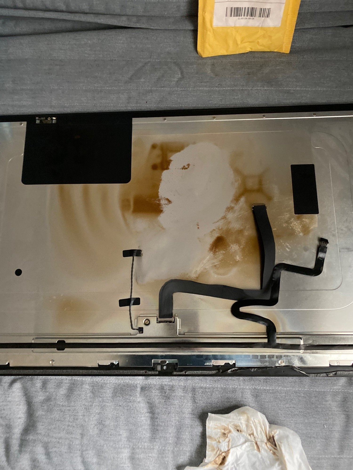

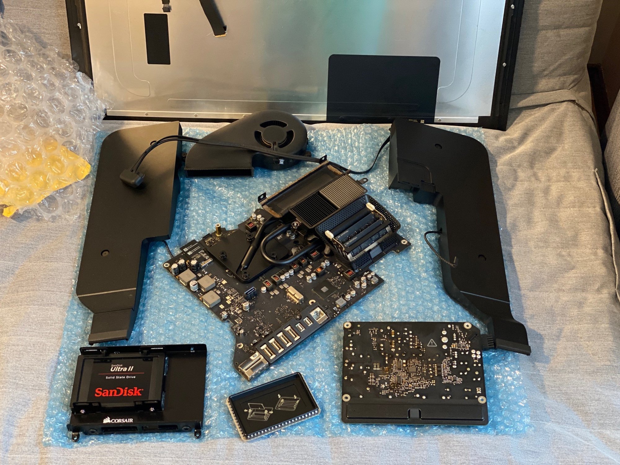

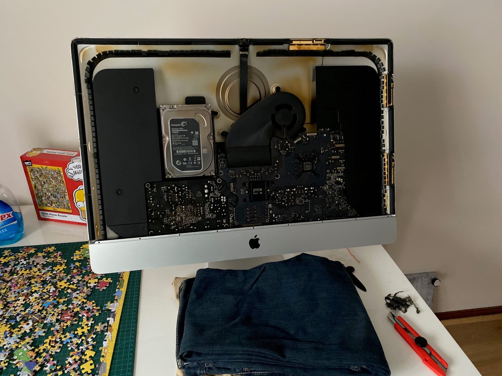

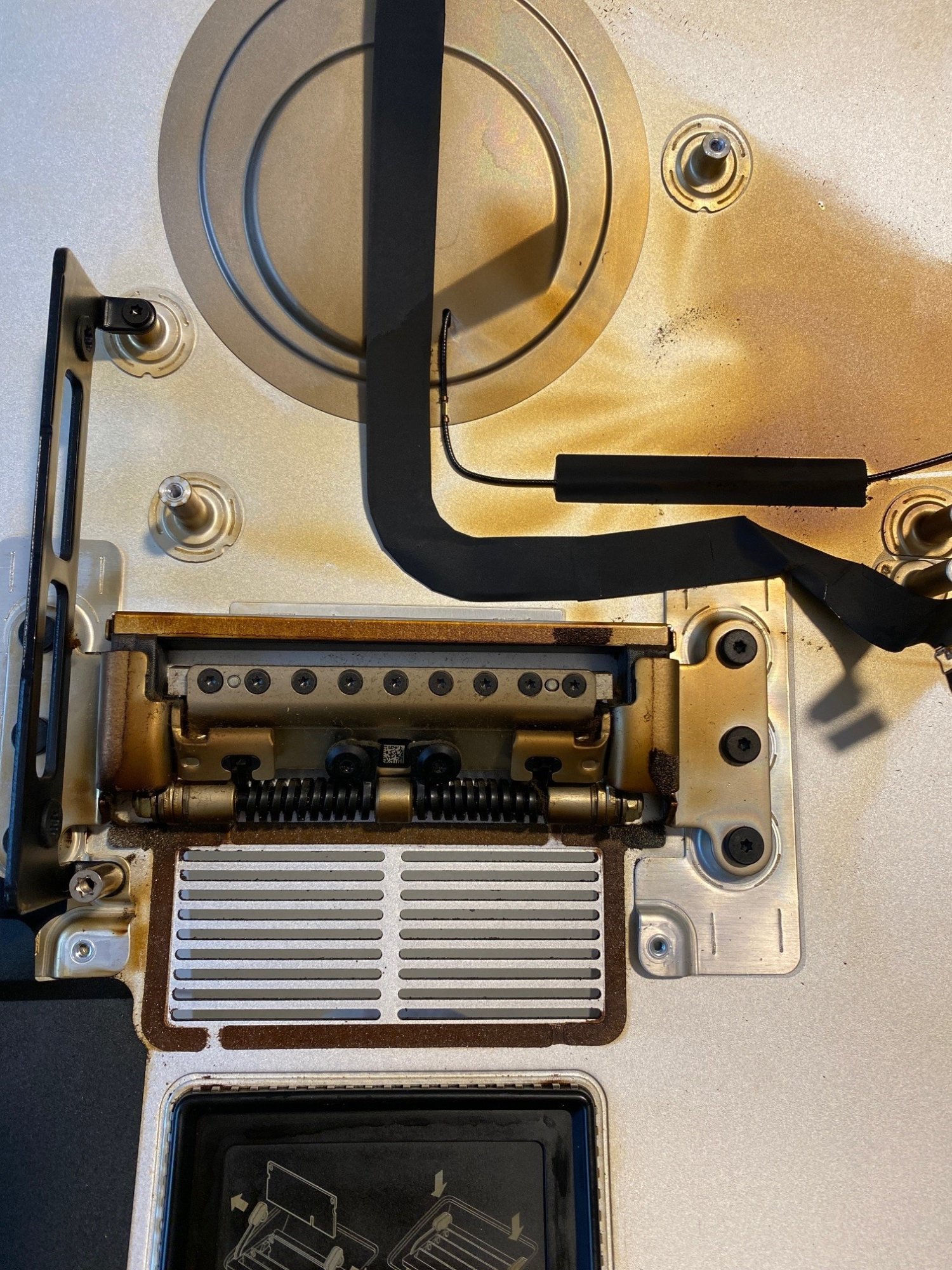

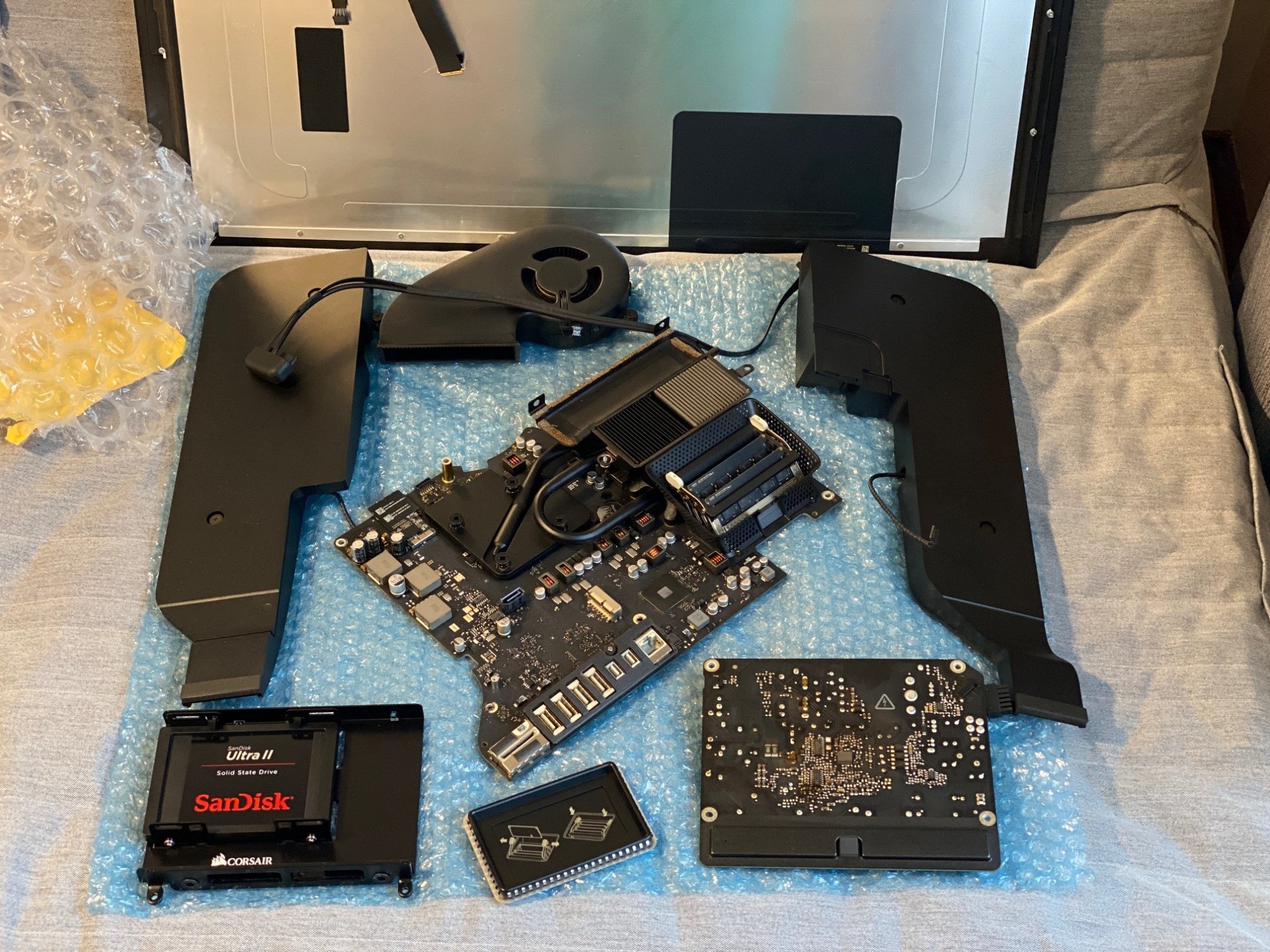

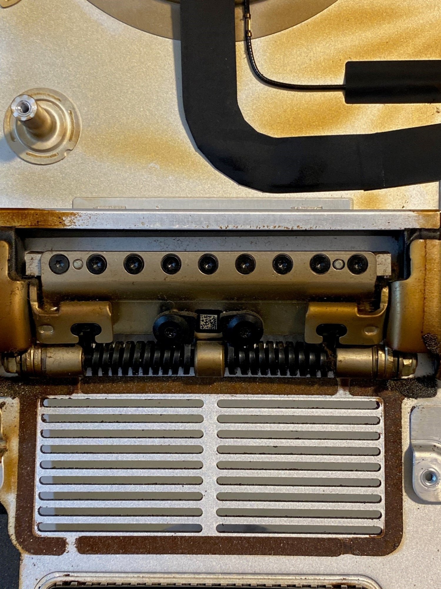

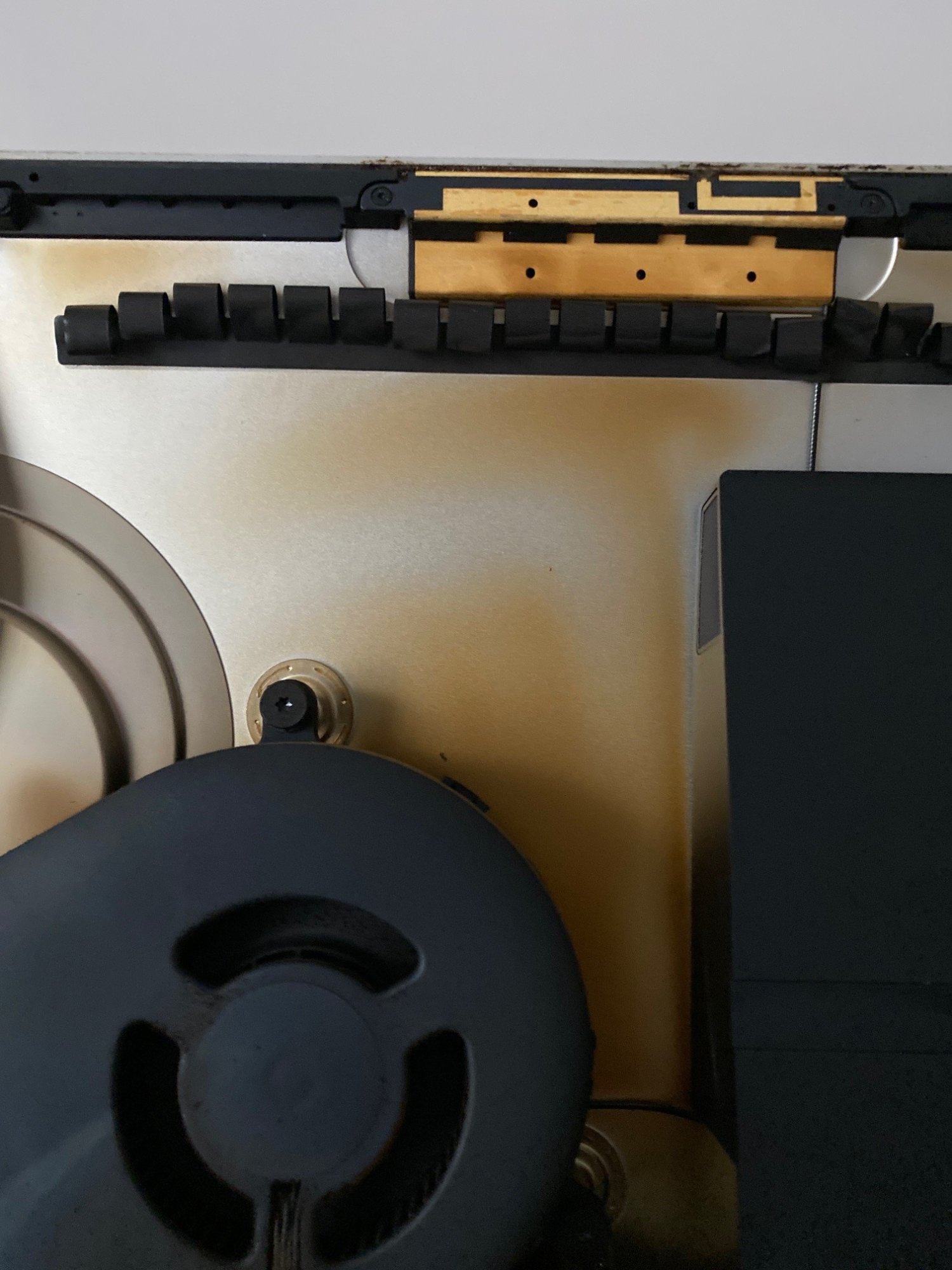

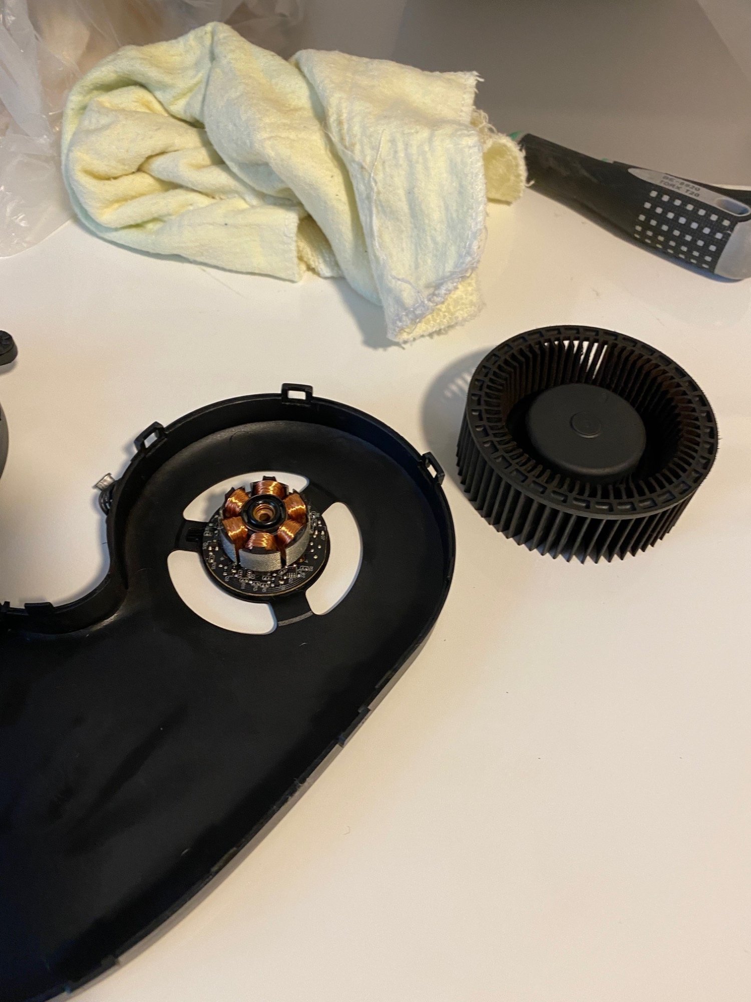

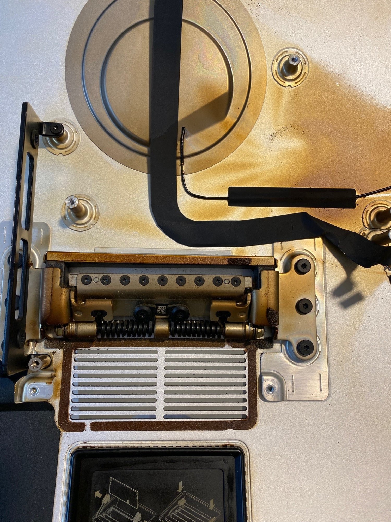

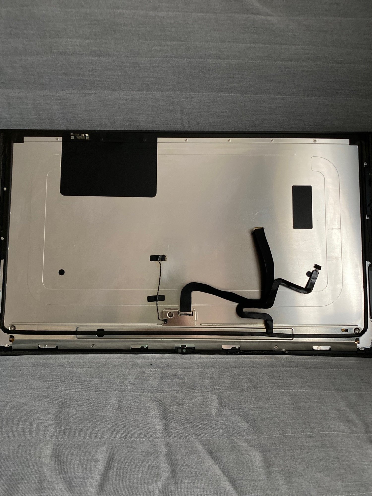

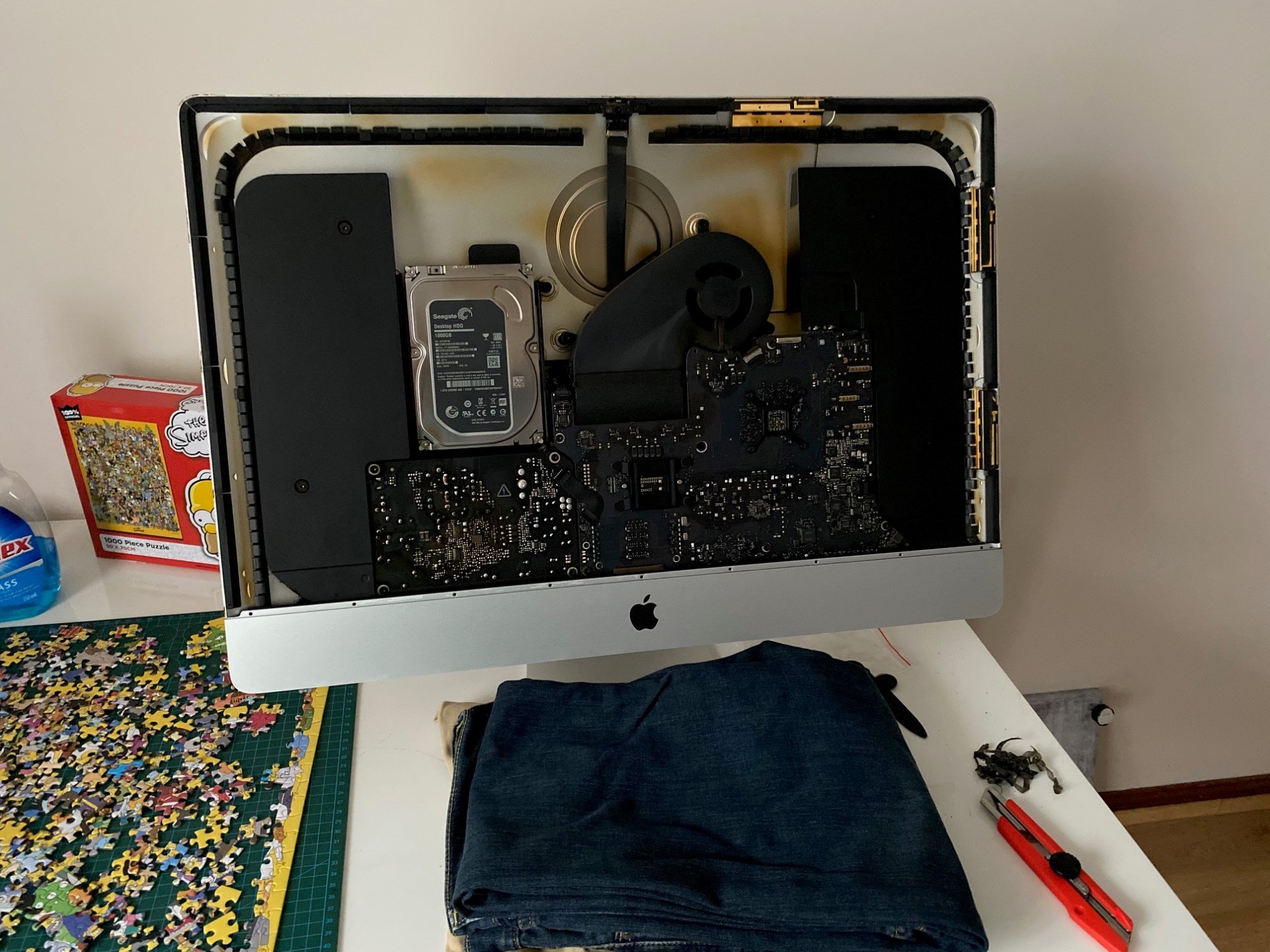

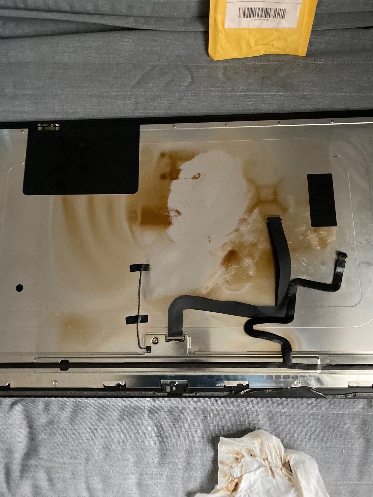

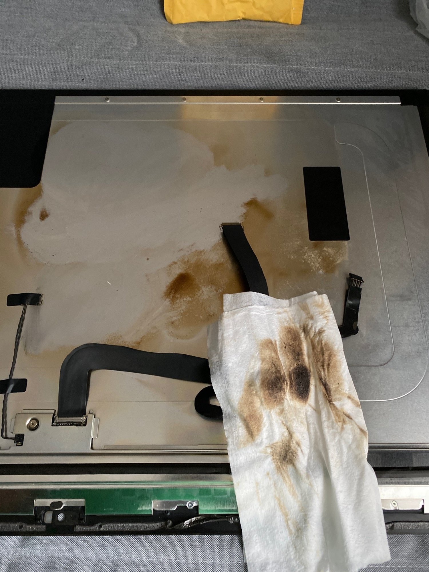

Getting inside one of these things isn't as hard as it sounds; daunting, definitely, but working slowly and methodically is key.
The first 27" I opened was a Late 2013 that had previously been owned by a heavy smoker so those "bunnies" were more like slightly damp tobacco. I reckon I must have spent a good 2 or 3 hours cleaning before I even considered doing any upgrades.
The maglev fan in the iMacs is a very cool thing to see though, almost worth stripping it down to see that alone. The design allows it to be carefully prised open so you can wash the fan blades in hot soapy water 🙂 Clean!

Thanks for the pics. They'll be a big help. Even though I've repaired things like defibrillators and IV pumps I always get more nervous when I'm fixing my own stuff. 🙂
I didn't know about the fan. Cool design.
