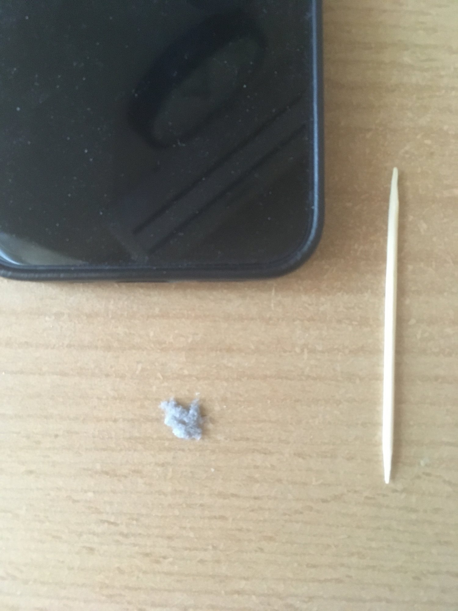

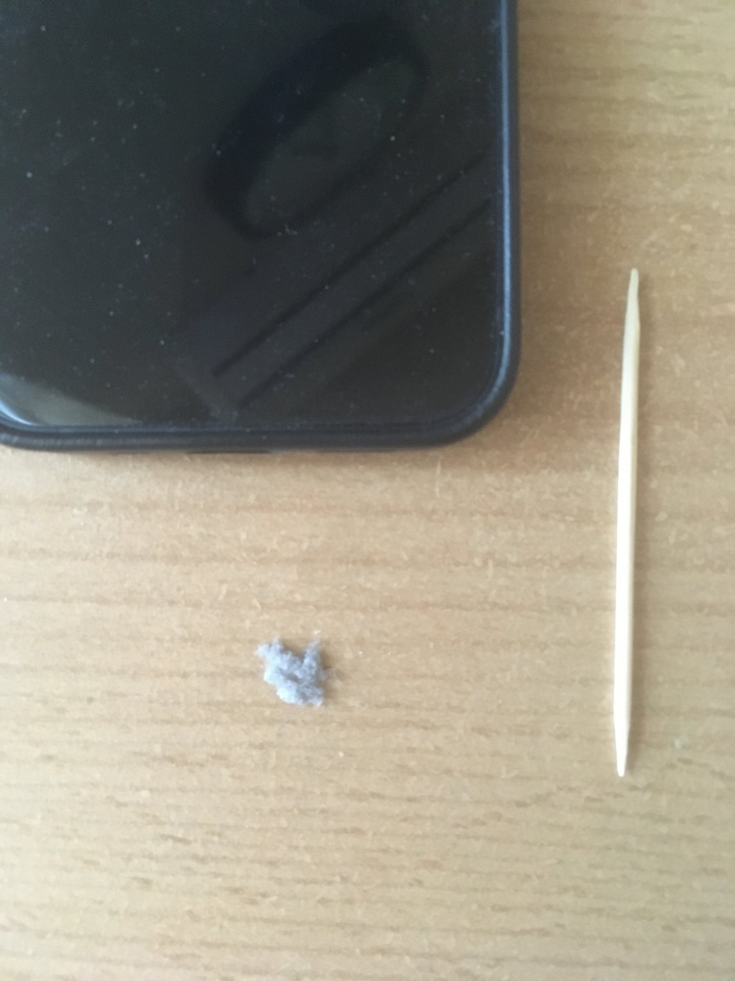

I managed to clean my iPhone 12 charging port using a wooden toothpick. First, I powered OFF the phone and then VERY GENTLY scraping inside the center of the port and came up with moderate dust and lint from the attached photo.
My question is, for future reference, once placing the toothpick inside the charging port, what exactly is the prefered movement of cleaning? Is it from right to left or from left to right? The way I've done it, is that my movment with the toohpick was from left to right keeping the toothpick in the cetner of the charging port. I do not know if the pins or springs are below or on top of the port assuming that the phone's screen is facing upwards. I did it with the phone screen facing upwards.
To avoid the pins from damage, how can I tell if the pins and springs are on top or below or on the sides of the port itself assuming that the phone is facing with the screen upwards?
I know for a fact that I did it keeping the toothpick at the center inside of the charging port and then GENTLY swiping it from the left to the right.
Please explain which would be the best tenchnique or movement when cleaning the dust out using a toothpick.

I know, that’s why my phone was not charging normally.

I've done this with my phones. That is a big piece of lint!! I've had ones that big too. I don't think direction matters as much as being gentle. I try to look into the port with a light to locate the lint and then gently probe that area with a wooden toothpick to delicately remove the problem. That way I'm not blindly swiping back and forth with the toothpick.

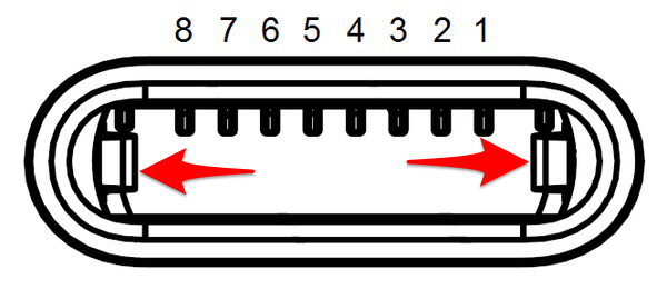

There's a spring tab on each side of the port which are pretty strong. You won't damage them when carefully picking out lint with a toothpick.
The contact pins are on the top of the port. They're more like contact surfaces than actual pins. There's nothing on the bottom of the port. There's also nothing at the end of the port.

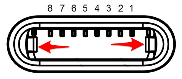

I found a diagram of how the insides of the connection port looks like. Based on your response and explanation, is this what your referring to?
Would this diagram of the port be the same for the iPhone 12 Mini?
And by looking at the port diagram, is this assuming that the phone is held screen up or screen down?

Look inside the port with a magnifying glass and flashlight. You'll see for yourself. You'll need it anyway to verify if the port is cleaned out or not
Checked with magnifying glass and it seems that the pins are on the top when the phone or connection port is viewed with the screen side facing down. The drawing looks misleading if that is the case.
All ports since iPhone 5 are the same. Even the miserable USB 2 speed😉
