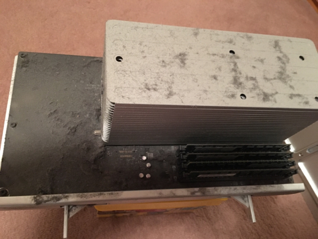

I recently bought a new to me Mac Pro 5,1 and on opening it has more fuzz in it than a 70s porno movie. I dont think it has ever been opened. I gave it a quick blast with the air compressor - from about 2 feet as I was afraid I could damage it. Getting the hoover on it bothers me because of the static but then again I'm worried too much compressed air could damage it or drive the dirt deeper in. The CPUs literally had a beard each - maybe it's the ZZ-Top model - massive tufts of fluff growing out the fans. Amazingly the temps seem reasonable although I noticed in Mac fan Control app that the Intake fan is constantly at zero and marked in red. I have to get this dust off before I try fitting more ram - I did blow off the worst of it but it could really do with a more thorough clean - any advice? or do you think maybe the dirt is now holding it together - as my buddy calls it "load bearing dirt".
As an IT person for many, many years, I have always used an air compressor with a directional nozzle to blow out dust and dirt. OUTDOORS. For heavily soiled computers I blow the air from a bit of a distance, mostly to blow it out and away. Once I can see what I am doing, I get closer and blow out in all directions the power supply, fans, and interior parts.
I never point the high pressure directly at any electronic parts for any period of time. Just clean it. I've never had any issues.
Based on my personal experience you shouldn't have any problems. Canned air does not have enough pressure to do a thorough cleaning of the whole interior. They start to freeze up and before you know it, the can won't blow anymore.

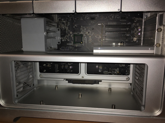

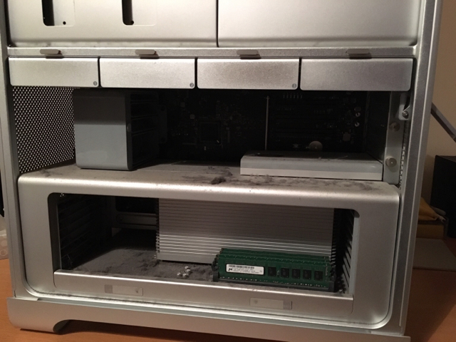

I recently bought a 4.1 and don't think it has ever been cleaned. It's from an office environment.
Used a can of air duster which removed 90% of the dust.
The boards still have a very thin layer of dust, what do you guys use to clean this off?
Some before and after photos:
A small brush might do the trick?
Reactions: MrAverigeUser
Thanks for the suggestions, Datavac looks good but pricey. I'll try the cotton buds and a brush.

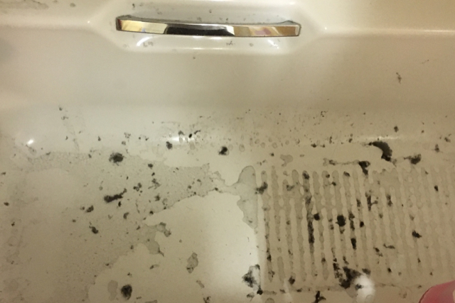

Another pic, this is what came out, bathtub was squeaky clean beforehand. I wrongly ignored advice to do this outside:
