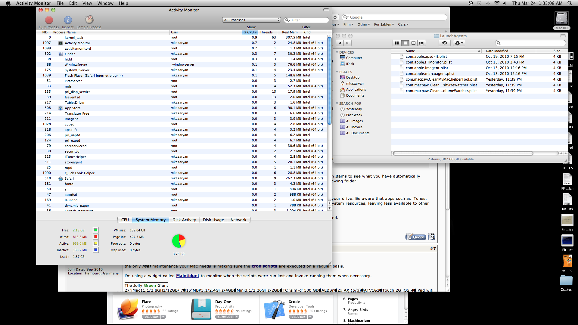

I first want to apologize for not adding a photo like I mentioned earlier. But in the photo below, I took a snap shot of my Activity monitor, at the bottom, it has the System Memory with:
Free: 2.14GB
Wired: 815.7 MB
Active: 962.2 MB
Inactive: 129.2 MB
Used: 1.86 GB
My Page Outs: 0 bytes, and Swap Used: 0 bytes.
Also, in my LaunchAgents, I have 3 CleanMyMac stuff at the bottom, with 4 com.apple. stuff, not sure what it is.
Should I delete the CleanMyMac stuff? Cause I just removed the app a few minutes ago also.
Anyway, here is the pic at the bottom, tell me if it looks good on your end.

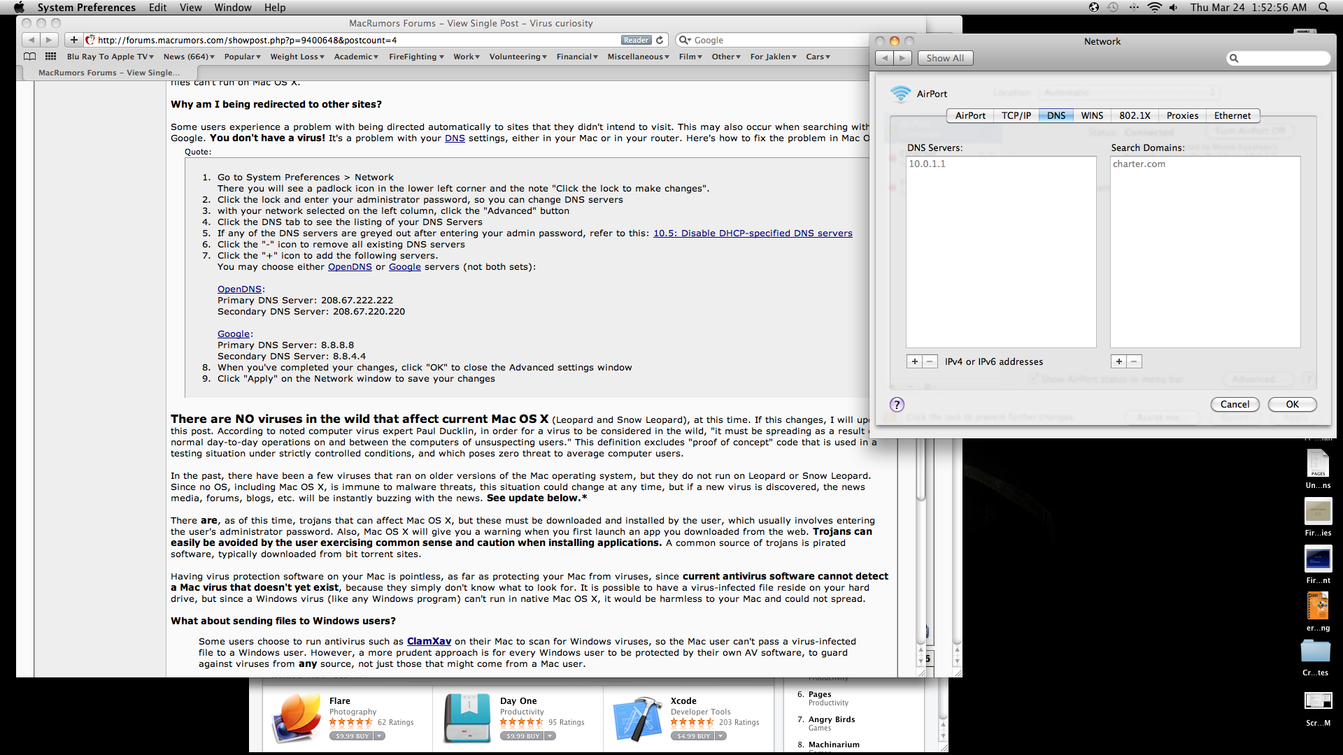

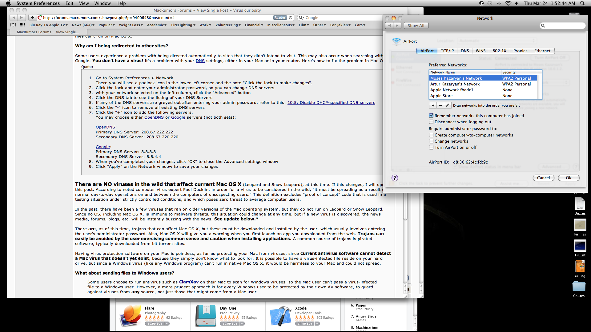

Ok, so following the steps on your Mac Virus/Malware Info thread, I have the following pics at the bottom.
Only problem is, my IP address is 10.0.1.1
And it's grayed out, as well as my domain (charter.com).
When I click the add button, it wants me to add something on top of the grayed out part. I don't know if I should be doing that or not.
Also, the link to the 10.5: Disable DHCP-specified DNS servers, I am confused when reading it.
If I do add the OpenDNS servers to my Network, will I have to add both the Primary and Secondary, or just 1 of them? And between the OpenDNS and Google servers, which one is best, and which do you recommend?
You don't have to do anything in that section if you're not having a problem with redirects. Just skip that section. Since you've already deleted what was there, just add either the OpenDNS or Google servers. It doesn't matter which you choose. Both are fine.

Also, I added the OpenDNS servers to my network, but the charter.com grayed out part remains in the domain section. Since I added both the primary and secondary OpenDNS servers to my network, now what?
You should be fine.
