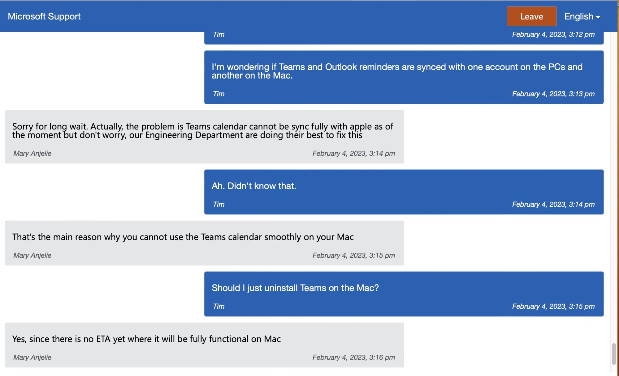

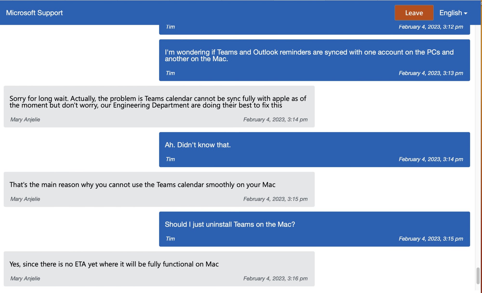

I would contact Microsoft for help, but I did that regarding a Teams problem and wound up having to fix it myself.
Thanks!
