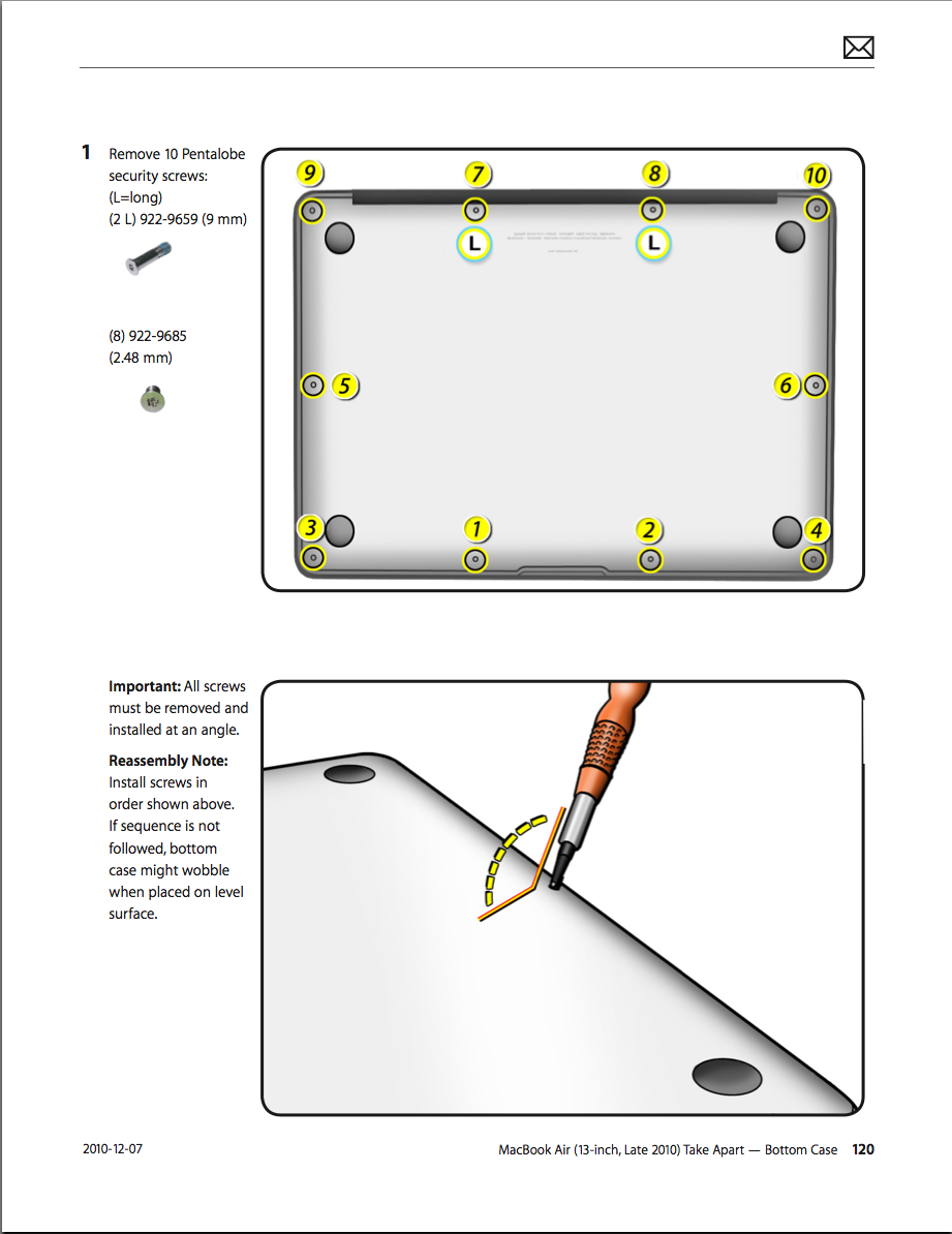

So I purchased a pentalobe screwdriver from ifixit (http://www.ifixit.com/Tools/MacBook-Air-5-Point-Pentalobe-Screwdriver/IF145-090), checked the order in which the screws should be put in (in this manual for MBA 13": https://forums.macrumors.com/attachment.php?attachmentid=282707&d=1303584661, the 11" has slightly different screwing order), and minimized the creaking sound to the point where it really does not occur 99% of the time. Just some occasional creaks, just like in any other piece of electronics.
Be careful though, the screws are easy to damage and make stuck. I had to order a set of replacement screws from eBay after I damaged some of mine and they barely turned.
