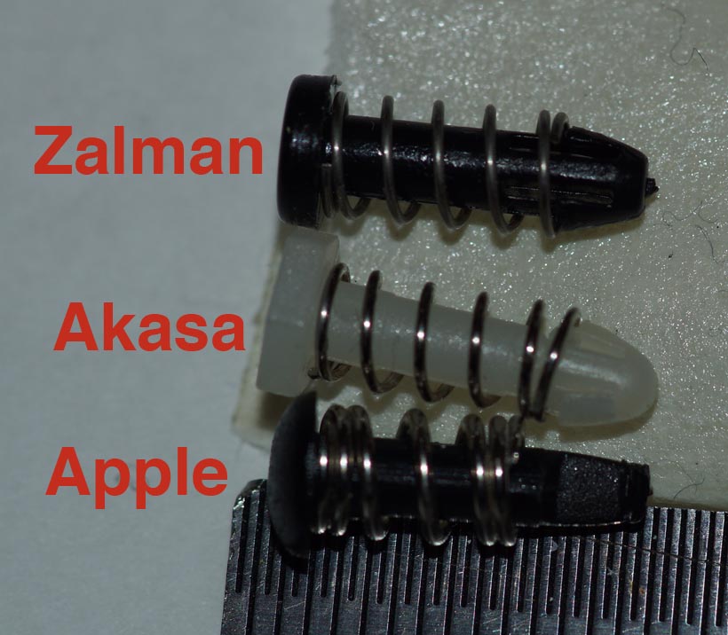

Finally got around to posting the comparison pic. The end of the original Apple rivet ended up breaking when i tried to put it back in the board to test the spring resistance (that's why it may look different).

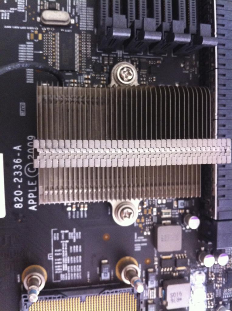

Increased IOH Heatsink temperature with PCIe SATA boards
Hi,
I have two ATTO Tech SAS H608 cards installed in my Mac Pro with eight Samsung 1TB SSD, four of each in the two CD ROM bays, and each configured as RAID 0 software raid.
http://www.attotech.com/products/product.php?scat=27&prod=9&sku=ESAS-H608-000
I noticed that the IOH and IOH heatsink temperature increases significantly (from 60C to 85C) when I add ATTO Tech SATA cards for software RAID over four SSDs, especially when in heavy use, causing system freezes and instabilities. When I increase the fan speeds (exhaust fan) the system instabilities go away.
Has anyone noticed this? Does this makes even sense.

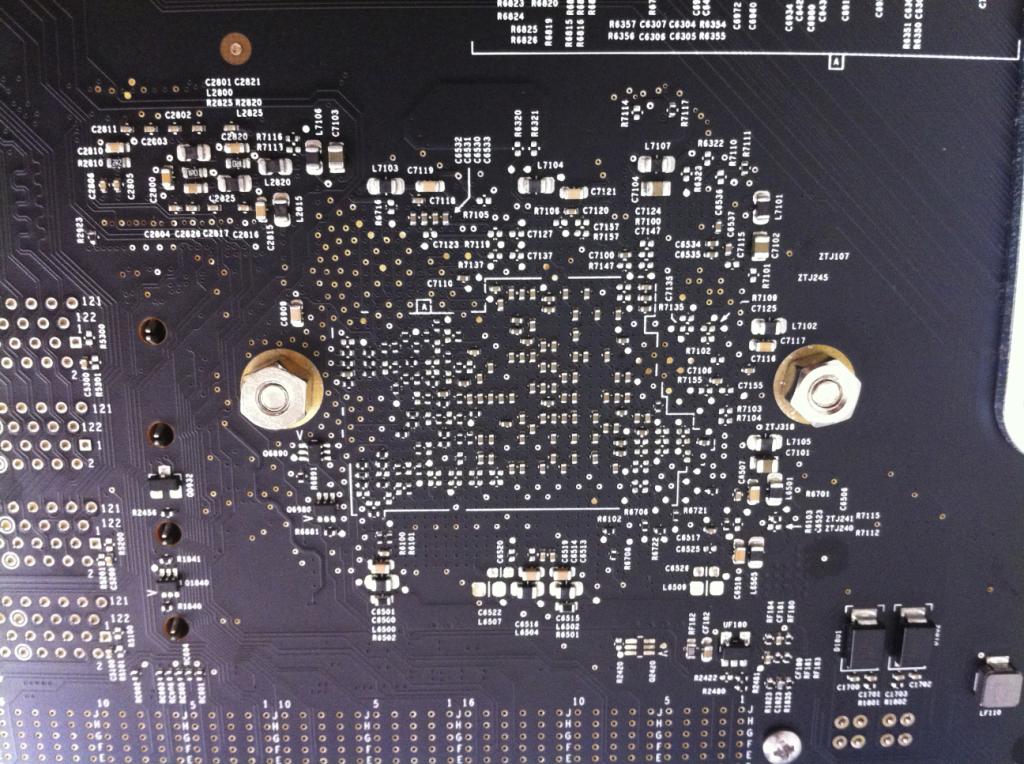

By the way, I have reseated my IOH Heatsink using simple Nylon screws and bolts on the bottom. Because they are nylon, they are sufficiently flexible to create a soft tension without too much pressure on the chip.

Mine just broke by itself 2days ago cause my machine to freeze and i notice it from i-stat that my IOH T-diode temp was stay at 128'C.
I remove 2 of the pin form an only PC mono and replace the pin and hit another problem.
My Booster B fan was spinning at Max speed and i notice i-status shoe Booster B 0RPM i guess while i remove the heatsink it might had either damage the fan sensor or broken wire. damn.. ! i've hunt for a replacement CPU-B heatsink and notice the heatsink was at USD380 at Applecomponent. :eek: Any guru might be able to help here be nice. :confused:

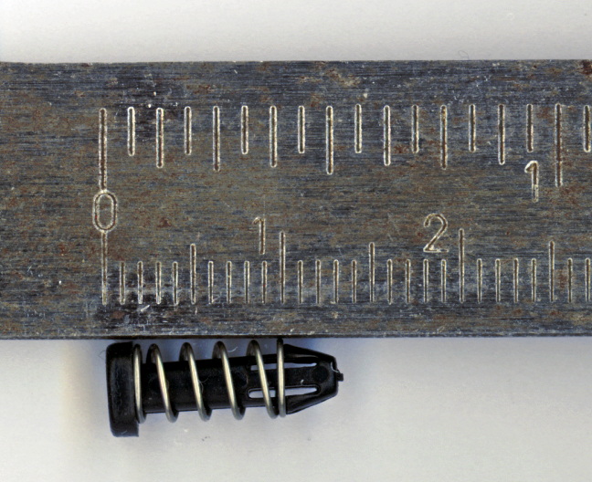

Here is a scan of the plug clips from the Zalman ZM-NBF47 cooler.
I ordered the cooler and a pack of thermal pads to hopefully be ready for
the problem if it ever happens.
I can't tell if it's right. The ruler comparisons confuse me.
So did this clip work for you?
Do you know of updated model heatsink that comes with this clip?

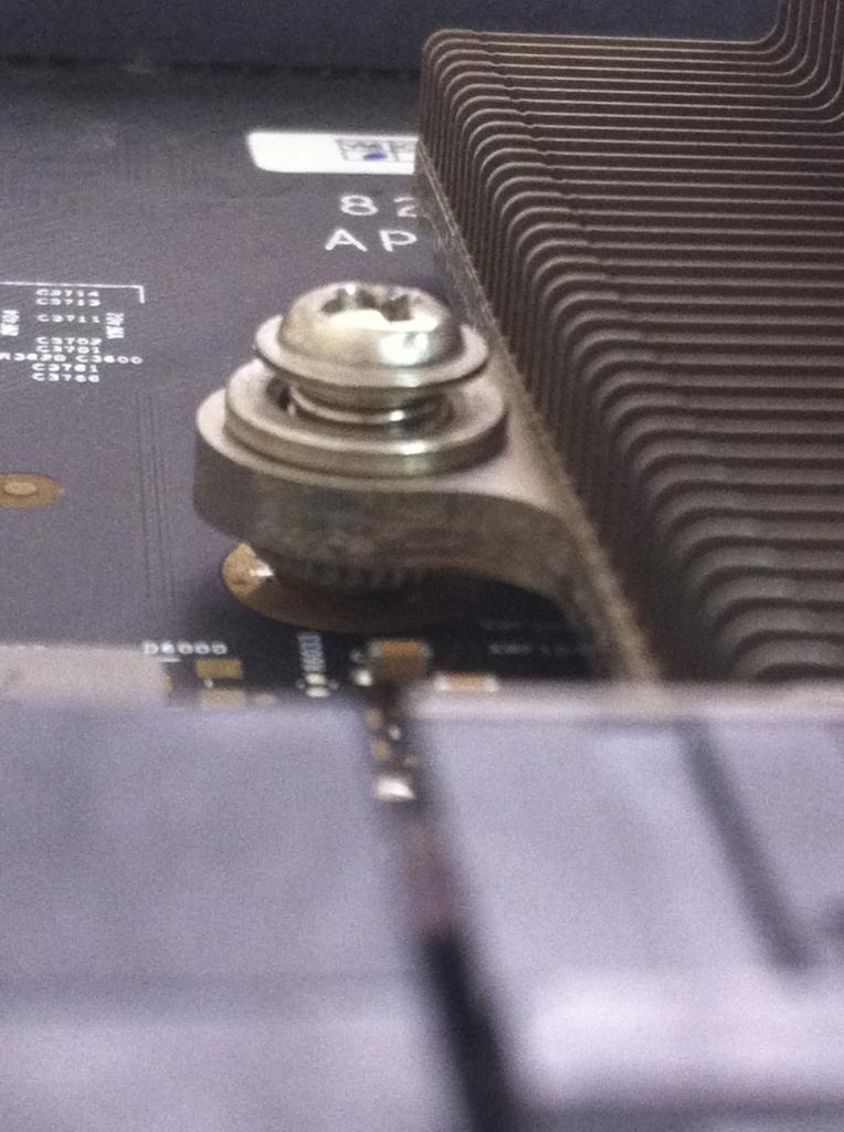

UPDATE WITH WORKING SOLUTION: (Credit to this guy for the solution: https://forums.macrumors.com/threads/mac-pro-heatsink-northbridge-rivet-loud-fan.1755982/)
Sorry that I never put out an update here! Near the end of November, I ended up ordering typical Chinese rivets from eBay (which you get by searching heat sink pins/rivets - they're opaque white-ish), since someone in another thread posted their success story with such rivets. This ended up being a huge relief, because I didn't have to go out and buy a kit just for its two little rivets; the Chinese ones worked! I'm on my 2009 Mac Pro right now, and it has been running strong - even after a 32GB upgrade where all slots are filled. Both rivets snapped in and stayed in without any problems.
NOTE: I did have to modify the rivet that sits underneath one of the CPU heat sinks. These Chinese rivets were a bit tall, so I had to take a Dremel and just shave that rivet down a bit; it was no big deal at all. Anyone with a knife or Dremel could easily do it. I started with the top of the peg itself, and then I also shaved down the cylindrical piece that's wrapped around the spring itself. I sort of, uh, circumcised it...? I guess you could say that. I simply cut around the cylindrical piece so that it would end up being equal with the new size of the peg itself. If not, the cylindrical part would have poked up past the peg itself and hindered the CPU heat sink from screwing down properly. So, remember, if you do this, to shave down the size of the peg AND the cylindrical piece that's around the spring.
Other than that, I had zero issues, and I was surprised that the springs worked, in spite of their very dissimilar shape to the Apple ones. I highly recommend going with this solution, as my temps and such are all back to normal, and the machine (obviously) works fine again. Just put new thermal paste on everything before you put it all back together (I did my CPUs too), and you're good to go! I believe I used my leftover Gelid thermal paste. Get high-end. Do NOT cheap out. In total, I spent about $10 fixing the machine (bought some Arctic but didn't need it in the end). That's cheap to begin with.

I bought these rivets and mine were way too big.
I ended up using rivets from an old motherboard heatsink, so far it has been running this way for several months.
You bought the Chinese rivets? Hmm... maybe I should link the seller from whom mine were purchased, as mine fit just fine. Perhaps yours happened to be a larger size, in which case I'll be looking at my purchase history and seeing if the size was noted in the description.
Good of you to tell me, because this means that other sizes are floating around out there and could perhaps render my instructions useless to those who get the incorrect rivets.
Do you happen to know the length and dimensions of the bolt you used?

I'd suggest new plastic snap rivets over anything else. Chinese seller shave them on eBay. I'll measure one later so I can give exactly dimensions. These worked fine in my Mac Pro. The only thing I had to do was shave the top nub off one of them so that it would fit underneath that part of one of the CPU heatsinks which covers half of the Northbridge heatsink, on my dual-socket 4,1.
EDIT: the eBay link above shows the correct rivets. They really work. Shaving the nub off one isn't a big deal either; use a power tool or an Xacto knife. Also make sure to cut off the cylindrical piece that surrounds the spring. Once the spring is depressed, that housing will be pushed upwards and surpass the height of the nub. You don't want that, because that defeats the purpose of having shaved the nub down. At least, from what I can tell, I needed to do that. Or, perhaps, it was just precautionary step. I didn't ever check to see if the housing would actually surpass the nub's shorter height.
