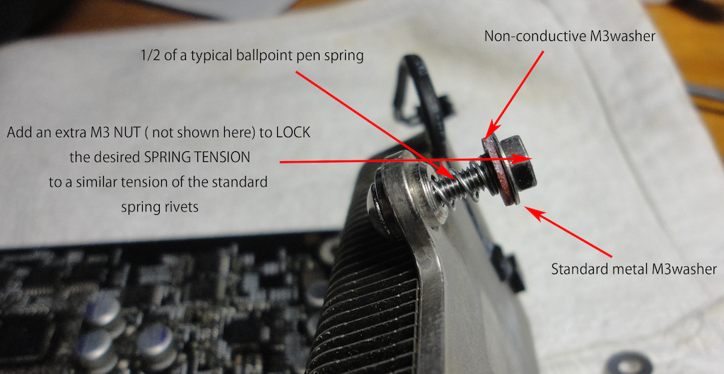

Nut & bolt solution.
From the Northbridgetop . .
1. M3 bolt ( from memory length 20mm ).
2. 1/2 of a ballpoint pen spring.
Northbridge heatsink top
Northbridge heatsink bottom
3. Non-conductive M3 washer
4. M3 Metal washer
5. M3 nut
6. M3 nut = to lock the upper M3 nut at about the same tension that the spring
of a plastic rivet would normally be set at.
( gently pull one of the OK rivets to get a 'feel' for it.

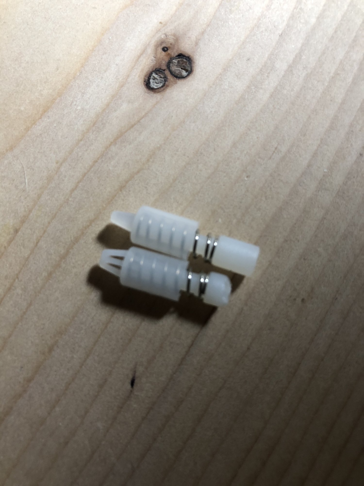

I used the plastic rivets to upgrade some dual trays. The size is different so the white plastic rivets obstruct the heat sink. You have to drill a hole in the bottom of the CPUA (BOOSTA) fan so you're not putting pressure on top of the plastic screw. What I do is put a touch of paint on the screw head and lower the heatsink so the paint marks where the hole should be drilled.
Ouch, easier than drilling the heatsink, just clip off the top of the plastic spring rivet!
Didn't drill the heatsink. Just through the plastic on the bottom of the fan. I thought about clipping the head but don't want to disturb the heatsink as it messes up the thermal paste.
With diagonal cutter or scissors, clip the top of the sliding part of the rivet. Simple. Effective.
That's what I did with perfect results.
Thank you for the suggestion. Good to know we have options. Maybe I will try it on one of the other trays I have to do.

Trimming the top of the plastic screw with cable snips is best. I suggest trimming the head before you mount the heatsink to the circuit board. It's difficult to snip the head after it's been mounted without shifting the Northbridge.
Don't drill a hole in fan bottom like I said earlier as the screw hits the fan blade. The thermal paste will likely be baked on so you can use a plastic scraper to remove it. Here's a link: https://www.ifixit.com/Guide/Mac+Pro+Single+CPU+Northbridge+Heatsink+Repair/125875

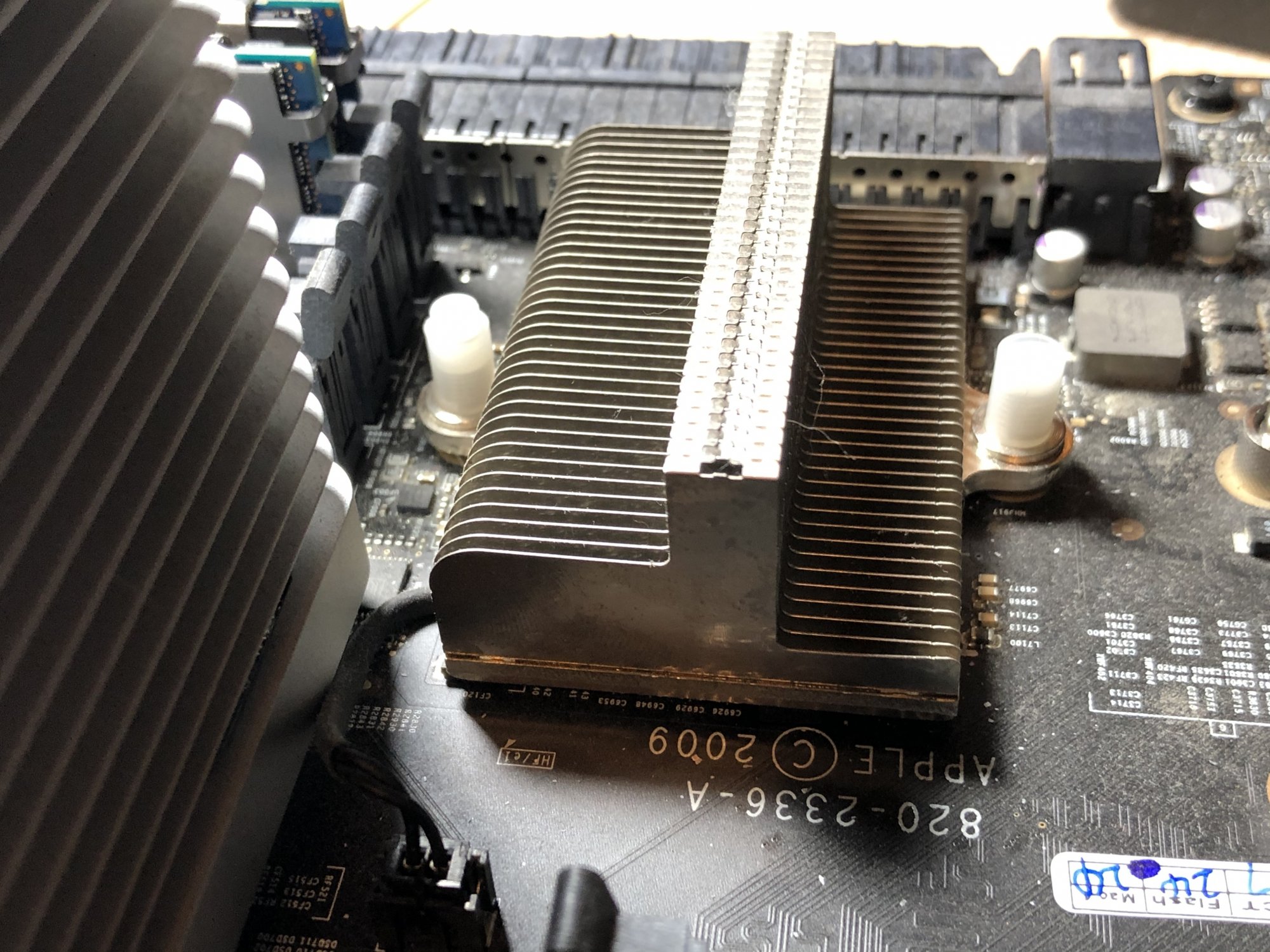

Using these heatsink clips works perfectly! I used snips to trim the top off one of the clips.
