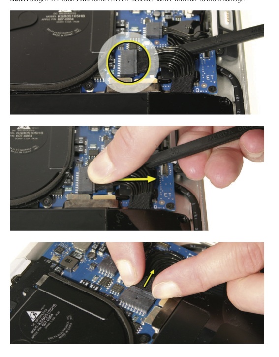

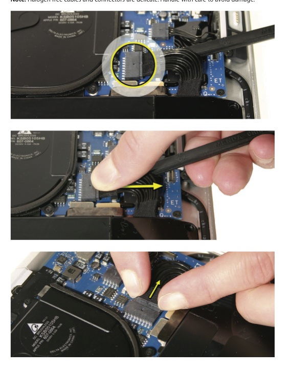

Could be very simple fix if that battery. I have never seen the battery on the MBA, but it has to be there. Would assume it is just slightly loose or just not making connection. I have replaced them on Dell laptops, and they are essentially a watch battery. Would definitely check iFixit.com to see if they show it in their photos of the MBA. Maybe they even have it for sale. But if you have AppleCare, just use that, should be a very simple fix.
Best wishes with it.
Here a picture for you scottsdale from a service manual.
