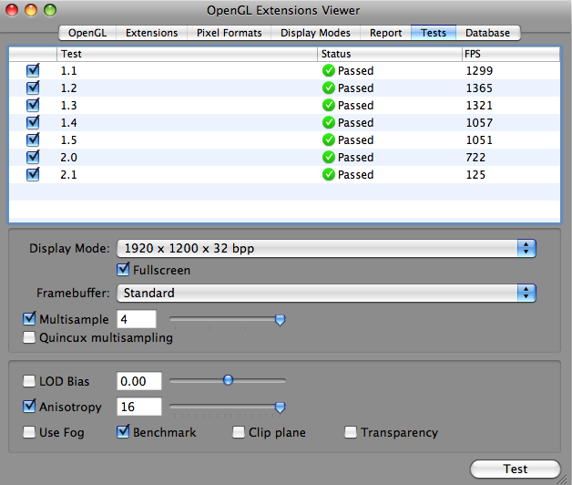

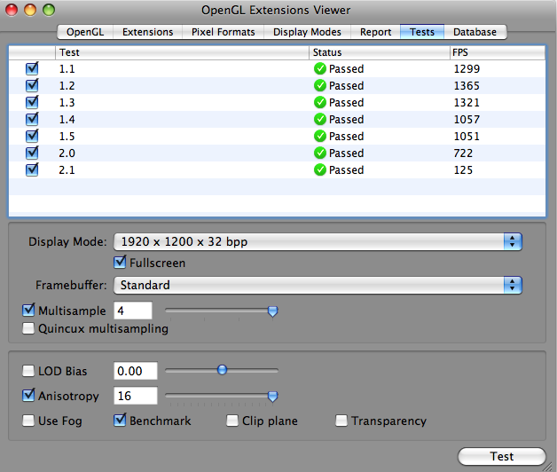

I have been running the OpenGL Extensions viewer benchmark and also some CUDA timing examples. The first time I ran OpenGL I got rubbish results, then the card seemed to speed up and was much better. Similarly I ran the CUDA deviceQuery, and also the MonteCarlomultiGPU code and got two wildly differing numbers.

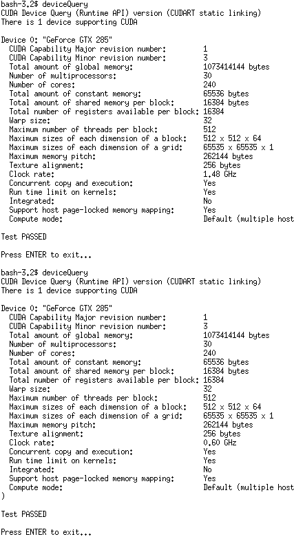

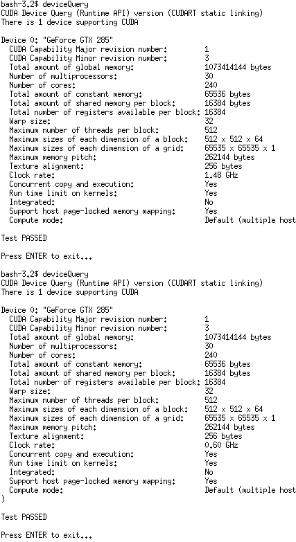

For example, deviceQuery reports a clock rate of EITHER 0.6GHz OR 1.48Ghz, and the "options per second" reported by the MonteCarlo code differs by a factor of 10 (TEN!!!)
Sorry if I am being dumb - but do we know if there is a sleep mode and how to keep the card awake. Screen dump below illustrates the issue. I ran the top code after hammering the card with OpenGL benchmark, then waited and ran the next one. Note the change from 1.48Ghz to 0.6GHz. The OpenGL scores are pretty good in awake mode.

The only other thing I have found out is that the clock has at least three states, 1.48Ghz, 0.8GHz and 0.6GHz. I ran the Cuda deviceQuery several times in succession after some heavy graphics and observed it winding down through these levels. There are some posts on similar matters on EVGA and CUDA forums so I am going to wait now to see if there is a mod for thresholding on the power.

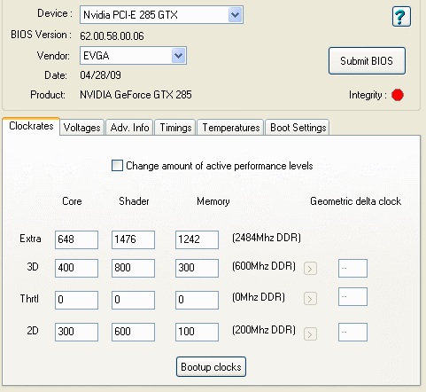

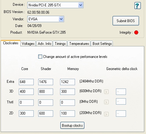

OK - so netkas suggestion reveals the issue. The shader clock and memory have three speed states. See screen dump below - exactly the clock states revealed by CUDA, but also the memory speed drops right down, which explains the factors of 10 in some perf. Now - how do I get it going faster - fewer states? Or will this fry my card? (And how is anyone supposed to manage any of this without a handy bootcamp partition...)
Further comment - my Palit 285 has similar settings - so it is the transition between them that is problem - that card tends to stay at 1476.

if u dont care about power cosumption, then dump whole rom with nvflash , edit clocks wit nibitor, and flash the card, also share rom if not mind 🙂
Yes, if you edit the Bios side for the Rom, with all PStated(PerfTables) to values you want, and flash it back, we'll know if the Mac card gets its PStates from the Bois side of the Rom under OS X.
I'm thinking that it won't work, bet you a $1 PStates are defined in the EFI Side.( I'd be happy to be wrong. )
Post a Dump of the ROM, and we can look and see what it holds.
For me, with a 8400m gs, OS X read the PerfTables in the PC Bios and sets them on the fly( POWER Mizer )
It was trouble before 10.5.6, after that it works great.
if u dont care about power cosumption, then dump whole rom with nvflash , edit clocks wit nibitor, and flash the card...
I could edit the clocks as you say, but what about the point that my PC card has the same three states, as I discovered a bit later, but that card is running at 1476 all the time and never seems to throttle down. Is there a cooling issue and might I fry the card or even the Mac? I took out the Palit PC 285 to give more room for the air to circulate and the Mac 285 is still down at 0.6GHz. I'd just like to get views on this before I fiddle with the heat state!
