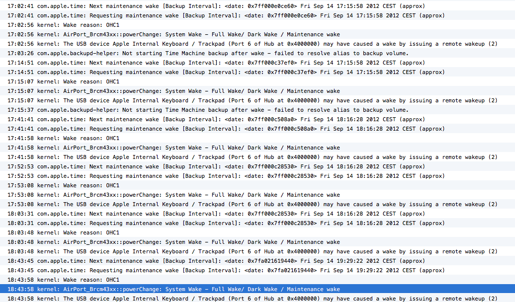

Here's a screenshot of my console:
Seems like it is the keyboard
Ok. So i've tested every key and none of them have done it. Is there anything else that it could be?
