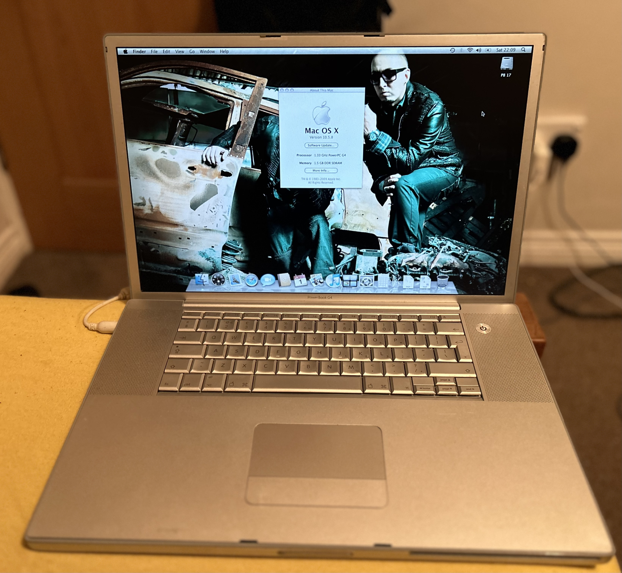

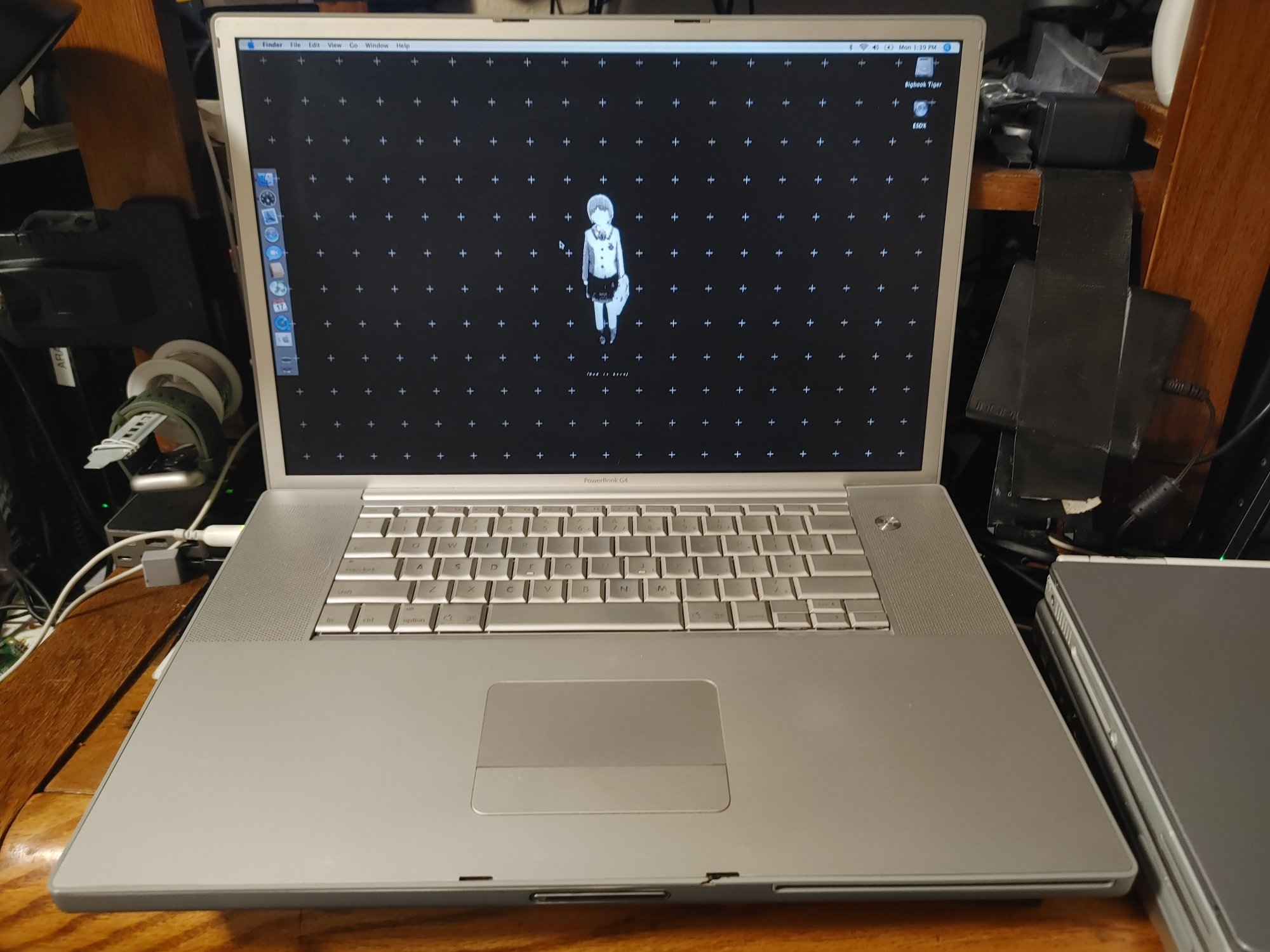

Today I got my Powerbook G4 17 inch that I won cheap in an auction. It has a bit of a dodgy opening latch, and right click, but apart from that, it's in pretty good condition. I do plan on changing the HDD to an SSD, bumping the RAM to 2GB at some point, and cleaning it up a bit more.
Here are the general stats/look and feel of the machine:

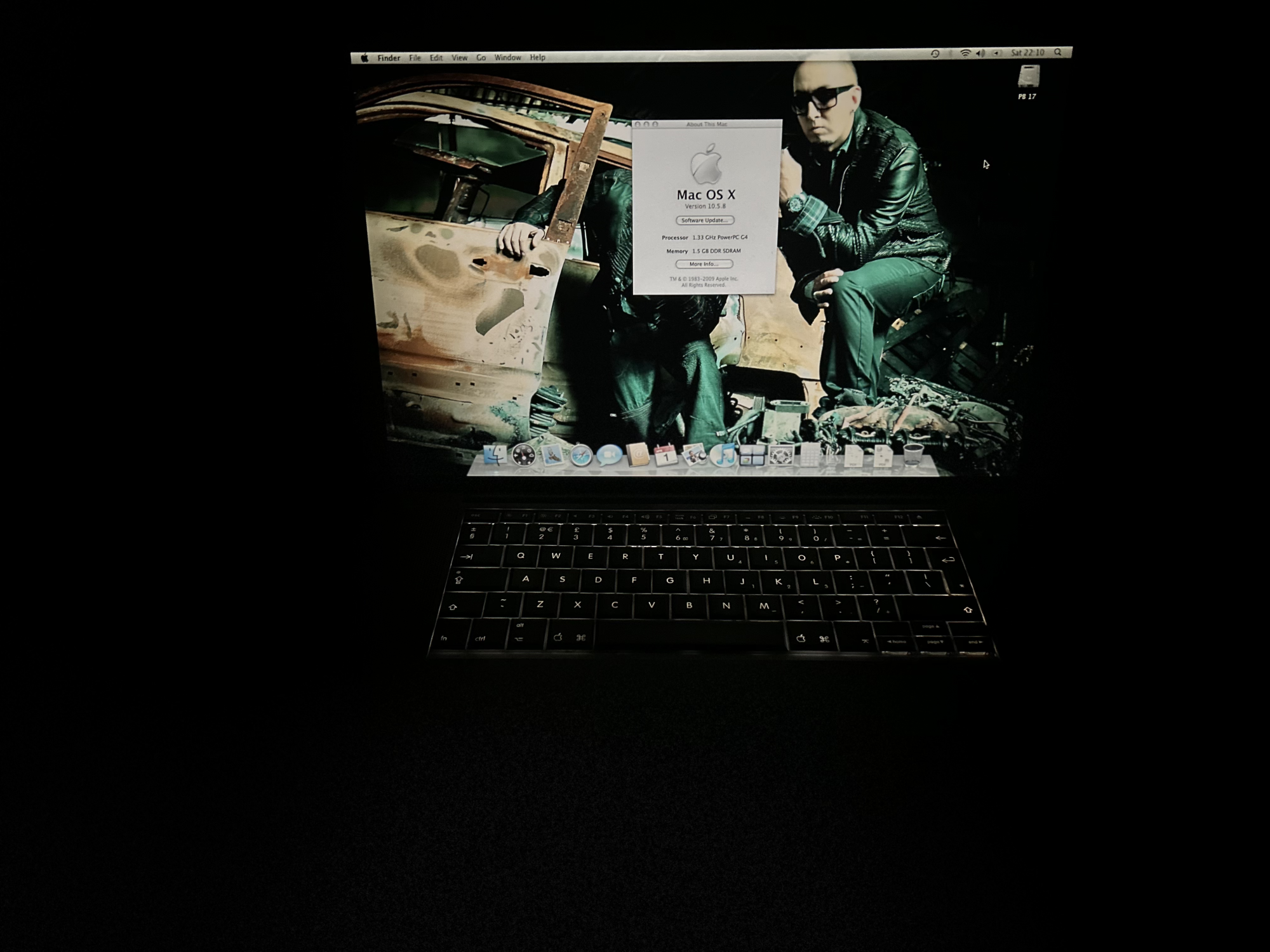

The "cool" thing about this Powerbook G4 is that it's a 1.33 GHz logic board transported into the body of a 1.67 GHz model, so that means it gets a light-up keyboard.

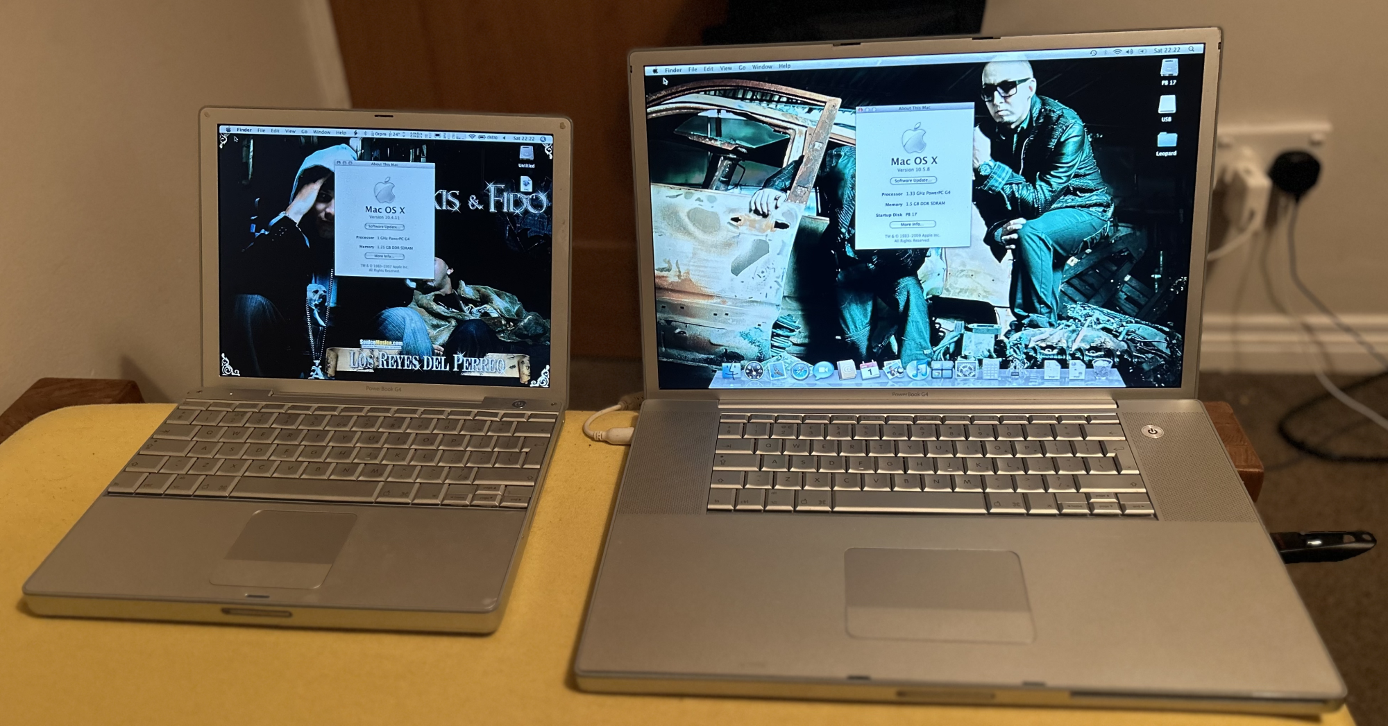

Here it is with my 12 inch PB running Tiger:

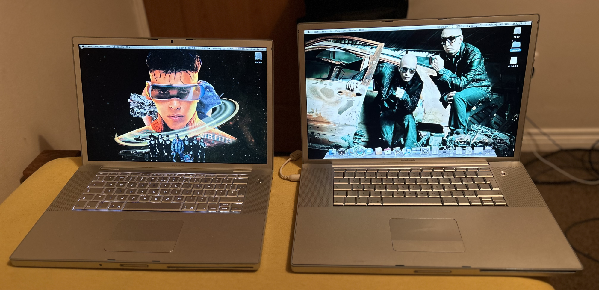

And with my 15-inch MBP '07 running Mavericks:

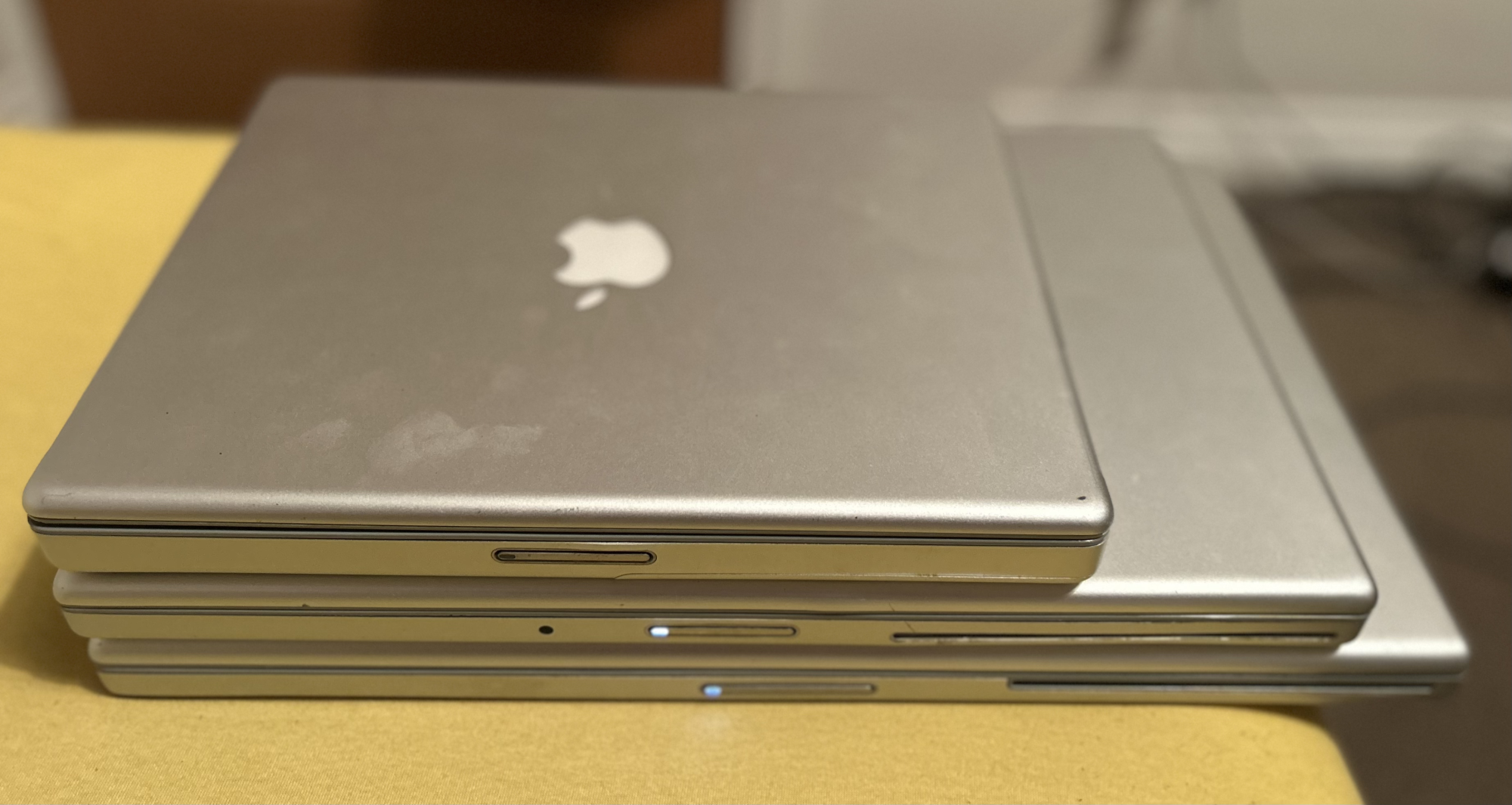

Here is the size comparison between them all (it came out as portrait mode for some reason):
If it is a 1.33GHz board it will come with ADB based connectors for touchpad and KBD meaning that those would also come from an older PB.
-> no "2 finger" trackpad (those were USB only found in PB5.6-59 and the very last iBooks/12" PB)
It is entirely possible to use the case from a low-res 1.67 model whilst transporting logic board and topcase assembly from an earlier unit, so as to keep the ADB functionality intact across the transplant. The side cut-outs for the ports between the two model series variants are one-for-one, as are the mount points for screws.
Sure, been there, done that... the other way round... transplanted a dented 5.7 with broken screen into a 5.5 case.
Also, according to everymac the "ambient light sensor keyboard" was introduced with the 5.3 (1.33GHz) PowerBook making it even more obvious that these parts did not come from a 5.7 or 5.9.
It did say on the listing that it was a logic board transplant, and I had a look at the specs under the battery and it said 1.67 GHz was the original model that the body came from. 1.67/512/80. Seems like it was once a low-res 1.67.
But I didn't know that the 1.33 GHz also had light-up keyboards, though. But yeah, no two finger scrolling. Just appears to have the body transplanted but the internals of the 1.33 GHz, not that I'm complaining.
The 17-inch PowerBook, from its inception, brought backlit keyboards to Macs. Not even the base model 15-inch aluminium variant in 2003 has that (the higher-end variant, however, did, but even so, the 17-inch line got the backlit keyboard tech many months earlier).
