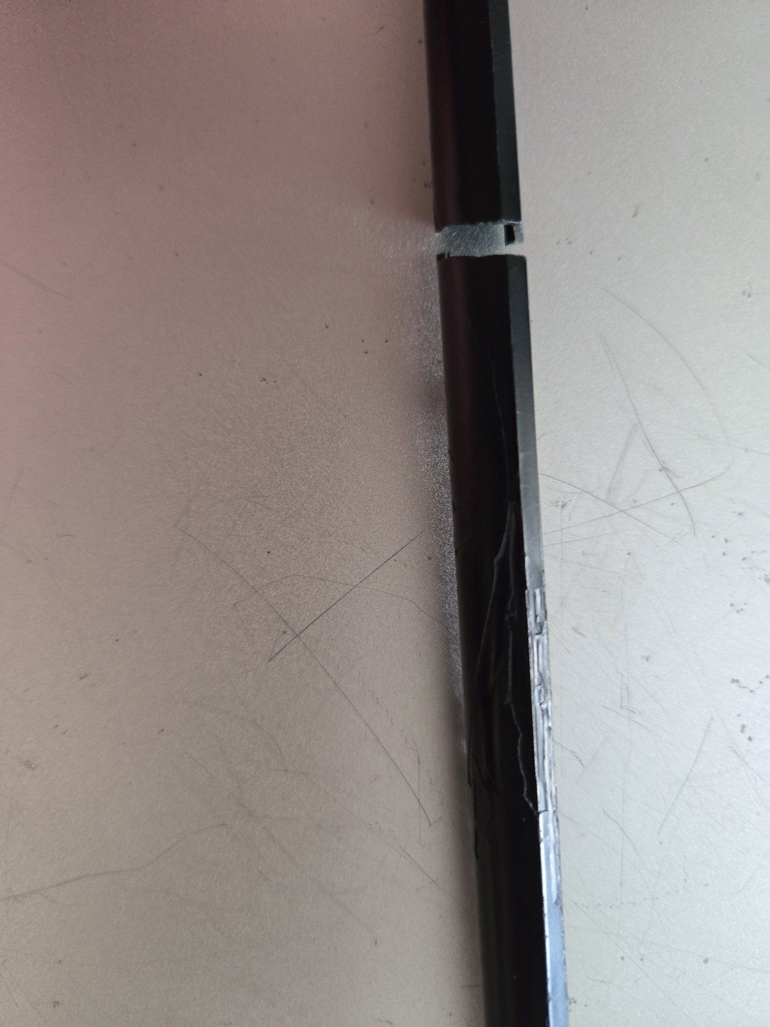

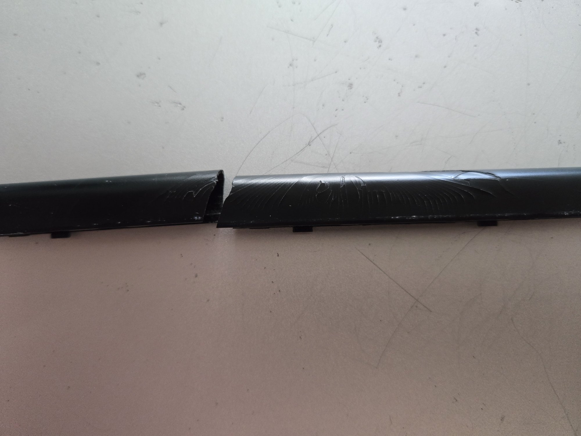

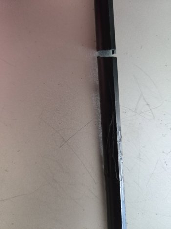

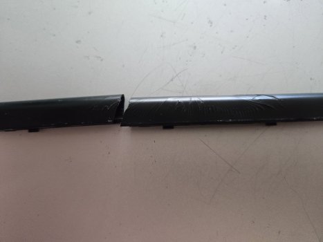

Hi just casually commenting on this 12 years later. Just thought I would mention to anyone else who happens to find this thread that yes this is an issue and it's such an issue that my clutch cover entirely cracked in half from to much heat
