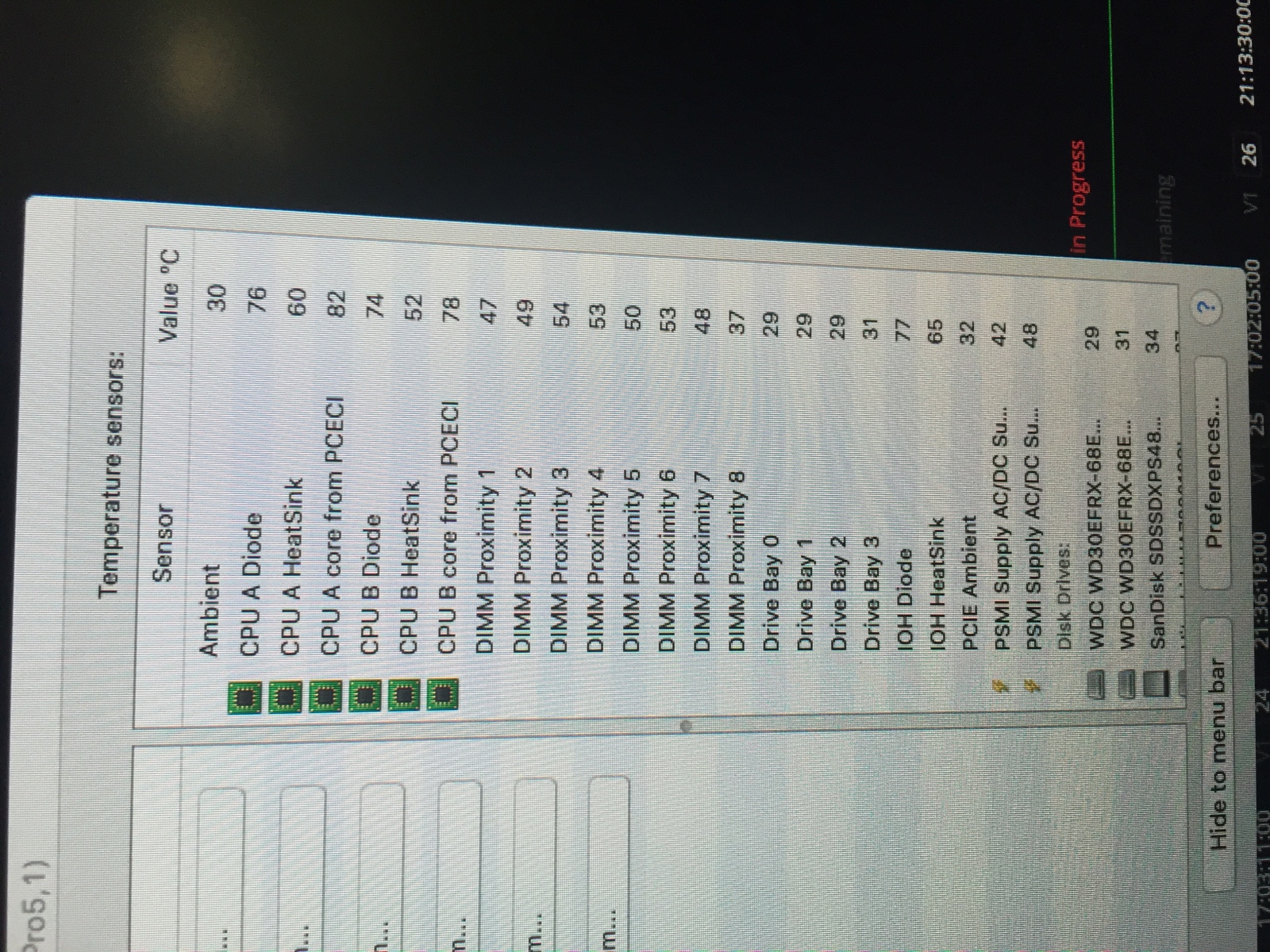

[doublepost=1469076592][/doublepost]
Moment of freeze before restart

Furmark has the card at max according to the graphs, resolve shows about a third of that. I still think the cpu is the culprit. I think you are right that I am not getting a fast enough refresh to see what temp it hits before shutdown. It jumps up and AND down during render 10 to 20c, so if the last refresh I saw was 76c, it could very well have went over 90c.

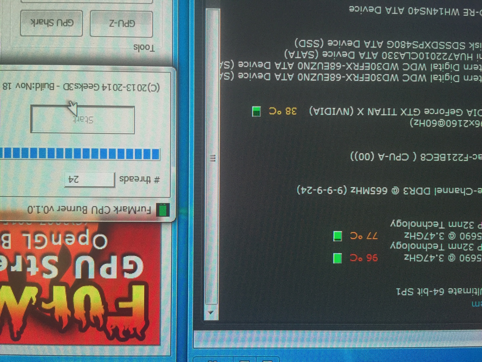

Furmark on Windows has a CPU stress test as well, and sure enough it caused a crash. Strange how geek bench did not.
First try with furmark CPU burner caused crash at 84c.
Second test caused CPU A to climb up to 96c and CPU B to 77c before I stopped it.
[doublepost=1469131354][/doublepost]
sorry pic maybe upside down on your browser... :/
