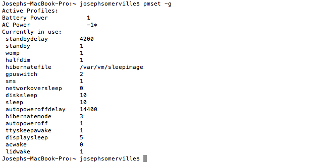

Can you guys take a pic of your full PMSET -G (with AC on an another with Battery only) and post it here so I can see your settings?
I do have an SSD for booting my OSs.
can you guys take a pic of your full pmset -g (with ac on an another with battery only) and post it here so i can see your settings?
I do have an ssd for booting my oss.
Battery:
AC Power:
Thank you all, guys.
All good now.
Hibernating 30 mins after sleeping, no matter if it was the lid or idle.
Also it idle sleeps fine after 10 minutes even if I uncheck the "put drives to sleep as soon as possible" option.
So great to simply close the lid before going to bed, not having to worry about losing work, charging etc, and waking up with just 1% less battery on the next morning 🙂
