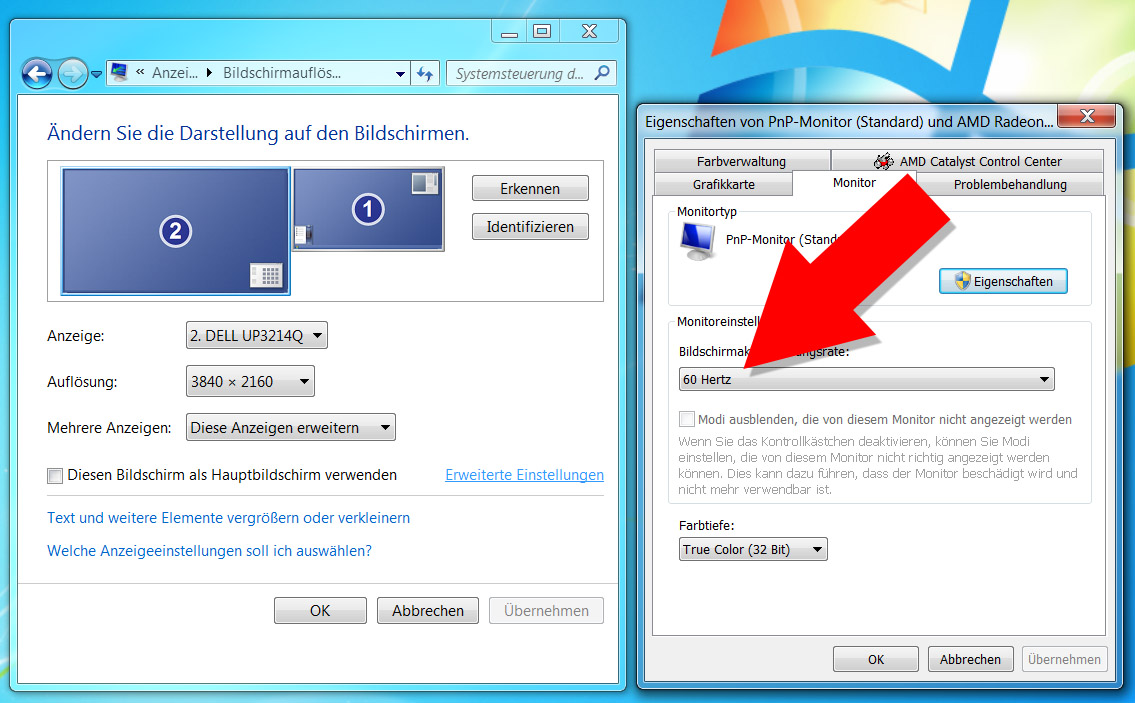

Hi Jon,
first of all I have to apologize!
You were right, I was WRONG…
When I got 60 Hz with the UP3214Q I was using my nMP, not the cMO :O/
With the nMP it’s of course no problem to use both my 3214Q (UHD) as well as the LG 31MU97 (4K) with 60 Hz (in order to get 60 Hz instead of 50 Hz with the LG 10.10.3 is necessary).
As 60 Hz are no problem with the D500 (which as far as I know is even less powerful than our R9 280X) the problem must be software based (as usual…) – which I confirmed when I used Bootcamp / Windows 7 on the cMP + R9 and was able to use the Dell with 3840x2160 @ 60 Hz right away…
Please let me know if you find out anything new – of course I would prefer 60 Hz on the cMP/R9 with OS X as well.
Regards
Thorsten / MacMutsch
