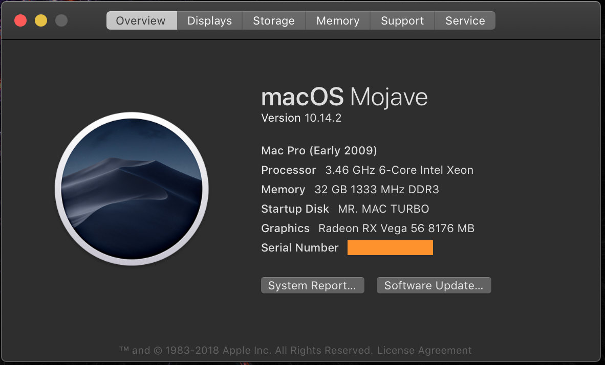

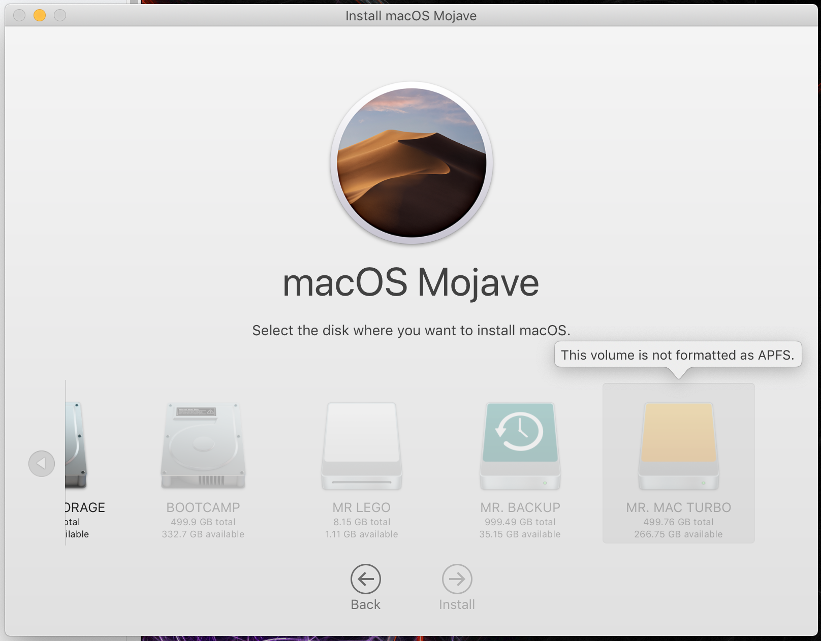

My cMP is currently running 10.14.2 and wont let me install 10.14.5.
I'm also running Boot ROM 144.0.0.0.0. and my primary drive is PCIe NVME Samsung SSD.
Did I miss something and Mojave changed its requirements after 10.14.2? Do I need to reformat my drive or something? It seems strange that I cannot install an update for an OS I am currently using.
Perhaps you partitioned your Mojave drive in an unsupported way? Your EFI partition could be broke too.
The easiest way to solve this is to copy all your data, fully erase the drive and then do a clean install.
