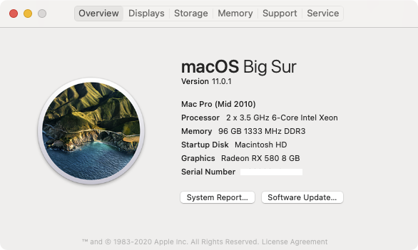

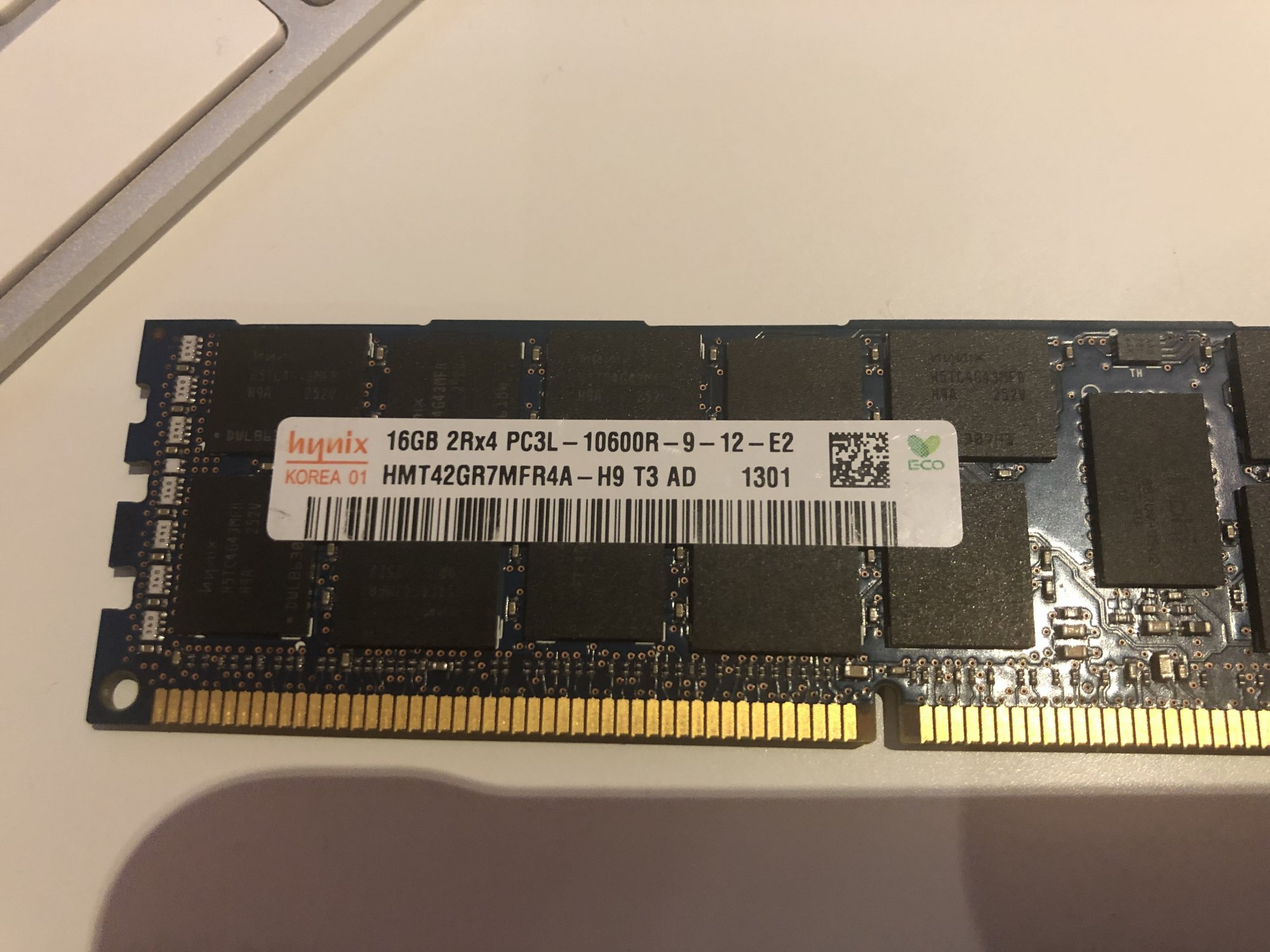

Any PC3L-10600R DDR3-1333MHz 2Rx4 server memory will work, search eBay to get great prices. This is what I use in my Mac (6 sticks):
BTW, your Mac will operate slightly faster if you use 6 sticks, instead of 8.
Any PC3L-10600R DDR3-1333MHz server memory will work, search eBay to get great prices. This is what I use in my Mac (6 sticks):

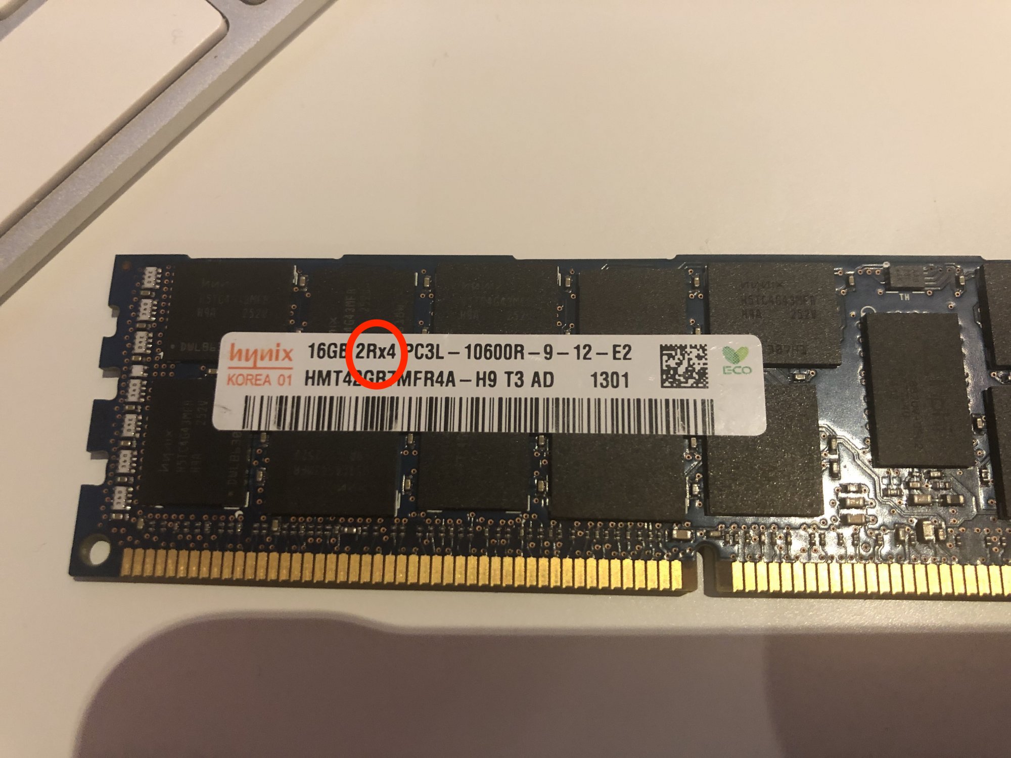

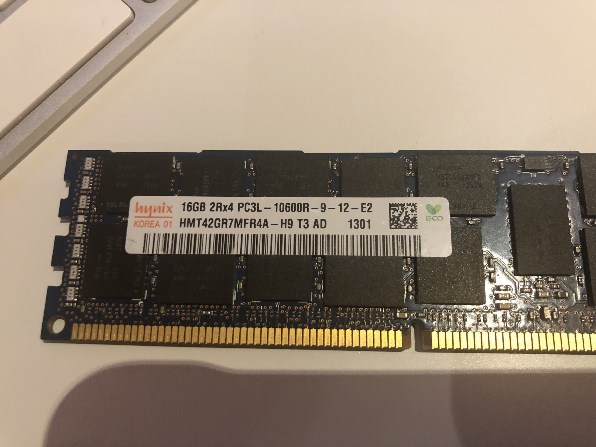

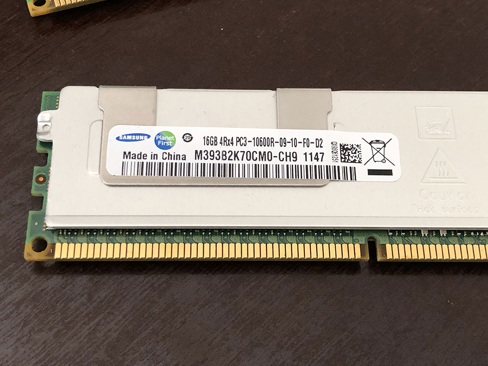

Sorry, but you are mistaken, no Quad Rank (4Rxyy) memory works at 1333MHz, when it works, works at 800MHz.
Memory for Mac Pros early-2009 to mid-2012 needs to be Dual Rank, the 2Rx4 on your photo:
There are other limitations like the number of RAM chips on the board and other more complicated things, that's why we usually only recommend part numbers that are tested and known to work fine.
Yes, I updated the reply after I realized I missed the 2Rx4 part. :)

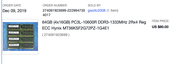

I find the OWC memory quite expensive. For example, I purchased the Hynix 128GB (8x16GB) for $160USD, from an eBay seller. Hynix and Samsung are the best brands used into production servers.
I had this here working nicely at 1066MHz.
They only dropped to 800 when all 4 slots of one CPU had been used.
And due to the lower latency (7 istead of 9) at 1066 they even produced slightly better results with Geekbench's memory test, compared to 2R-modules. Logically there could be better performance expected for big transfers with 2R/1333MHz and for random access with 4R/1066MHz. But none of this should be actually noticeable in real world scenarios.

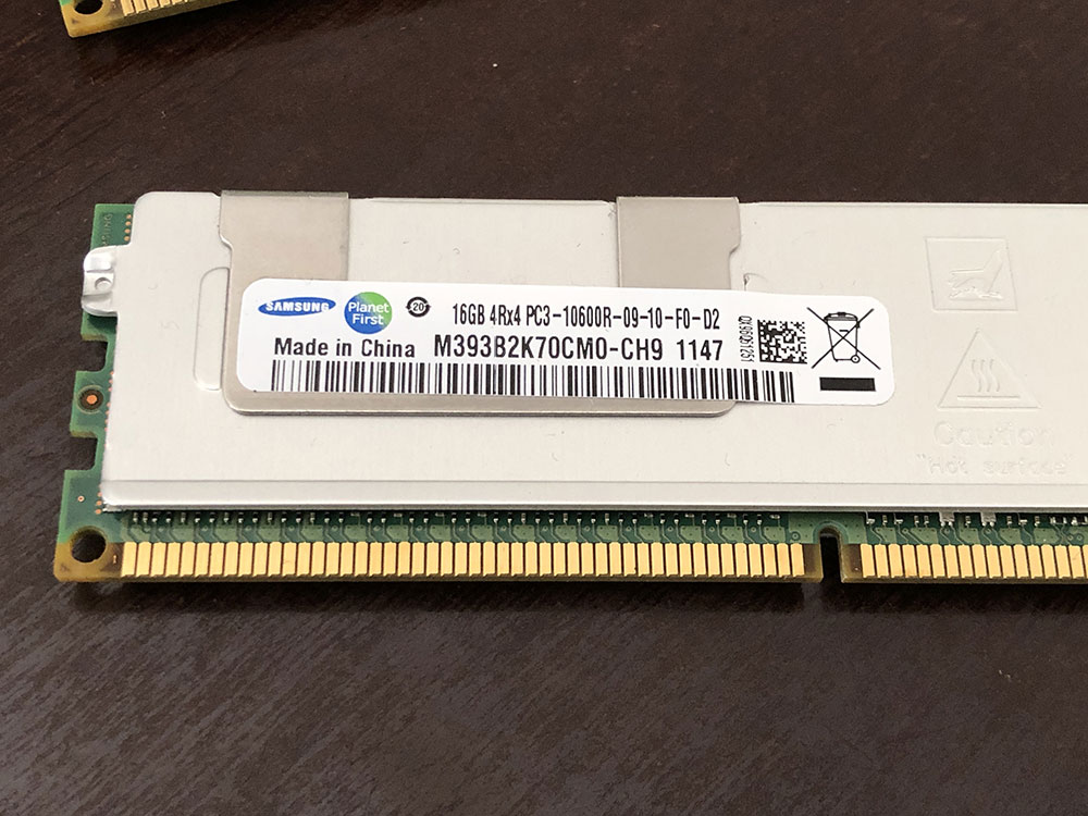

You got lucky there, some quad rank RAM works at 1066MHz, if you don't use the fourth slot. The real problem is that a lot, if not most, quad rank DIMMs don't even get recognised because of the quantity of memory chips on board.
I've been burned so much times with sellers sending quad rank DIMMs that I read all the pertinent documentation for the Tylersburg platform to understand the intricacies of the memory controller, it's so much complicated to get a working config with quad rank that it's not worth to try.
Reactions: pullman

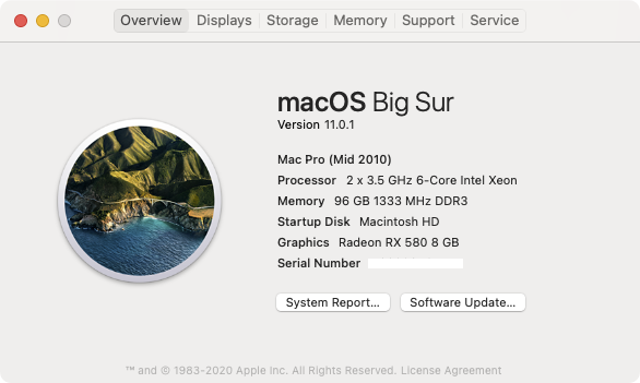

@niallcook If you can find a good deal and plan to continue using your Mac for a while like I do, buy 6x16GB PC3L-10600R DDR3-1333MHz 2Rx4. I’m using OpenCore to make my Mac supported. 6 sticks will perform better than 8.
You got lucky there, some quad rank RAM works at 1066MHz,...
Sure i was. And i didn't try this on purpose. I ordered from a Chinese seller on ebay unaware of the whole rank-thing. But i got six absolute identical sticks like the one in the picture and they all work fine @ 1066.
But as they are somehow affordable, i ordered another six. 2R this time...
...low profile, running @ 1333, and did a lot of comparing from minimum (one stick) to maximum (six stick) configurations. Results, memory score in Geekbench as well as overall performance in Cinebench, were in a very narrow range but more often showing some small advantage for the configurations running @ 1066. Not enough to bas some recommendations on. But no one who, like me, "accidently" got working quad-rank-modules, ore has the memory running @ 1066 for other reasons should worry too much about lacking performance.
