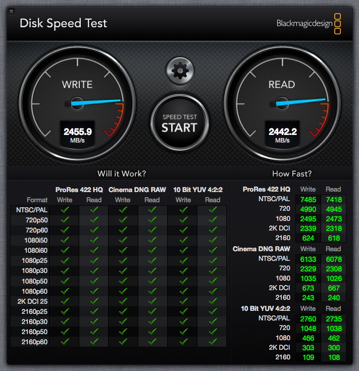

I'm running an Amfeltec PCIe board with (4) SM951 512GB AHCI SSD's. It's quite fast and the SM951's are bootable with both macOS & Windows. I like to keep my macOS and Windows 10 on separate volumes. So, I have one 512GB blade with High Sierra and one 512GB blade with Win 10 pro. Both work very well and very fast. I even played around with RAIDing two blades (raid 0) and installed and ran some tests in macOS. Apple RAID won't work for windows though. In fact the raid volume won't even be visible in Windows.
Anyway, here's a Blackmagic test for a single 512GB blade....

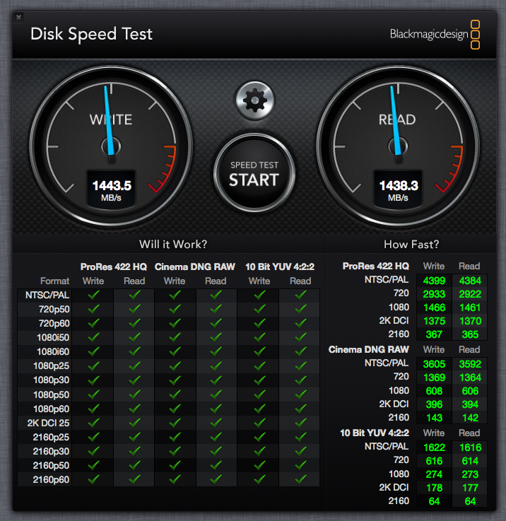

And here's two blades in RAID 0 ( 1TB+ )....
