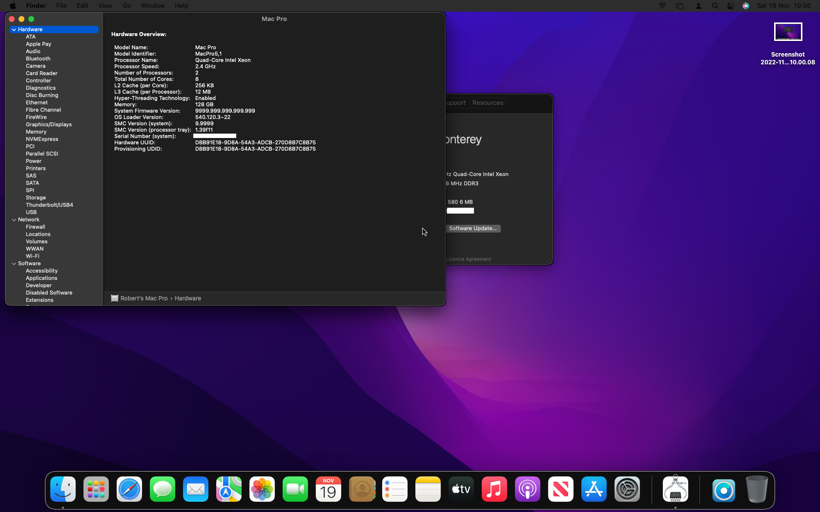

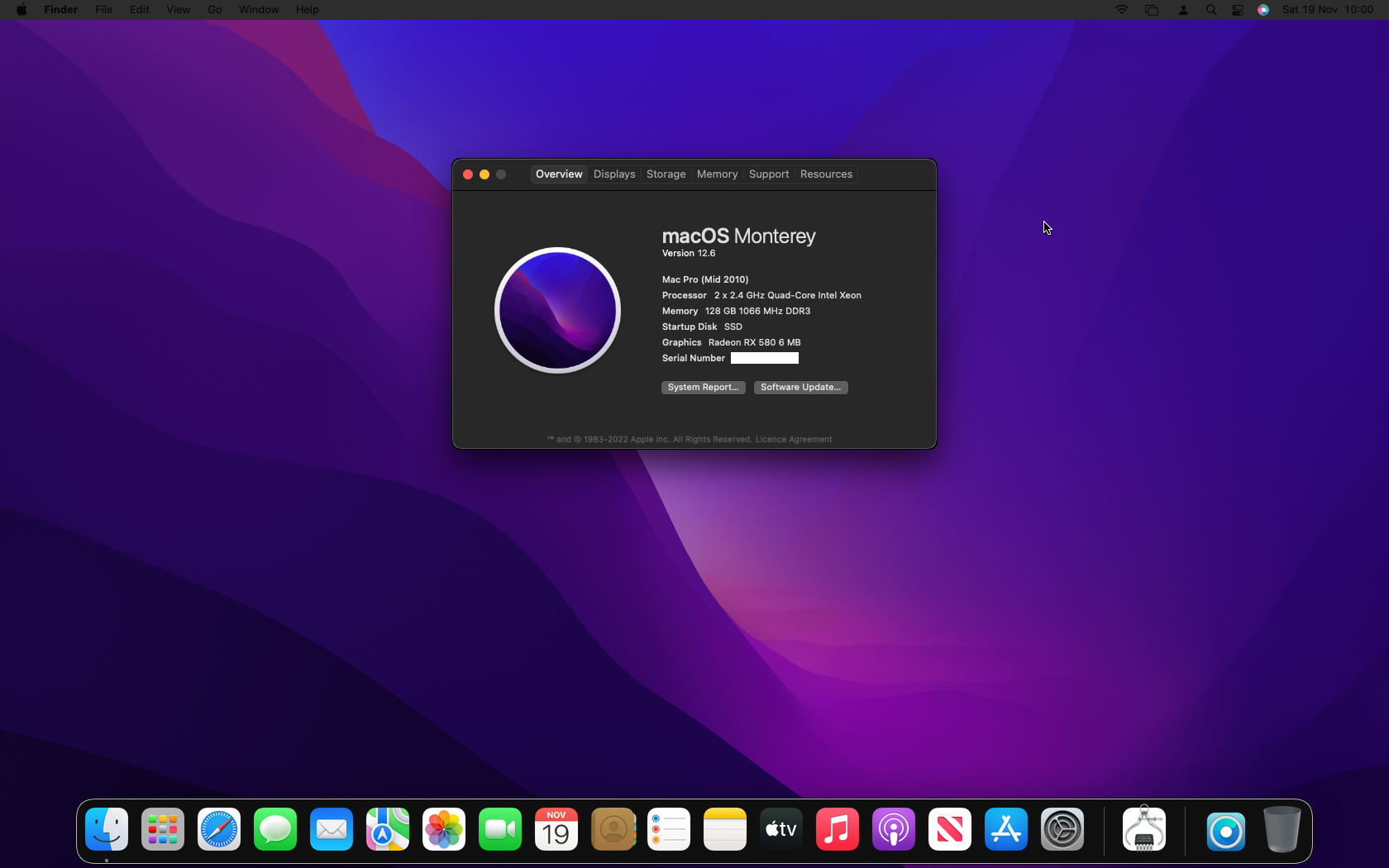

I am trying to get macOS Monterey on cMP 5.1 with open core but I have issue with GPU (Sapphire Radeon Pulse RX 580 8GB)
1. macOS 12.1 - installed but GPU issue
2. macOS12.6.1 - can't install - all time stock on Apple logo
3. macOS 12.6 - installed but again GPU issue
GPU issue - shows 6MB instead of 8GB and everything is too slow (see attached pictures) - also working only one screen (HDMI output) and show interesting System Firmware number 😀 (original is 144.0.0.0.0)
So what I am doing wrong ? Thanks a lot for any advice/ideas 🙂

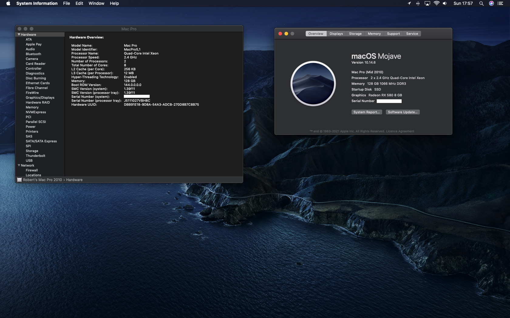

I have also macOS Mojave on other SSD and working normal (see attached picture).
Certainly seems to be all good when booted natively and that the issues are OpenCore related.

So there was issue with installation - as I installed macOS Monterey with noMetal GPU and after installation I switched to Metal GPU - all what I have to do is:
1. open OpenCore Legacy Patcher and run POST INSTALL ROOT PATCH -> REVERT ROOT PATCHES
2. restart Mac (after restart I had full GPU support but no WiFi)
3. open OpenCore Legacy Patcher and run POST INSTALL ROOT PATCH -> REINSTALL ROOT PATCHES
4. restart Mac (after restart I have both - full GPU support and WiFi 🙂 )
