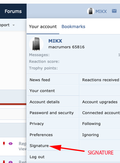

l politely suggest that you go to your Macrumors member profile and make a "SIGNATURE" = a description of your cMP.
If you make a SIG it will appear in every post you make and assist members in helping you.
My SIG is at the bottom of this post as an example
You should include that you have a 4,1>5,1 ( flashed 5,1 Mac Pro )
