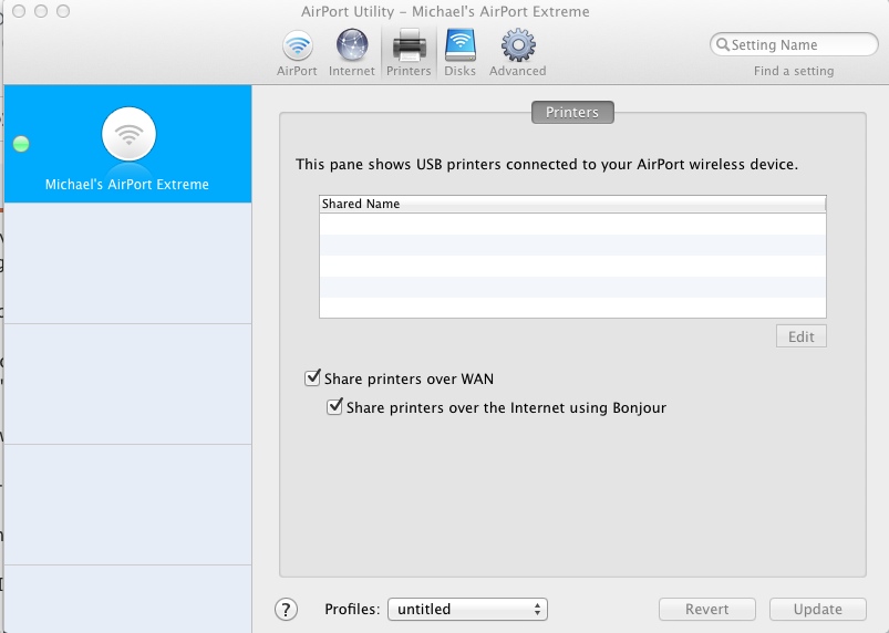

( Note : I did the setup in another install of Mavericks on another HDD. Currently
the printer is not connected to the Airport Extreme but it DID show up in the above field. )
1. I'm connecting using a USB cable to the airport Extreme.
In the "Printers TAB should I select WAN or Bonjour or both ?
. . Anyway I selected BOTH.
2. I re-installed the driver for my printer - it was seen as a Bonjour printer.
3. Turned ON Printer Sharing.
When I tried to print the printer went to "Paused".
Bonjour Browser can see the printer in the Airport Extreme.
but still can't print.
4. Should I use IP printing and only select "Connect over WAN" in Airport Util 5,6,1 ?
I have never found printer sharing to be an exact science.
You do not need to share printers over WAN or over the Internet using Bonjour. You are just exposing yourself to the Internet, so please do not do that. Those options were not checked in my screen shot, so I am not sure why you decided to do that.

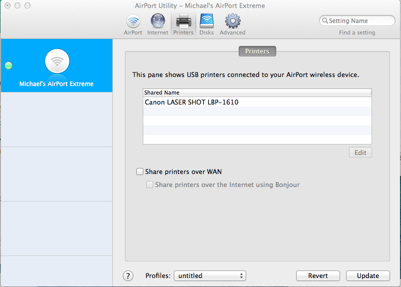

3. I ran Airport Util 5.6.1
The printer was seen by 5.6.1

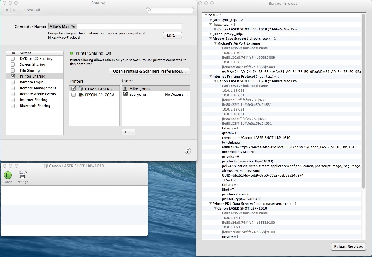

I ran Bonjour Browser which shows a numberof IP addresses.
Now I turned on Printer Sharing . .still puttin the printer into paused mode.
SHould I try setting it up as an IPP printer or HP Jetdirect or ?
Which IP address should I use ?
Is it worth enabling Bojour in 5.6.1 Utility ?
I noticed the Bonjour Browser comment " Can't resolve link-local name" could ythis be a problem ?

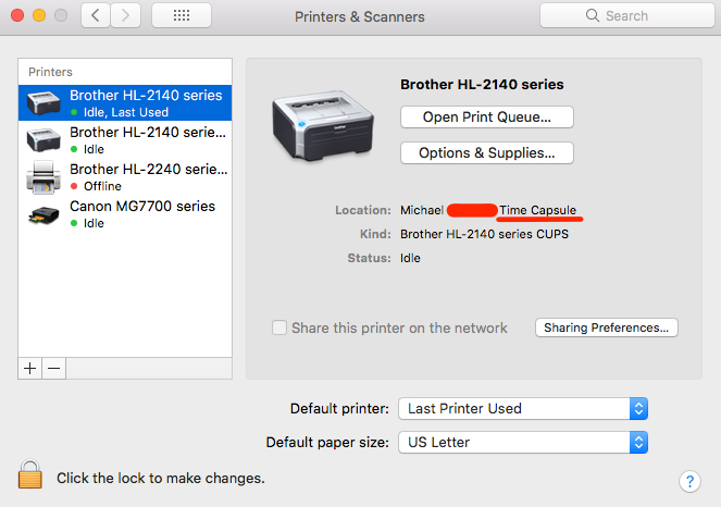

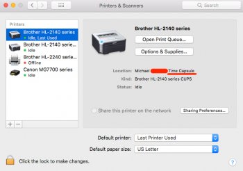

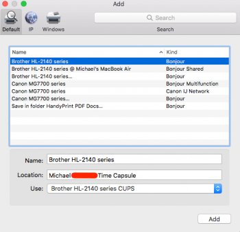

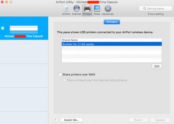

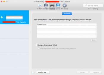

Hi Mike,
I plugged the printer into my Time Capsule and it was as easy as I remember (which is why I suggested it to you, I was hoping it would be just as simple for you). Once it was plugged in it was visible in the Airport Utility. After that I went to the Printers and Scanners Interface and added the printer to my system.
Screen Shot 2017-11-22 at 11.51.29 AM.jpg Screen Shot 2017-11-22 at 11.52.35 AM.jpg
I cannot see that turning on Printer Sharing is required as the Airport should be sharing the printer on the network, but I cannot see it being a problem either.

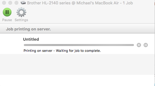

I wonder if this might have something to do with the queue or how the system is spooling the print job. Try have the queue open before you send a print job and see if it reports anything unusual.
I am guessing that the print job is getting through the queue successfully otherwise you would see all your old print jobs just sat there.
