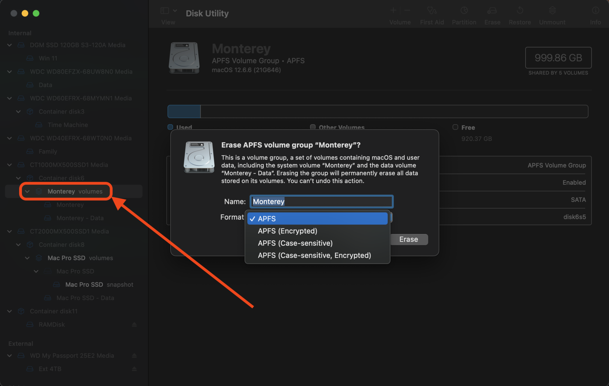

Edit: Now in Mojave. The other day I just wanted to play a game, this time I needed to format a spinning drive with HFS Extended Encrypted and they took all those options away, even though it mounts just fine.
Format the drive, not the partition / container.
You cannot format a partition inside an APFS container to HFS+.

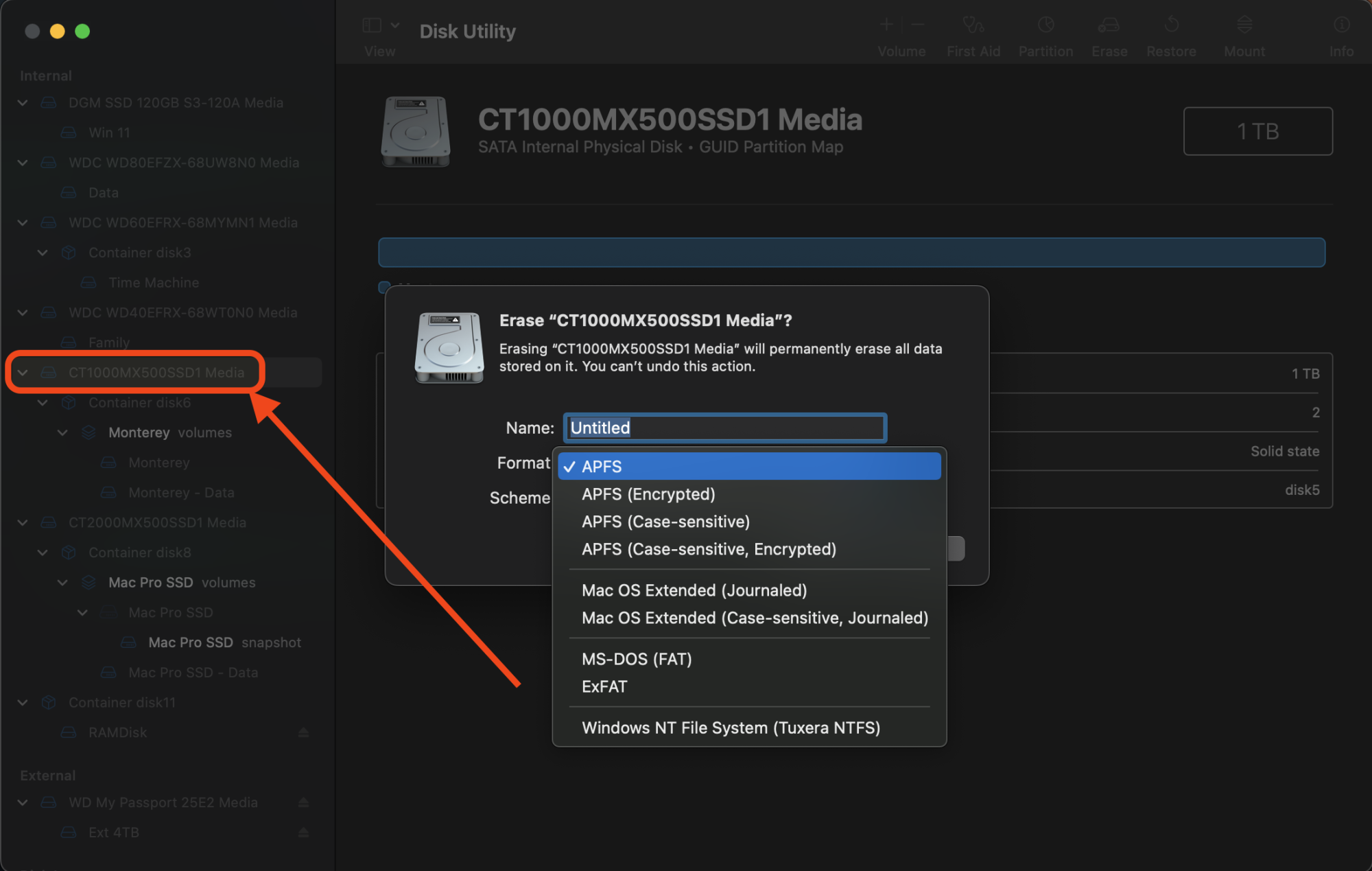

But you can format the drive itself to HFS+.
