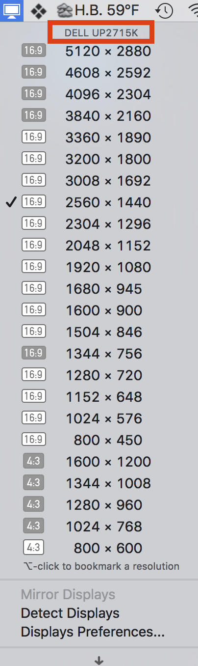

My next question is:
Now that I have got 5K working on the cMP, it’s literally at 5K. System preferences says 1440p is available only on low resolution mode.
Is there away around that to get pixel doubling?
[doublepost=1505941960][/doublepost]NEVERMIND!
I figured it out. Had to press the option key and ‘scaled’ for more available resolutions.
Thanks again everyone for the help, especially h9826790!

My Dell 5k is all setup and working awesome on my cMP. Yes, I had the wake from sleep issue so I just disabled sleep for now. Other than that all is well.
Well.... Now that I've had a little time to tweak a few settings all is working very well in Sierra 10.12.6 and Windows 10 Pro. The more I use this display the more I like it. I really wasn't sure at first but now I see it's a very nice upgrade from my Apple Cinema Display. Everything is super crisp looking, text is VERY sharp and colors are very rich.
I now see that sleep works fine in Win 10 (display comes back on wake), It's only macOS that has the sleep issue. It's the only issue I see at this point.
