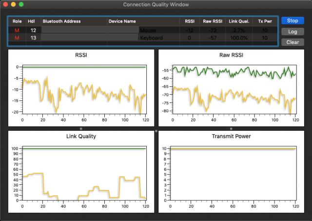

I have tried unpairing and repairing the mouse and moving closer to the cMP, no luck there. I downloaded the Bluetooth Explorer tool and ran the Connection Quality Window for a bit. Here's what I got:
Screen-Shot-2019-04-14-at-11-57-27-AM.png" alt="Screen-Shot-2019-04-14-at-11-57-27-AM
Check out the Link Quality. The green line sitting solidly at 100% is my Magic Keyboard, sitting 5 inches from my Magic Mouse, the yellow line. It's a night and day difference.
Are Magic Mice known for this? Could it be a hardware issue? Unfortunately I don't have another bluetooth mouse to try.
