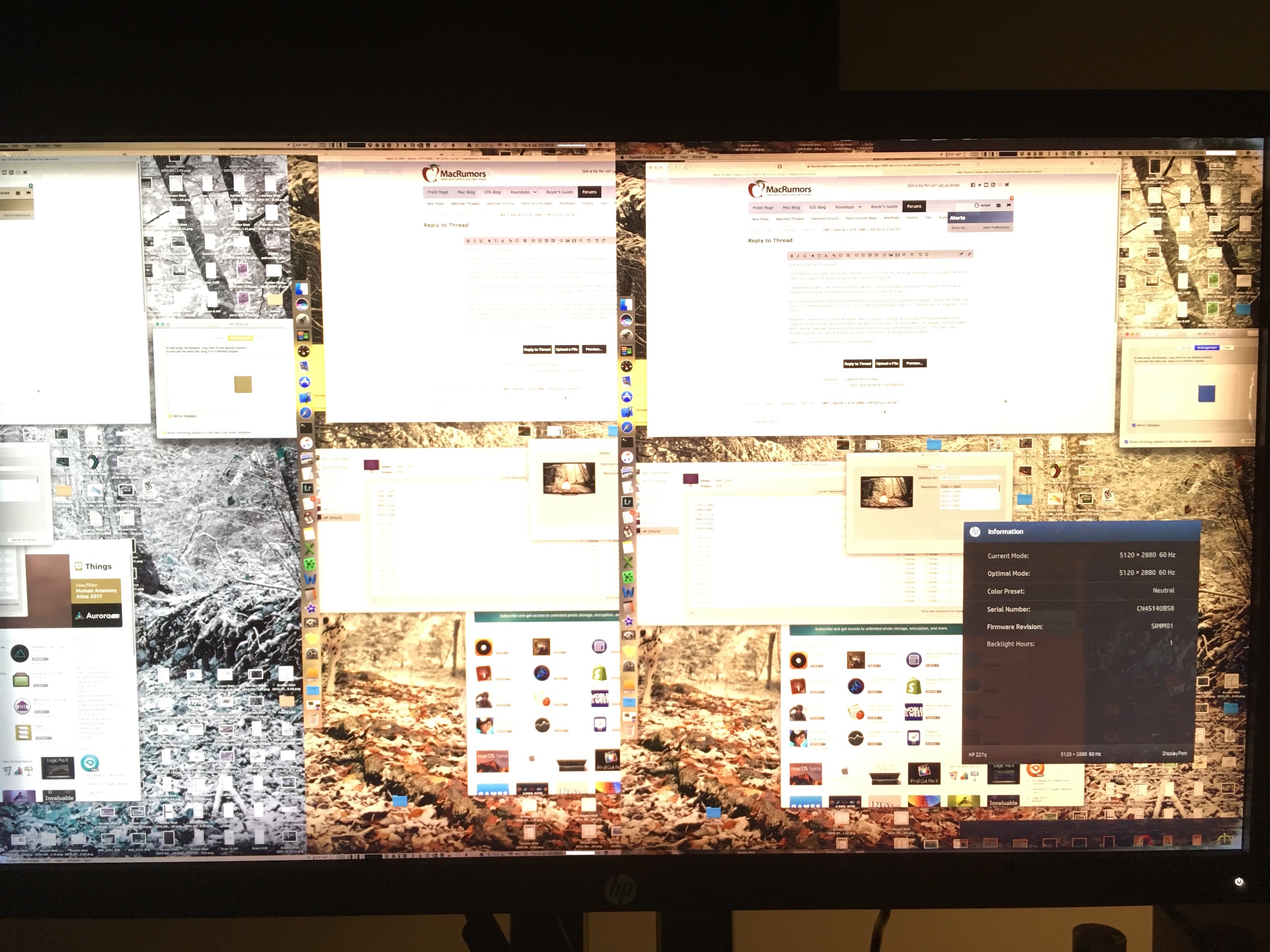

Once in MacOs after the Windows experiment, I chose mirroring between the 2 instances of the display, and Optimise for the second one (the one not showed). The display is almost stable (much more than during my first attempt), with 2 partial duplicate desktops of 2560x2880 and a full one : IMG_8335.jpg
The screen OSD correctly reports the right 5K@60Hz resolution. but there is a strange ghosting effect..
Maybe I could achieve something using SwitchResX?
The horrible flickering effect came back when unplugging the second DP cable. I guess it will be reset once I boot in Windows...
