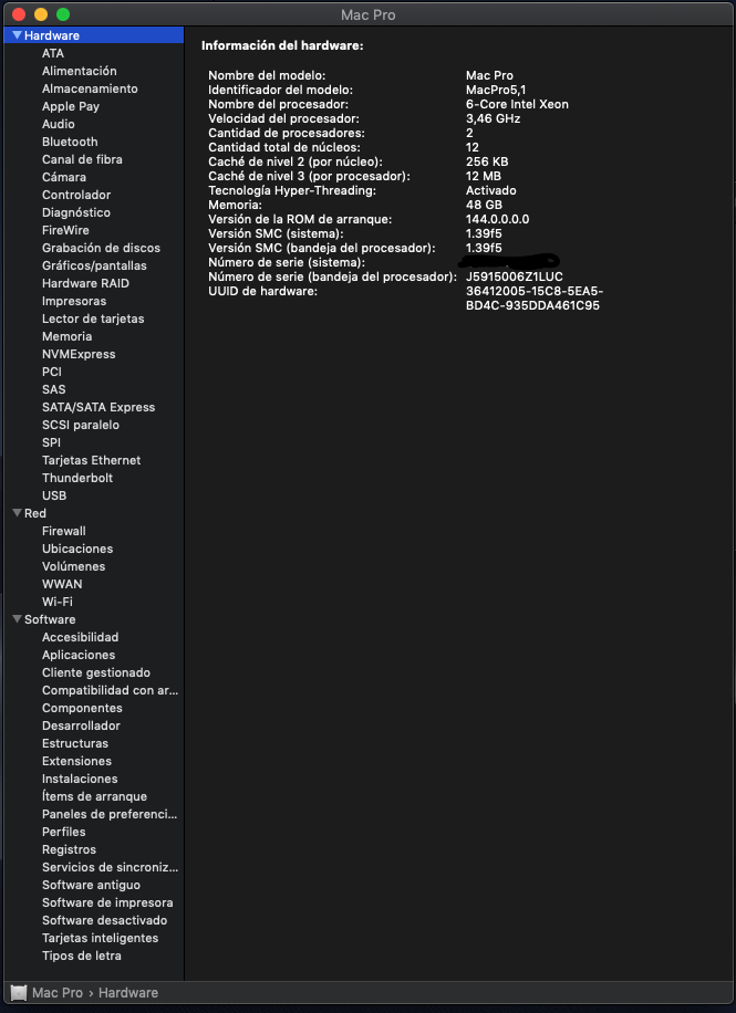

If you go to : about this mac> hardware info you should see this (screenshot):
There are 2 SMC numbers : 1 for the backplane , 1 for the CPU tray.
They have to be the same , in other words make sure when you buy a CPU DUAL board/tray for your MP4,1 , that it's a 4,1 CPU tray.
Flashing doesn't change these numbers.

The dual CPU tray doesn't get "flashed" even when you flash your computer. Only the main logic board does (the "backplane" as mentioned above). You cannot put a real (2010/2012) 5,1 dual CPU tray in your flashed 4,1. If you do, the fans will run at full speed all the time. You have to find a genuine 4,1 dual CPU tray... whether it's from a flashed 4,1 or a non-flashed 4,1... for it to work in your flashed 4,1.
There are 2 ways to identify whether or not your dual CPU tray is from a genuine 4,1:
1) - the CPUs are de-lidded from the factory. This can only be seen if you remove the heatsinks.
2) - you check under "About this Mac", and then select "Hardware Info", and look at the SMC number of the tray. As mentioned above, it will be 1.39f5.
High Sierra/Mojave will not "reject" a flashed 4,1 that has a dual 4,1 CPU swapped in. The CPU tray is independent of the flashing, and does not get changed. Therefore, your question is irrelevant.
