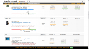

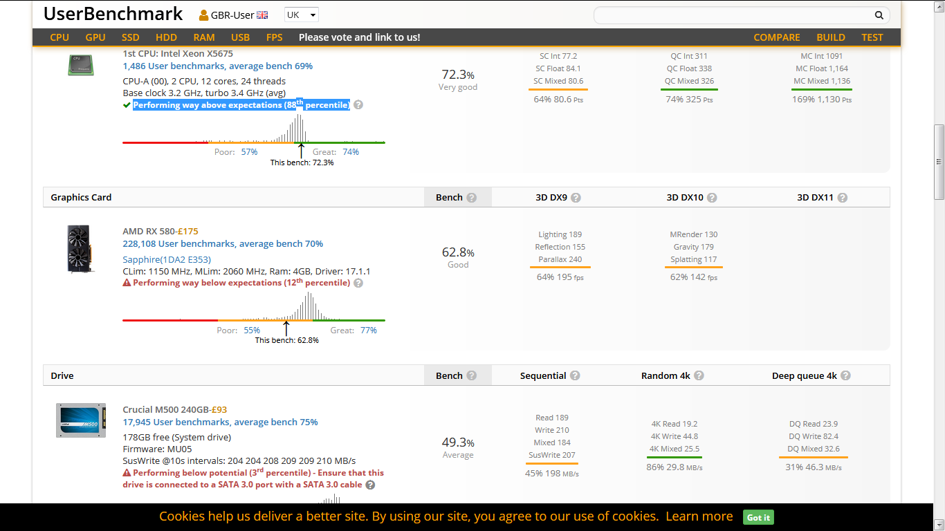

I ran the userbenchmark running Windows 10 pro, CPU score was very good
Performing way above expectations (88th percentile)
GPU score good, however the GPU is stated as
Performing way below expectations (12th percentile)
Is this normal in cMP?

RX580 performing way below expectaions?
My question is regarding the low 12th percentile performance of the RX580 in my cMP, is it normal in all cMP?

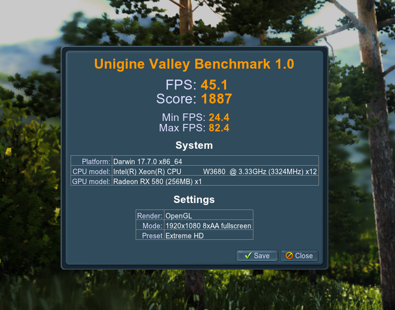

ill check my card now to give you something to compare to
ps what RX 580 do you have?

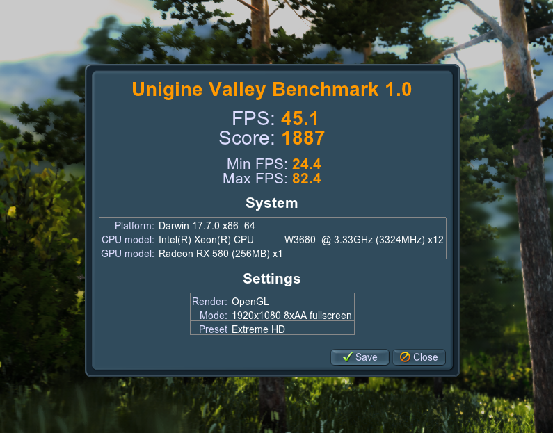

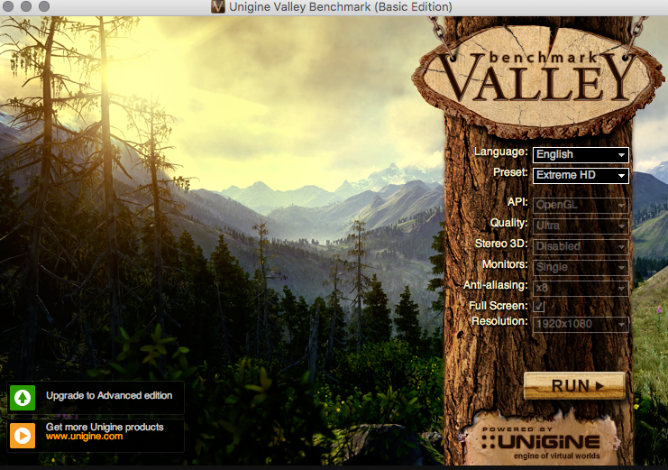

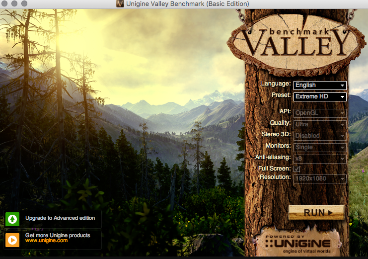

osx valley benchmark with a RX 580 pulse 1330mhz, when you do it make sure to use the extreme HD preset and not to change any settings just hit the benchmark button

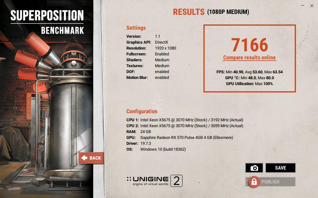

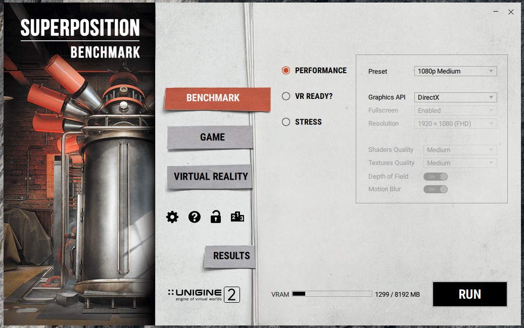

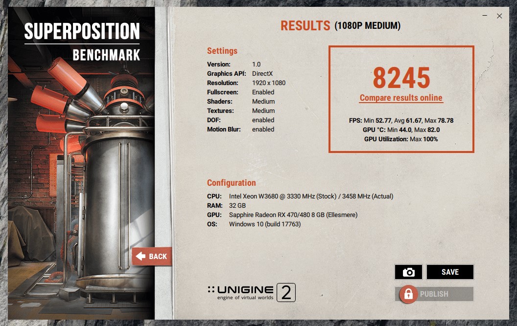

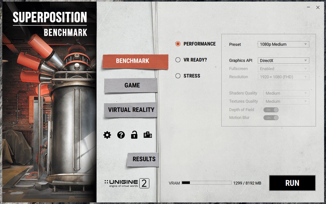

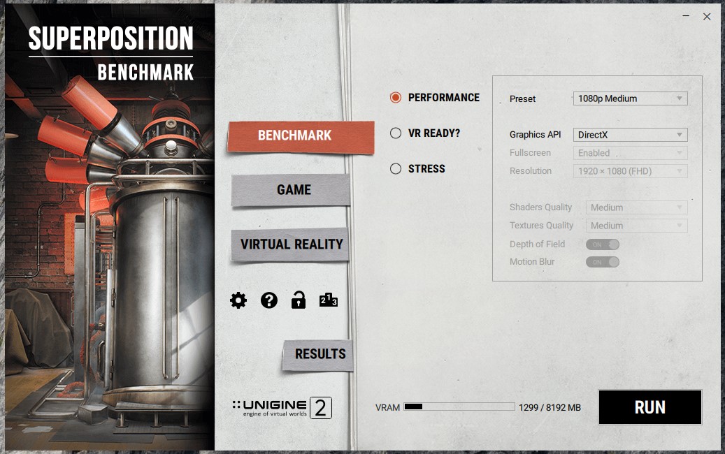

superposition benchmark windows 10 RX 580 pulse 1300mhz (make sure you have the same settings as me)

The bench GPU results are affected not only by GPU, but also by CPU, motherboard, memory and so on.
cMP is an 11 years old creature:
1) very old CPU (~ 1 generation of Core technology, now the 9th is in use);
2) it doesn't support PCI-E 3.0;
3) it has low memory bandwith and high latensy in some cases due to CMP (dual CPU).
Most results in benchmark are related to newer systems.
Don't look at bench, just use it to make money or fun. cMP does it's work very well 🙂

yes id asume the GPU is working just fine, id gess the benchmark you used is just funky

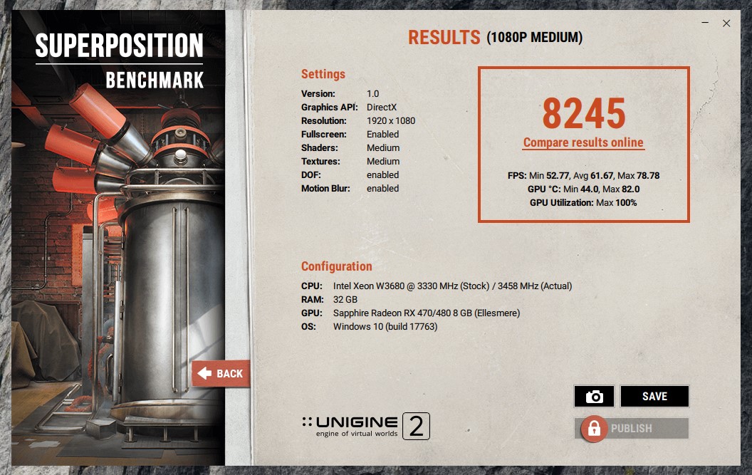

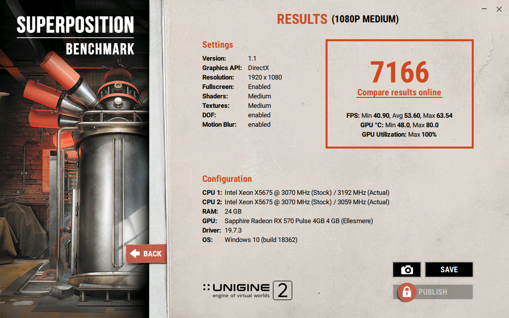

Seems about right

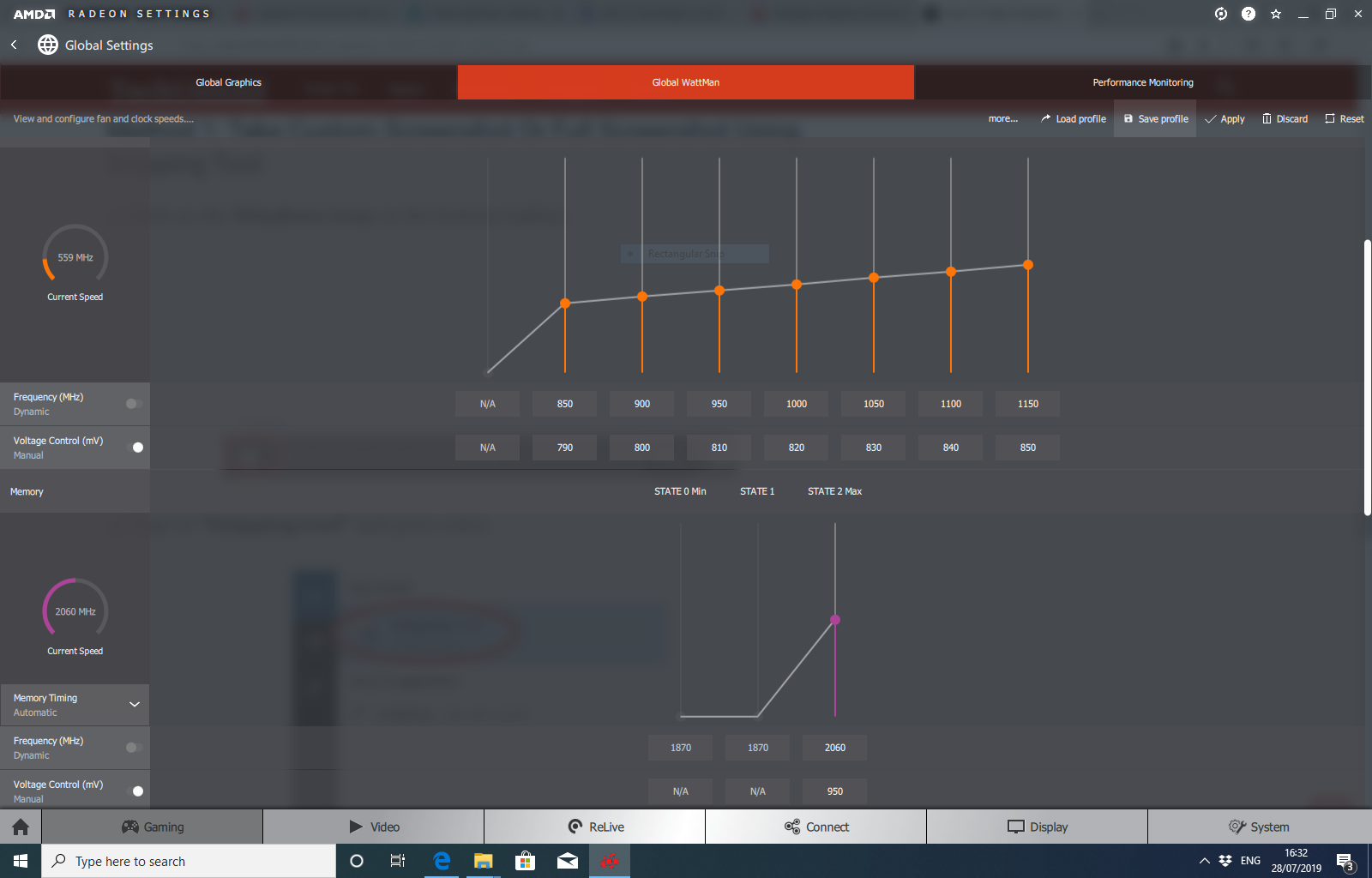

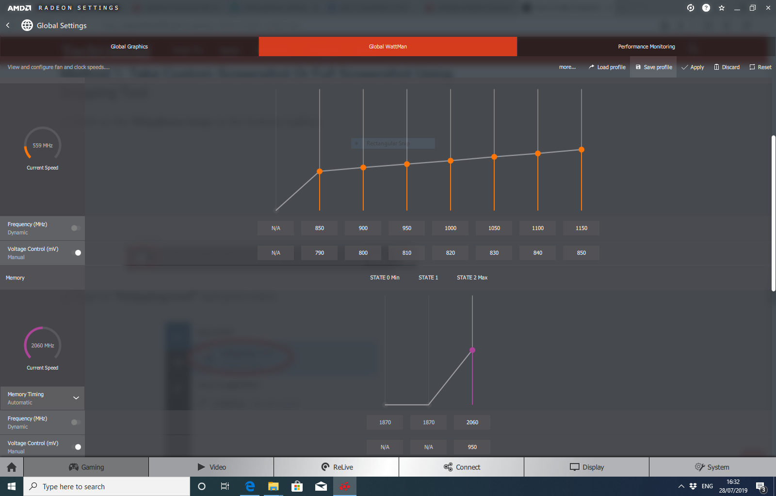

not much difference in the results, I did notice in the userbench mark, so I checked in AMD watt man and the GPU clock is 1150mhz, I looked up online and all examples were 1257mhz?
if you have not changed any of the settings it looks like a used mining card the voltages are all super low & vram is OC'ed as well as low clock speed.
so at the mo it's set to be right in the efficiency curve for power to speed for compute use & as a big plus it will use less power so the fans will be near silent non stop and the vram speed will be maxed out.
if you want you can set it to default you can flash back the original rom or if you want to keep it like this, if you do want to flash it to stock make a backup of this rom just in case you like it more.

im tempted to say the score you got in the benchmark looks good so it may be worth keeping like this & at least do backup the bios if you do want to try the orginal settings.

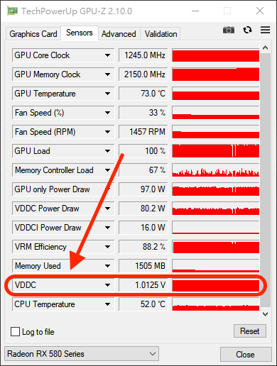

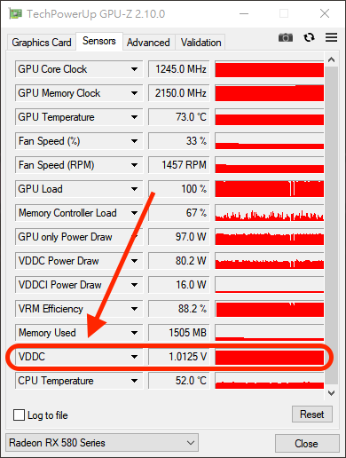

That's not necessary a more effective downvolt.
As I said in the RX580 ROM study thread. There are two loops in the PULSE ROM to pick up invalid parameters. You can set 0.85V in Wattman, but may be the actual measured voltage still 0.98V.
You should run GPU-Z to check the measured voltage when you playing around with Wattman.

Thanks for the enlightenment. It's indeed the case, here is my GPU-Z capture.
Given this information, how would you suggest myself to key in at the Polaris Editor to get a BIOS with this exact setting? It would be cool if I can try this in MacOS.
I do aware that the current Wattman setting in Windows is NOT portable to macOS as the card would still remains factory setting when booting into macOS.

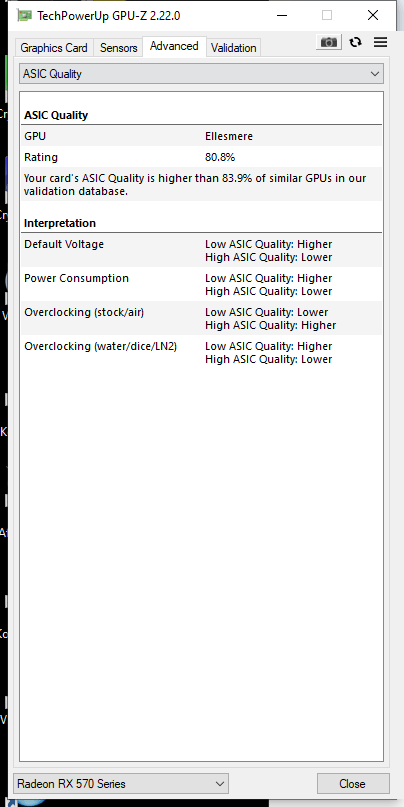

I check my cards ASIC quality,
I suppose it is quite decent, so the card seems to run fine even under 1v.
I saw that you can crank your memory to 2150mhz, may I know at what voltage to achieve that? 2050 seems to be the best I can get without any artifact. My current feeling is that running the card at lower core frequency while having the best memory speed seems to achieve better benchmarks results. Is that a proper understanding?
In windows i keep mine set to 1000mhz 99% of the time as it’s all i need and keeps the fans whisper silent at about 20% slower i guess
Yes that looks like the same one, it is very quiet and had a low power draw in this configuration
