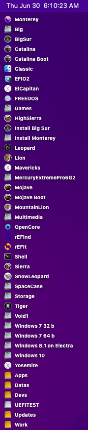

Hello, I have a MacPro3,1 running Monterey but I am not sure I can answer all of the questions. The bluetooth should work. It is reported the same for me. I have the original Nvidia GPU card that is root patched to work for Monterey. It works well for most things but there are some compromises. I have read that the USB issue is that a port might initialize to 1.1 and that using a 2.0 hub will fix it. I am using a USB 3.0 card that works out-of-box so I generally avoid onboard USB.
I have High Sierra on HD and Monterey on SSD but it is pretty easy to make a new partition on the disk you have and install Monterey to that.

What! No Windows Vista?
I used to have Vista 32 bit and 64 bit and XP but I removed them Jan 2014 just before installing Windows 8.
Code:
/dev/disk3
   #:                       TYPE NAME                    SIZE       IDENTIFIER
   0:      GUID_partition_scheme                        *320.1 GB   disk3
   1:                        EFI                         209.7 MB   disk3s1
   2:       Microsoft Basic Data Windows Vista 64 b      69.8 GB    disk3s2
   3:       Microsoft Basic Data Windows Vista 32 b      59.1 GB    disk3s3
   4:       Microsoft Basic Data Windows XP b            96.6 GB    disk3s4
Code:
/dev/disk3
