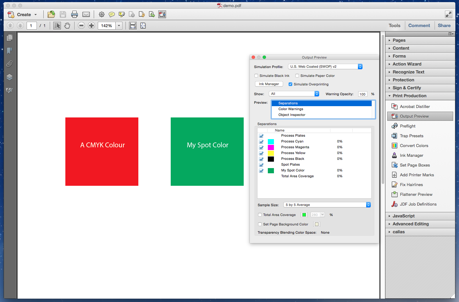

What I want to do is create a PDF that contains an additional separation. That's to say, a additional spot colour. I've attached a PDF as an example which has a spot colour I've made up called "My Spot Color' (the name and RGB values could be arbitrary or from a library such as Pantone).
If you look at the screenshot from Adobe Acrobat's Output Preview tool, you can see how the spot colour appears.
If I was to print this PDF out as separations (as you would for a printing press) then I'd get 4 separations for the CMYK red colour and a single separation for the green.
