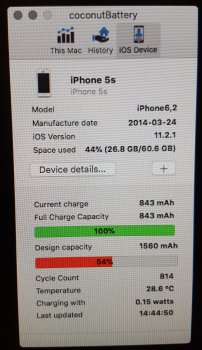

I have a iPhone 5s, Never had a battery change. Ive downloaded the coconut battery app to check its condition.
What does the 54% in red mean ? Does it mean i should change the battery ?

I'll second that - cycle count is 814, and full charge capacity is only half the design capacity, new battery time

Since your battery is gonsky, the device will be slower thanks to Apple’s sneaky throttling of the performance.

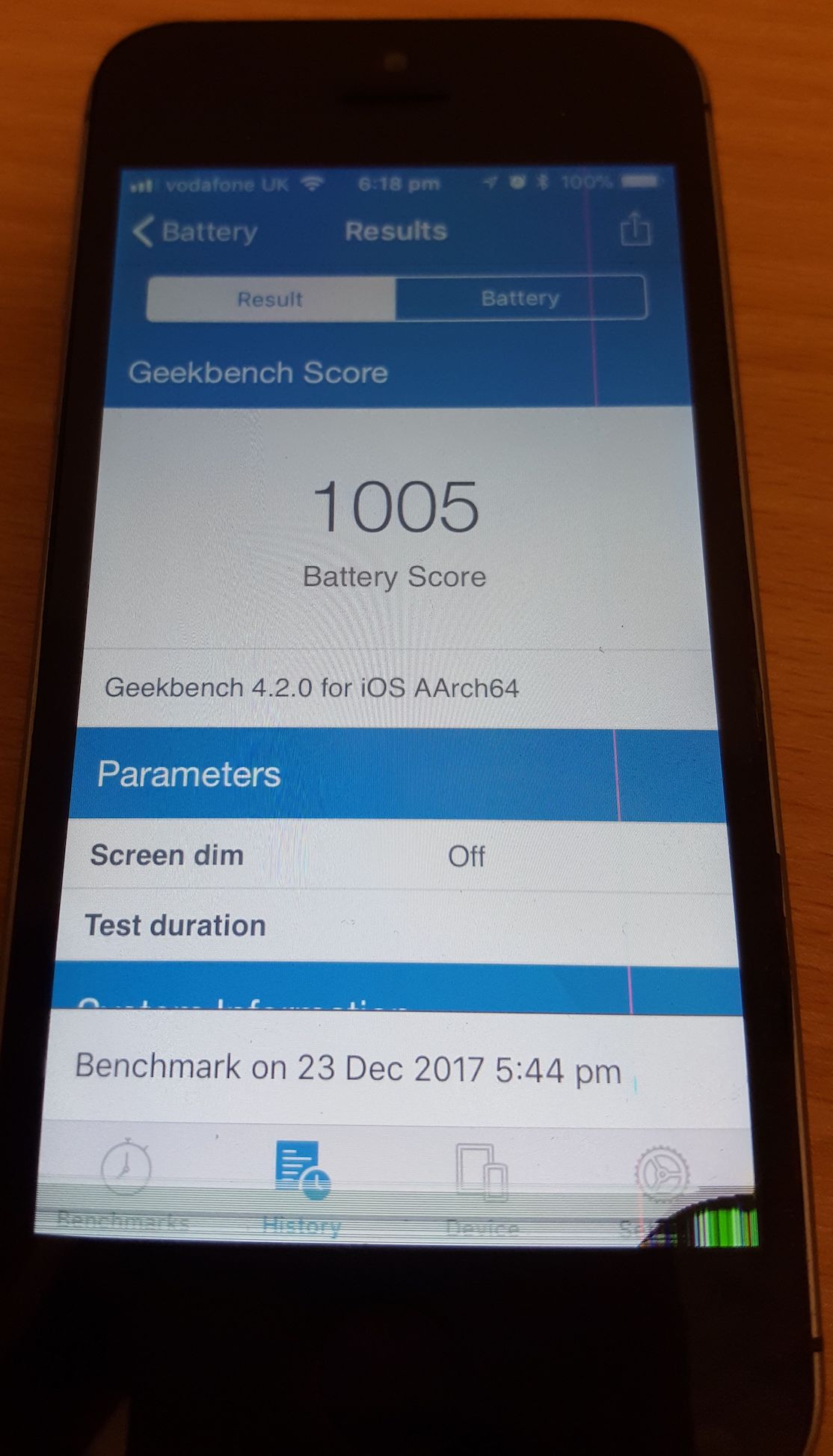

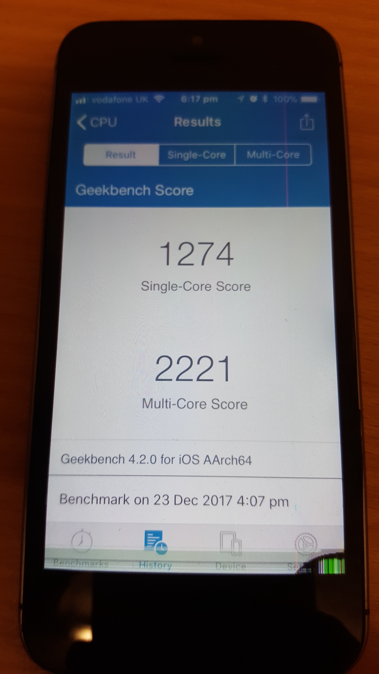

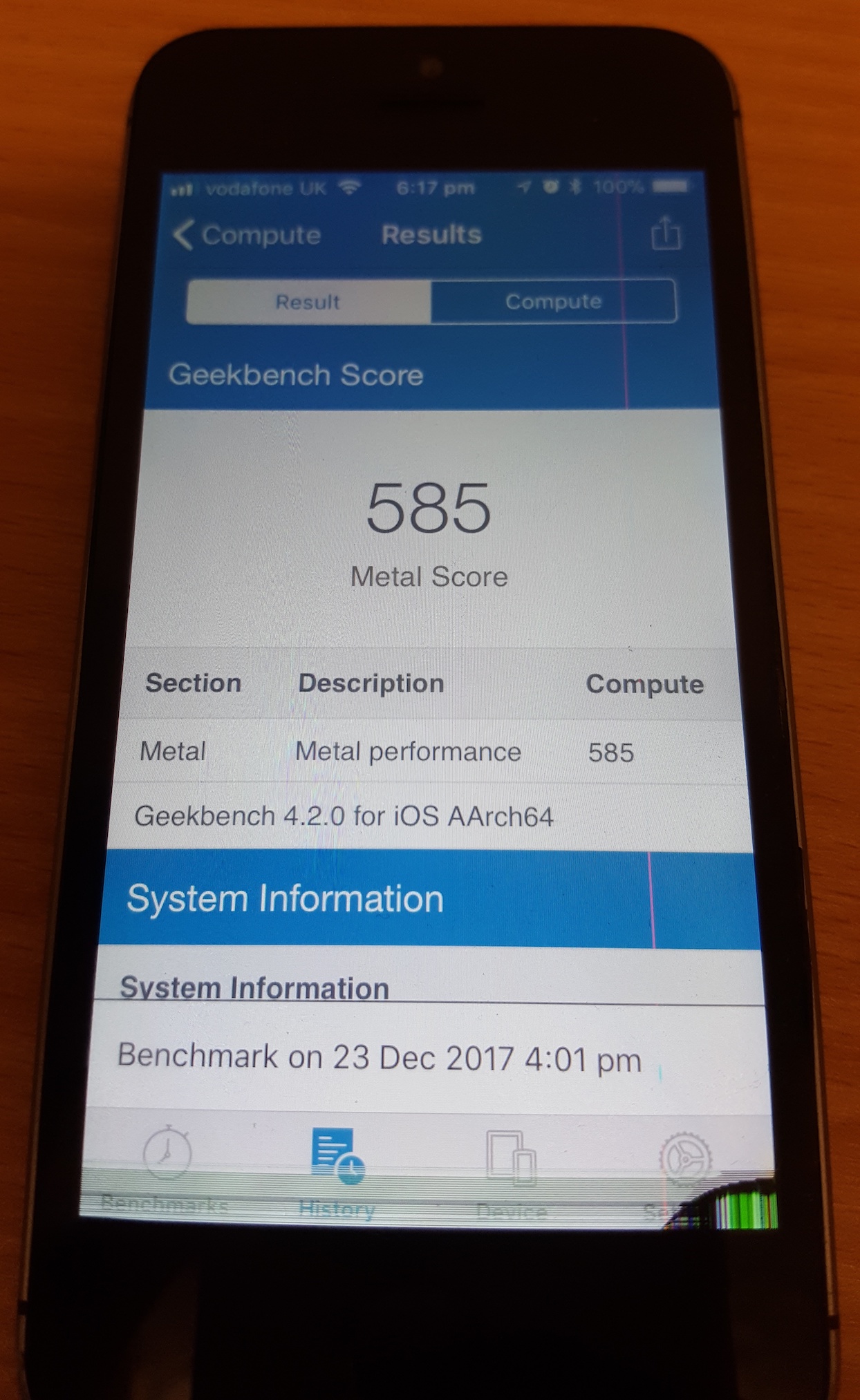

Anyone tell me what these scores mean ?
I used geek bench on my iPhone 5s
how do these scores compare ?

Your 5s is not being throttled. A new battery will give you longer standby time, but not higher performance.
Your 5s will not be throttled by Apple due to a weak battery. Only iPhone 6 and later are affected. From Apple:
"Last year we released a feature for iPhone 6, iPhone 6s and iPhone SE to smooth out the instantaneous peaks only when needed to prevent the device from unexpectedly shutting down during these conditions. We've now extended that feature to iPhone 7 with iOS 11.2, and plan to add support for other products in the future."
