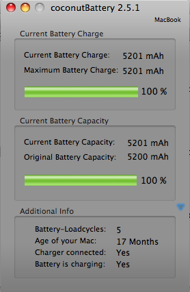

i think i give my battery a real work out and hard use since my battery is either with me on the go in college or in the desk for long periods of time *ahem.. acquiring ahem*stuff, so its never the same pattern. i do deep cycle the battery after leaving it connected for a few days and when i dont have it charging for a long time i just leave charge it randomly even if i dont charge it fully. I also calibrate it once a month so maybe that the biggest factor for it being that healthy. i really dont know how to explain but i dont know if its because i m a mac tech or lucky with this 😛
heres my proof for you guys
and i dont know why coconut battery says 5 cycles??? since this macbook is one years old😱
