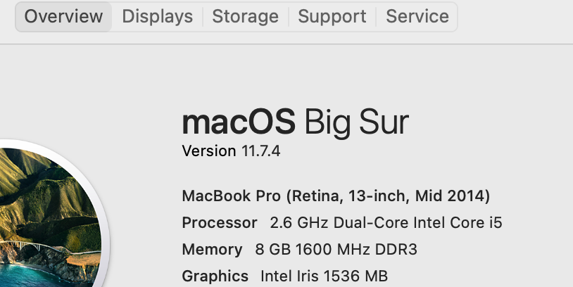

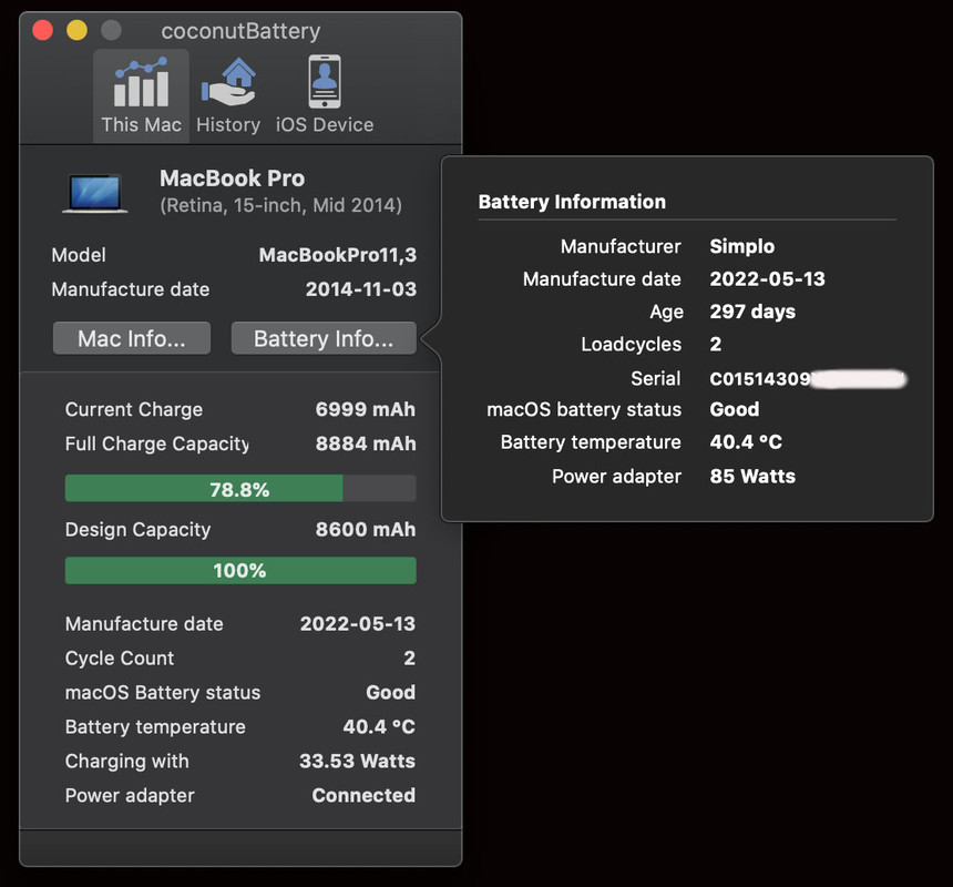

I just booted my mid-2014 Pro 13" that has a 3rd party battery from Amazon and its stats look correct under macOS 11.7.4 in Coconut.

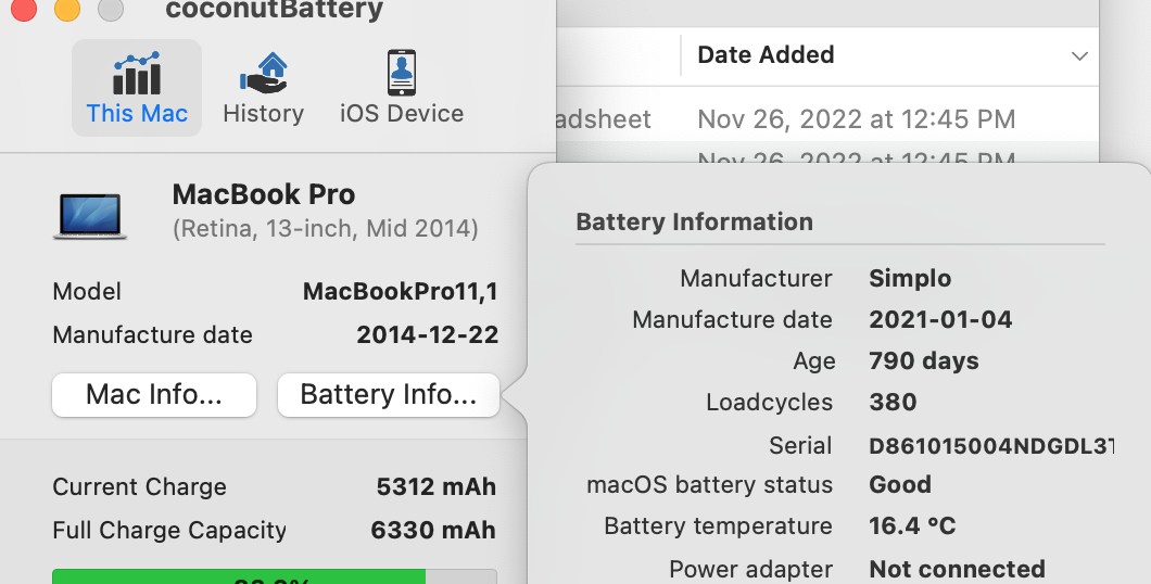

- numbers 4-7 in my serial are 1430 which doesn't make a lot of sense 2021 week 43 day 0??
- but then "Manufacturerdata" says 2020-12-06
It seems like the Coconutbattery and BH2 are both now reading the serial and getting some weird results. Maybe the serial is not in correct Apple format as this is aftermarket battery? I think in Mojave it still did read the date from Manufacturerdata (note: not date, its actually data) and reported the date correctly.

Thanks. Well, I wonder where Coconut takes your manufacturing date from? Your serial #4-7 (1015) are not indicating the date and MF data doesn't look like a good source either.

I have no idea either. My battery stats from Coconut may not be correct either.
Well, at least you get the correct year and not been told that your battery is already 3000 days old.

EDIT: I just found an screenshot of the Coconut report about this battery under Mojave. It indeed says Manufacture date is 2022-05-13. So I don't know where it took that either. It doesn't match the serial number data or the Manufacturer data.
