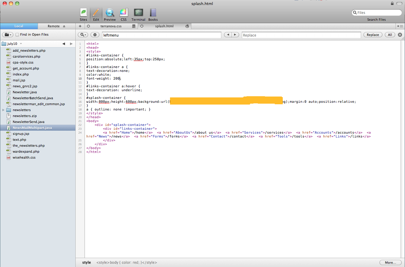

So I have a local file open and in my file browser pane I have connected to a remote site. Is there really no way to move the file over to the remote site? I just want to drag it in... doesn't work.
When you're connected to your remote site, look for a up arrow next to your local file in the file browser. Click on that and Coda will upload the file to the remote site.
I don't see the arrow at all?
AH! Sorry my bad, you have to define your remote connection as a site first, THEN the arrow will show up. I guess it doesn't work when you manually connect each time.
