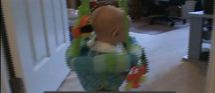

In regards to waviness: Does it look like a comb, or are there real waves? Please, if you can, post a screenshot.
Yes, 720x480 is the right resolution.
Looks like comb to me - but the lines move across the screen blurring the image. It gets worse with any movement, or when any voice speaks on the video. The louder the voice or larger the movement, the bigger the "blur". The screen shot is just a moment in time of course, the blur is so bad that faces are rather unrecognizable at times.

Try to flip around field order.
That is about the worst example I've ever seen. 😱
But if I'm not mistaken, there's something else wrong: the combing should be independent from your audio levels.
Hmm, not too sure what you mean by field order? Could you elaborate? I'm def. not an expert, but from my understanding, the audio issue comes from the fact that my camera records in Mpeg2-muxed. I use the harddrive or sd cards, not the CDs, on the camera. The muxed files open on the mac, with no sound however. I have to either 1) demux the files through mpeg streamclip - and then run them through streamclip AGAIN to compress to AIC...OR I can run them through streamclip and just convert to AIC. Mac recommended both solutions. Neither changes the quality of the video. The wavy lines w/ the audio is so strange - so the only thing I can figure out is the muxed thing...because on the PC none of this is an issue. Does it look AMAZING on my pc? NO. But, the wavy lines aren't there - just not the greatest quality in low light, but it's not the best camera. However, we don't have the abiliity to burn to DVD on my PC so the mac is the only solution at this point to save these 18 months worth of files.
Glad you think it's as bad as I do.
Field Upper or Lower?
Have you tried both field options?

In MPEG Streamclip try upper or lower to see if it changes.
And also, you have to watch your clips on a field (tv) monitor.
Cant use a computer display for NTSC format and think its fine.
Keep in mind your computer is square pixels and the format your dealing with is non-square (720x480 DV or 720x486 D1).
It def is the mux process thats ruining this experience for you.

That shouldn't be classed as "poor quality", it should be classed as a fault.
The problem you're experiencing here is that for some reason MPEG Streamclip thinks your video's resolution is 352x288. This means that when you export at 384x288 it's not properly engaging its scaling filter. The result is the mess you're getting.
What you need to do is manually specify a resolution of 720x480, AIC as the codec, with uncompressed audio. Don't select deinterlace. Hopefully the resulting video will have a frame rate of 29.97, but if it turns out to be something else, you'll need to type that into the frame rate box in MPEG Streamclip too.
The video that comes out will have visible interlacing, but that's what you want if you're going to make a DVD.

For the record, muxing, AIC and field order are not the problem. (I'm 99% sure.)
