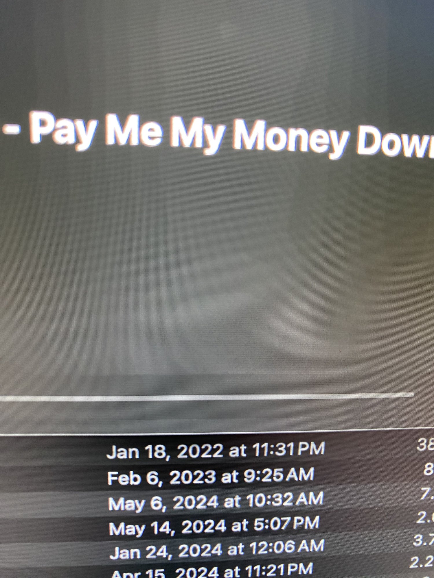

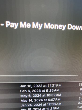

Hey, y'all, I am having a VERY strange issue with my external monitor, which is most noticeable in dark mode, and it is really getting on my nerves. Basically, I see this pattern all over the place, and I am told that this is because macOS is setting the color depth incorrectly. You can see what I'm talking about in the attached images. I am using an LG 27UP600 monitor, and have tried changing EVERY setting on the OSD, including factory-resetting the display, all of which don't fix the issue. I have also not found a way to fix this issue in macOS, either. Google and YouTube have been of no help.
Does anyone know if this is indeed the problem, and how to fix it? Any help appreciated as always!
EDIT: I should clarify that both these images are of the external monitor, NOT the built-in iMac display.

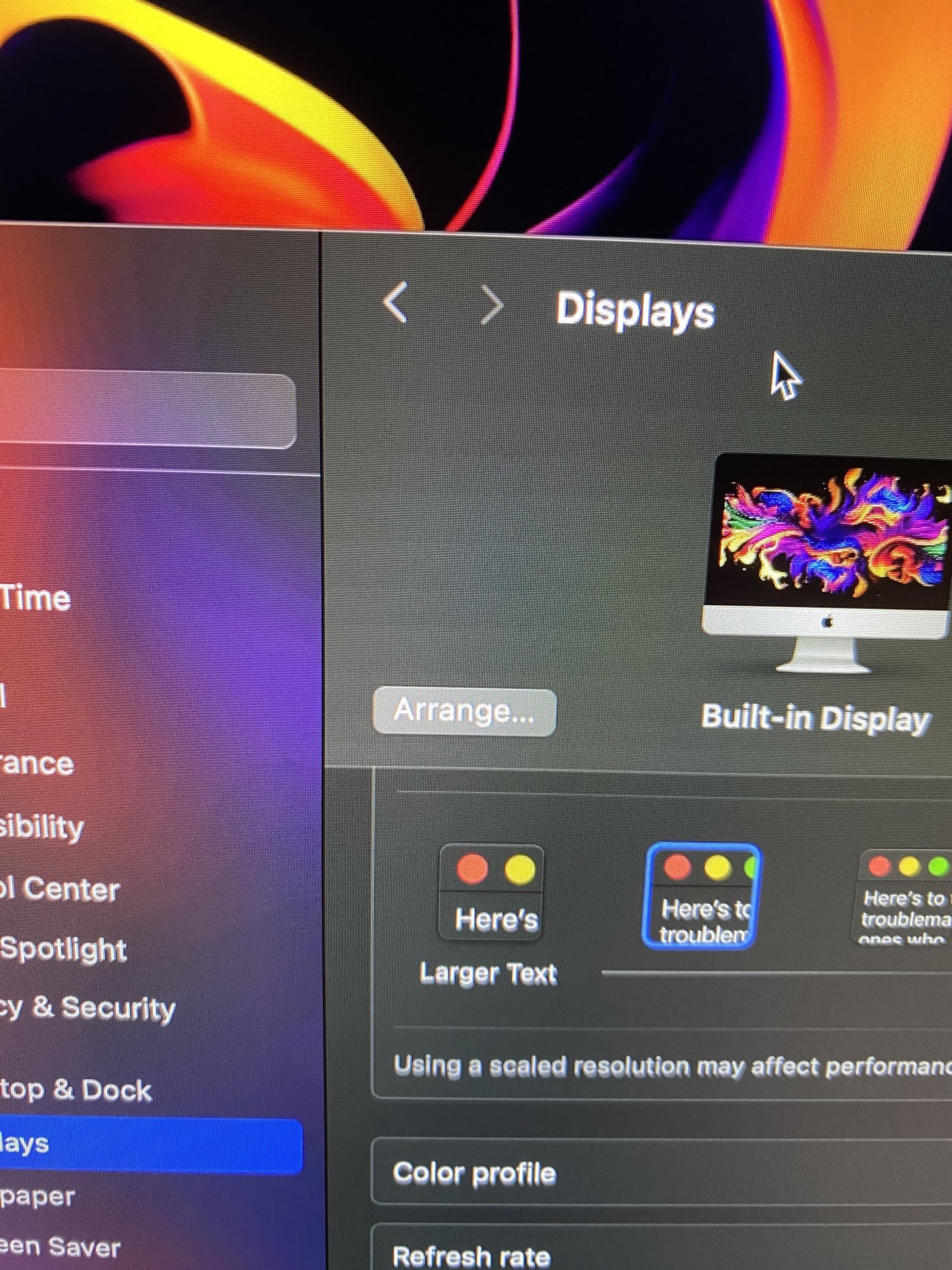

Your screenshot indicates you are using the built-in display but you state you are using an external monitor.

Everything in these pictures is on the external monitor, not the built-in display. I apologize if there was confusion there. The purpose of that photo was to demonstrate the "streaks" (idk what else to call them). The fact that "built-in display" is in the photo is irrelevant and should be disregarded, as any and all content photographed was on the external display.

Please post a picture with the external monitor selected so we can see the settings for the external monitor.

It says you are using an HDMI 2.0 timing mode, 5K framebuffer (2560x1440 HiDPI mode) scaled down to 4K (because the LG is a 4K display), using 4:2:0 chroma sub-sampling, 10bpc.
But I don't think that should cause the strange gradient. 4:2:0 reduces color resolution, not color depth.
How is the display connected? Have you tried connecting it using DisplayPort instead of HDMI?
