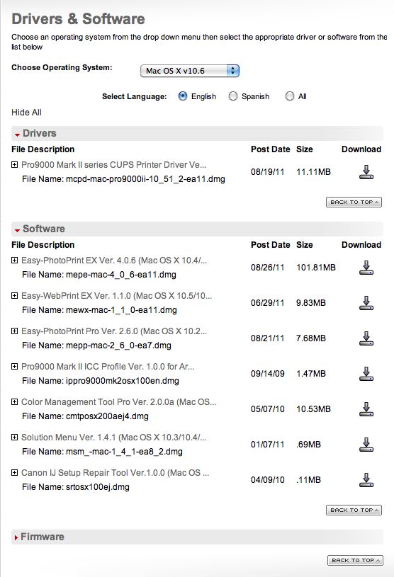

My only disappointment doing all this was finding out that Canon has discontinued their Museum Etching 13x19 paper 🙁 I really liked using that and the front feed to print my outlines which was fantastic for what I create. They still have it in the 8.5x11 and then there is the Photo Rag, it's not the same and I can't "just make do" so I'm going to look around for another brand and hope it works as good or better.
Here is the list of their drivers and stuff…

I was using the drivers off the install cd, then when I updated from the Canon site it gave me two sets so I'm not sure if there was some error with the download and install or what happened but after deleting the first set and reinstalling the latest driver download I had more options for my settings for the 9000MKII and my prints were almost where they once were as far as color.
There were three or four updates total but after each one I tested the printer to see which might have caused issues. I have the list of stuff below and as you can see some of the dates are long overdue for an update like the color management and icc profiles (2009/2010).
The only thing I'm not sure about is installing the software program on my 9000MKII since I use other programs to print with however if it gives more options of paper and size choice I just might.

I would see what drivers are listed on Canon's website first but after finding some youtube and other videos of the software that comes with the 9500 & 9000 I now plan on installing the easyprint software and try working with them more. There are some settings and paper profiles that comes with that and may aid in printing. If you get a chance check out the videos about the programs on Canon's site. I'm starting to wonder if something got mixed up the first time around as they have some settings for different light sources and types. Did an old driver not agree with a custom Canon setting? I'm not sure but this week I'll be doing a process of elimination trying it out.
After checking out that model on the site I would install most from the support page. It appears to be on track with the list I posted above as far as dates and whatnot for both software and drivers. No new firmware for either model so that's alright. I will say that the 9000MKII prints much faster and smoother than it did before so something in the reinstall sure helped with the newer drivers.
Keep me updated with that model and the prints you get from it. That looks really nice and if you haven't used a front tray feed before let me know if you need help setting that up. Canon has a poor how-to about setting it up in the manual and online. If you do one step out of sequence it balks at you and makes a few minutes seem like forever 😉
