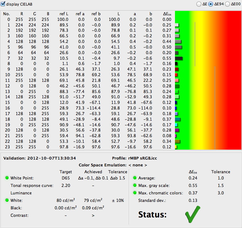

I have seen a few requests for this (well mainly for the LG, but I have a Samsung, can't do much about that).
Keep in mind, every display is different, there will be variance from panel to panel. In theory these variances should be small (they do not calibrate each display that leaves the factor).
There are two profiles, one sRGB, and one L* (which is what I prefer for everyday use).
Calibration done with a X-Rite i1 Display Pro and BasicColor5.
I still highly recommend getting your own i1D Pro. I mean you already spent a bunch of money on a laptop with an amazing Display, why not spend a couple extra $100 more and get it perfect?

OP, I didn't notice much of a difference at all between the stock Color LCD profile and the two from you.

Yeah I can see where you guys are saying "more yellow". The default profile on my rMBP was very good (a million times better than older MBP's). The profile is a ALOT warmer stock compared to my late 2011 MBP.
But the stock profile was still not warm enough (needed to be closer to 6500k). So it made it warmer.
I have been using calibrated displays (both TV, and computer) for about 10+ years, so I am very very used to it. But for one that is not, it would look strange.

Agree .. the 'yellow' or 'off white' complaints occur when one is used to a display with a cooler color temp ..very common in calibrating TVs .. 'my whites look yellow' ..what's actually happening is that the original white was way too blue .. it takes some getting used to ..but if a spectrophotometer gets you to white close to 6500, that's 'standard white' .. and you will get used to it , and have a display that will show what the content intends ( or didn't intend) ..
Would suggest folks first go through the Apple System Preference Display Calibration with Advanced Options .. this will preview what a more rigorous calibration will head toward ..
The other benefit an individual calibration provides is adjustment of Red and Blue Gain for the display ( the retina display has ADC) to get Gray spot on .. this is a foundational requirement for getting the rest of the calibration correct ..I suspect this is what the advanced option in DP does with the sliders ..Popping a profile in without doing this , well ...
