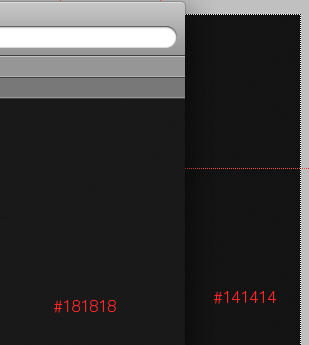

Anyways, I'll try to explain a bit more clear. Photoshop is set to sRGB color profile, Leopard is set to use Cinema HD color profile. Now, when I work in photoshop, color looks correct. After I open the saved image with a Preview or Safari - it's different. I've attached the screenshot.

Actually, there's no option to embed profile when you're saving to JPG and PNG file formats. Embedding ICC is possible only for JPG, but this isn't it actually.
I've posted this problem on Adobe's forums and actually there's no chance to get it identical. Macs use 1.8 gamma when PCs 2.2. That's it. Of course I could calibrate my monitor to match the PCs screen but then all Macs would have lighter designs. I just need to check my works both on Macs and PCs to see if result is acceptable.
Hey. Thanks for your reply.
There's nothing wrong with going with 2.2 gamma, even if you're
using a Mac. Many pros recommend that. You will notice that some
elements of Leopard's UI are not color-managed, but the important
stuff, your work, should be.
Your best bet for getting a nearish match for PCs and Macs would be
to embed an sRGB profile. If you don't, then Safari will interpret the
image in your monitor color space.
I happen to think it's a colossal error that Safari does that. Untagged
images should be intepreted as if they were tagged with sRGB. That
is more likely to be a better match than any other color space. In fact,
many of the online images you see were originally sRGB tagged and
then stripped during exporting.
