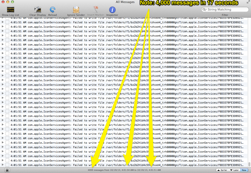

also seeing fail to write error: com.apple.IconServicesAgent
Jonsuh,
I'm seeing thousands of these errors a minute. In fact, the screenshot I've attached shows 4,000 of them in only 17 seconds! Have you made any progress determining the cause?
My log error appears to be very similar to yours:
10/19/13 4:01:35.234 AM com.apple.IconServicesAgent[11049]: Failed to write file ...
Any help would be appreciated!
