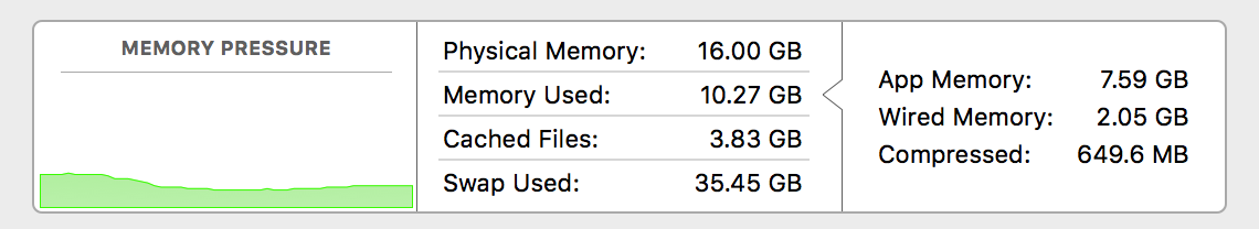

As below
My fans were going crazy and the process com.apple.sbd was using loads and loads of memory (and there really was nearly 36GB of swap files created). Rebooted and it seems OK again now, but that's definitely a bug 🙂
