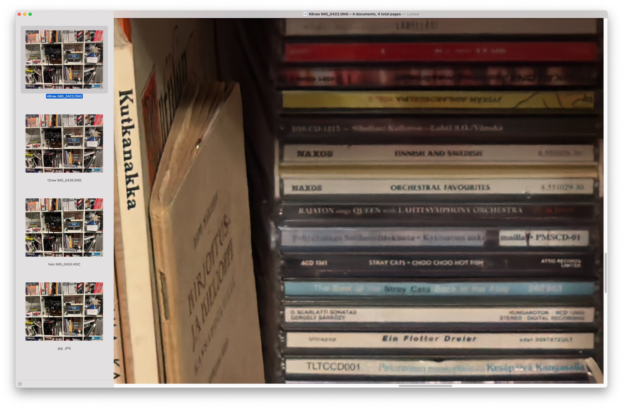

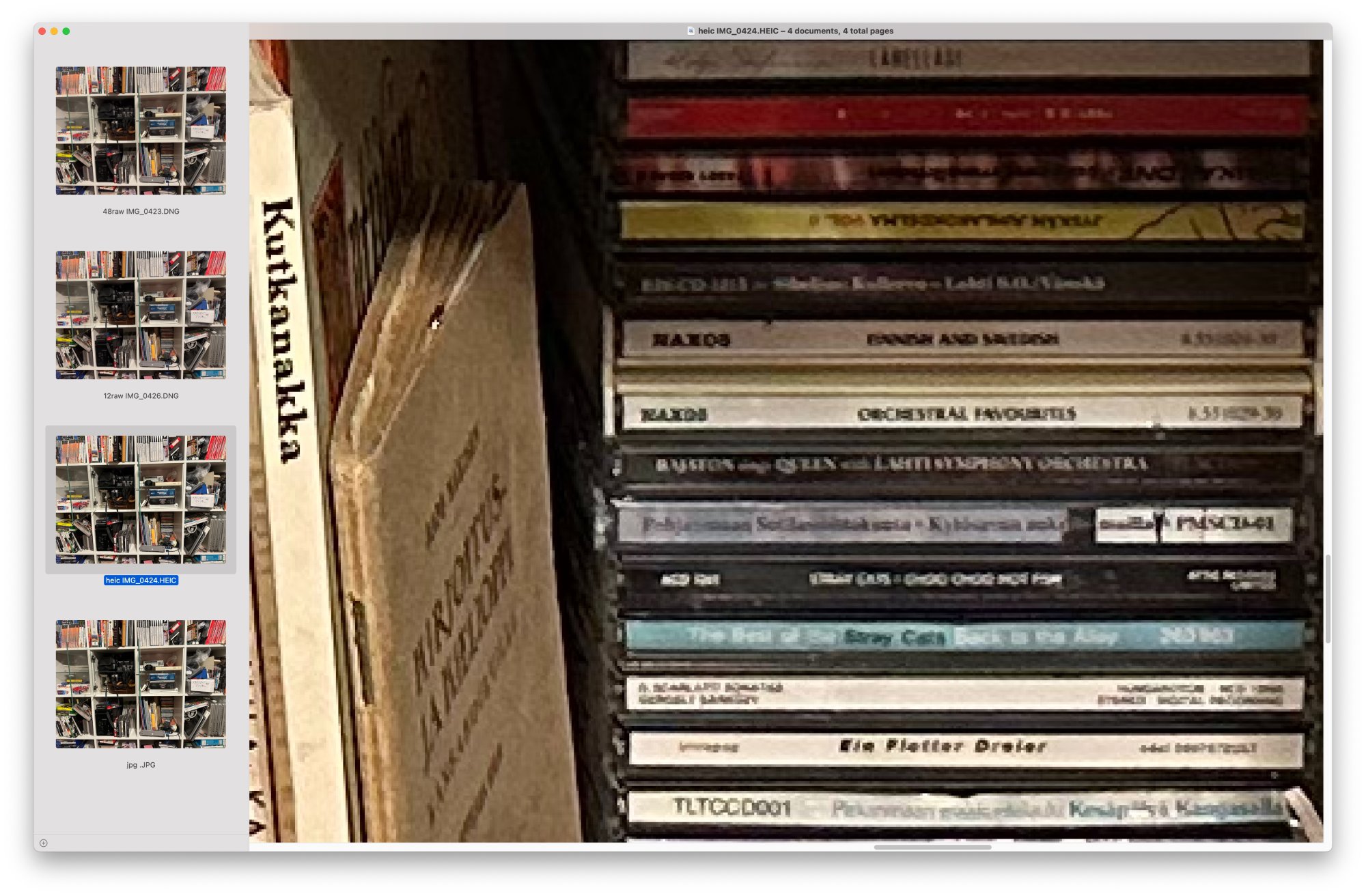

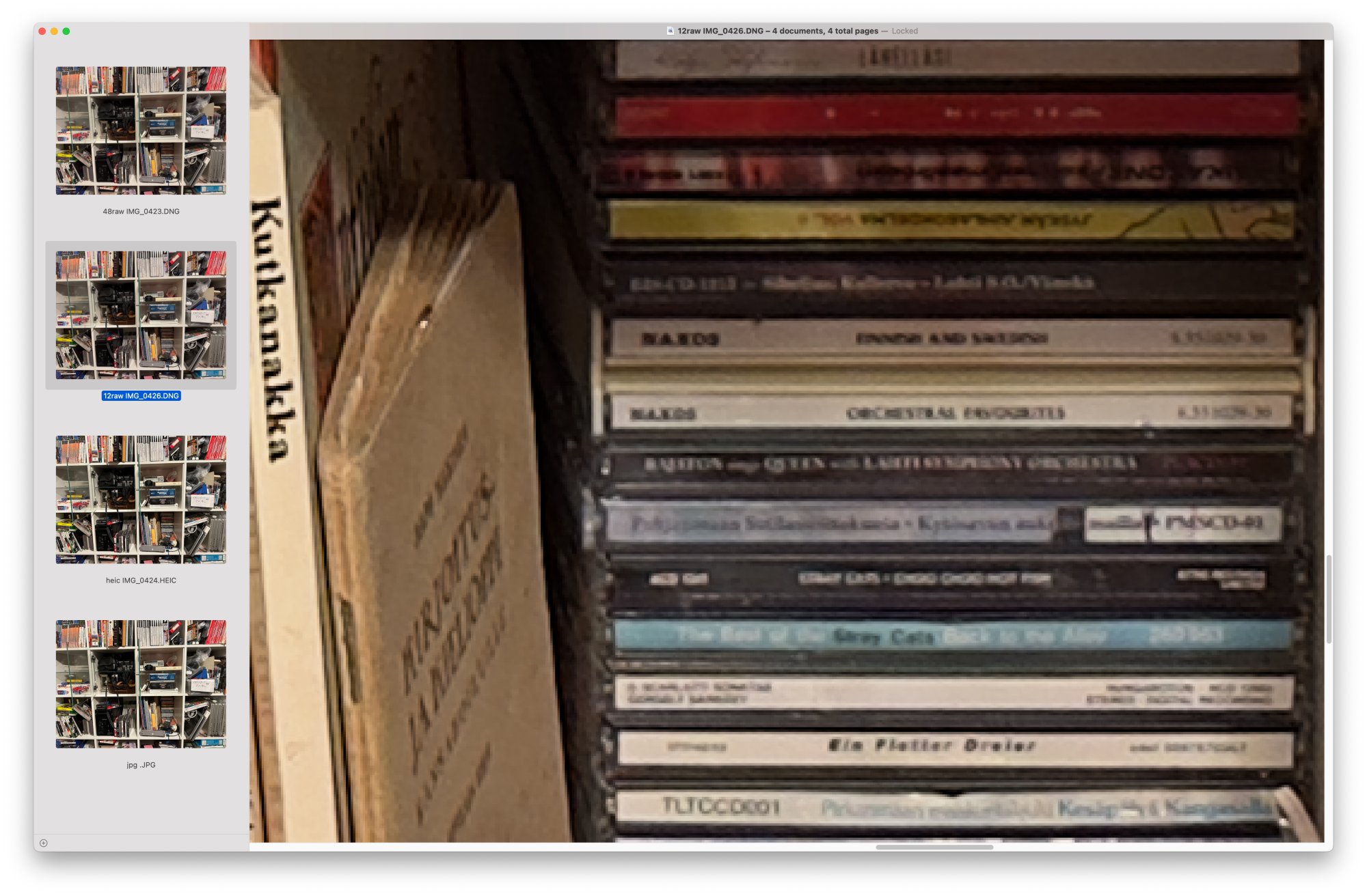

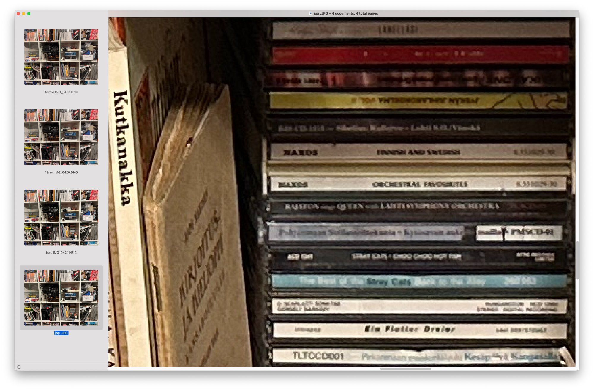

The four attachments show a heavily zoomed-in, center area of the screen with stacked CD's partly in light and partly in shadows. The CD inlays are variously colored. It's definitely worth notificing that black-and-white (or other kinds of very constrasty) content is VASTLY better in 48 Mpixels than in lower resolution. Not so with lower-contrast stuff, however. Check out for example "Pohjanmaan Sotilassoittokunta • Kytösavun aukella mailla" CD (dark blue writing on top of light blue background) just on top of the "STRAY CATS • CHOO CHOO HOT FISH" CD (the one with light blue letters on black background). It's equally unreadable on the 48 Mpixel image as is on the 12 Mpixel ones, while contrasty stuff like the just mentioned "STRAY CATS" does fare MUCH better on the 48 Mpixel images. This should be kept in mind - after all, it's not true raw image that you see here but a result of computational photography, which can't do REAL wonders.

The attachments are very good-quality JPG exports of the original PNG MacOS screenshots.

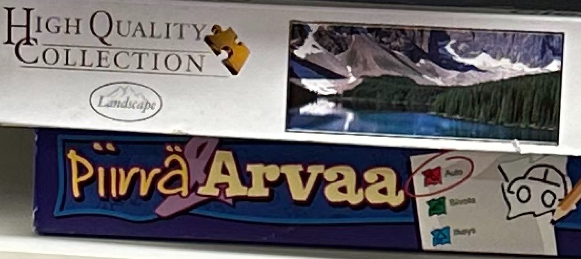

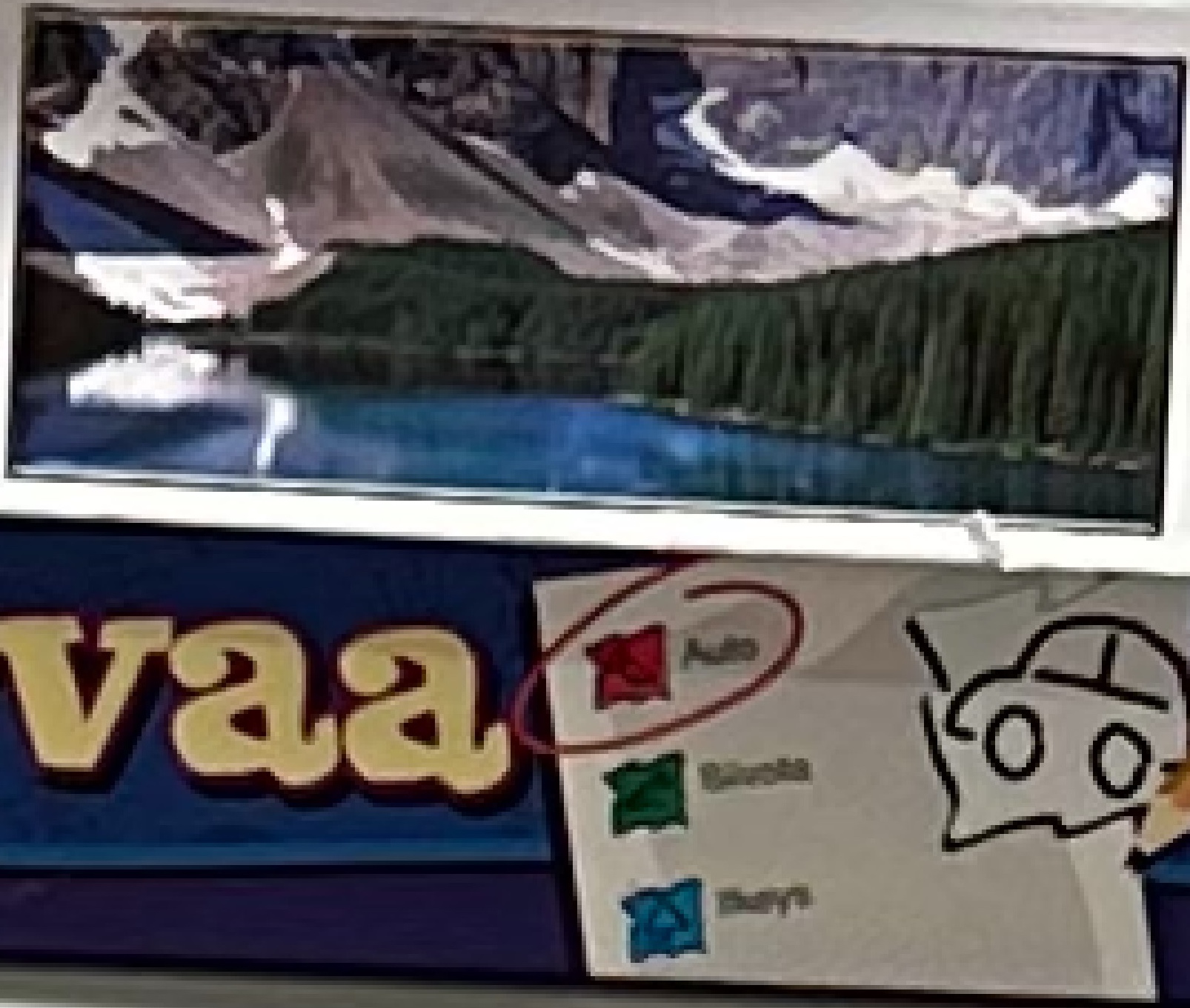

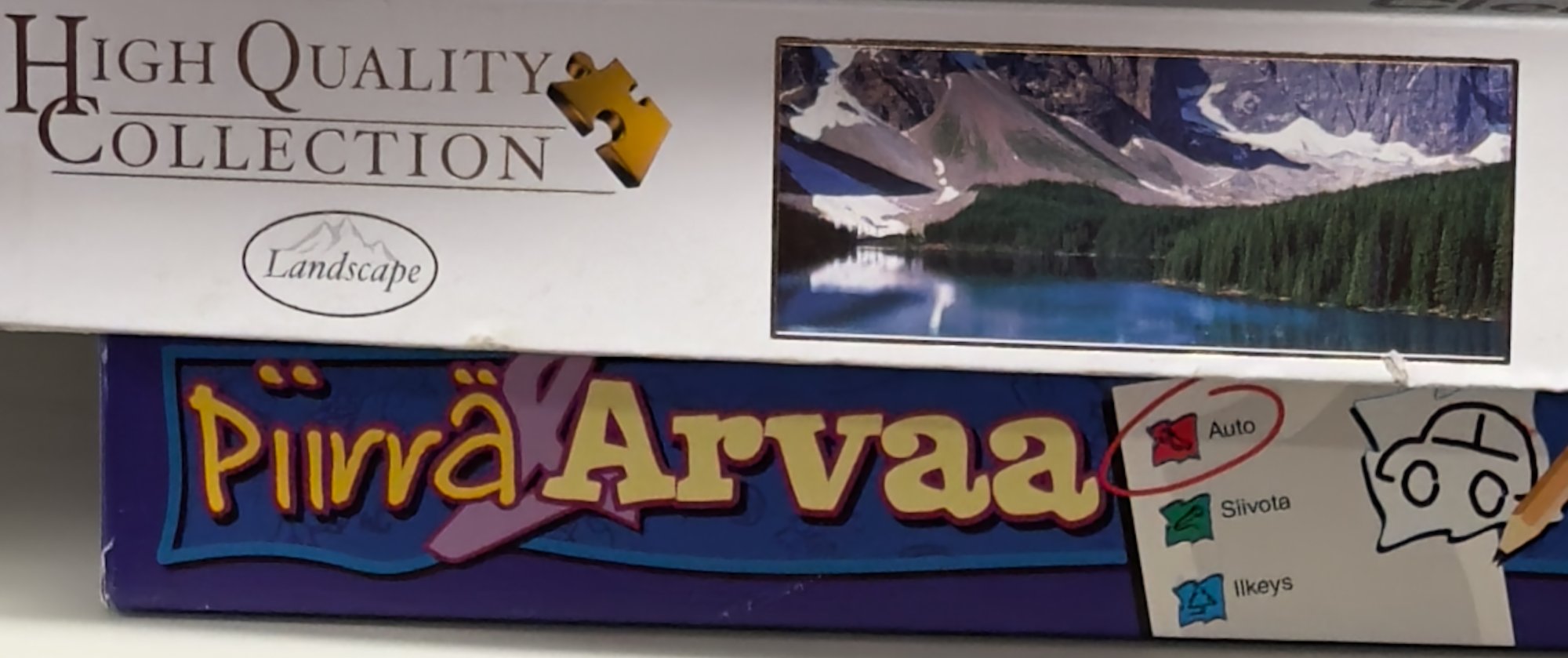

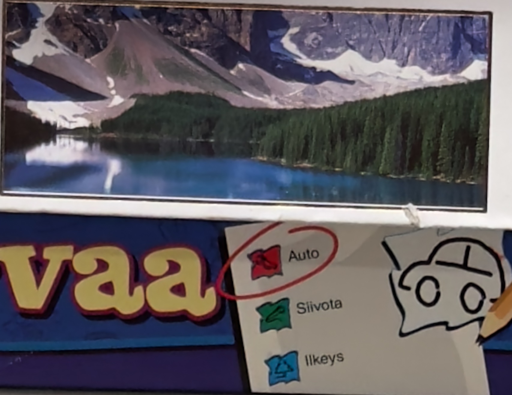

Check out for example the VAST difference shown in the attached two crops!
(again, this is (also) because of the high constast. With low-constrast stuff, particularly in low light, the advantage wouldn't be as pronounced!)

BTW, here are the two (now-inline so that you don't have to open and scroll the attachments yourself) crops you DEFINITELY should compare. All I can say is WOW!
