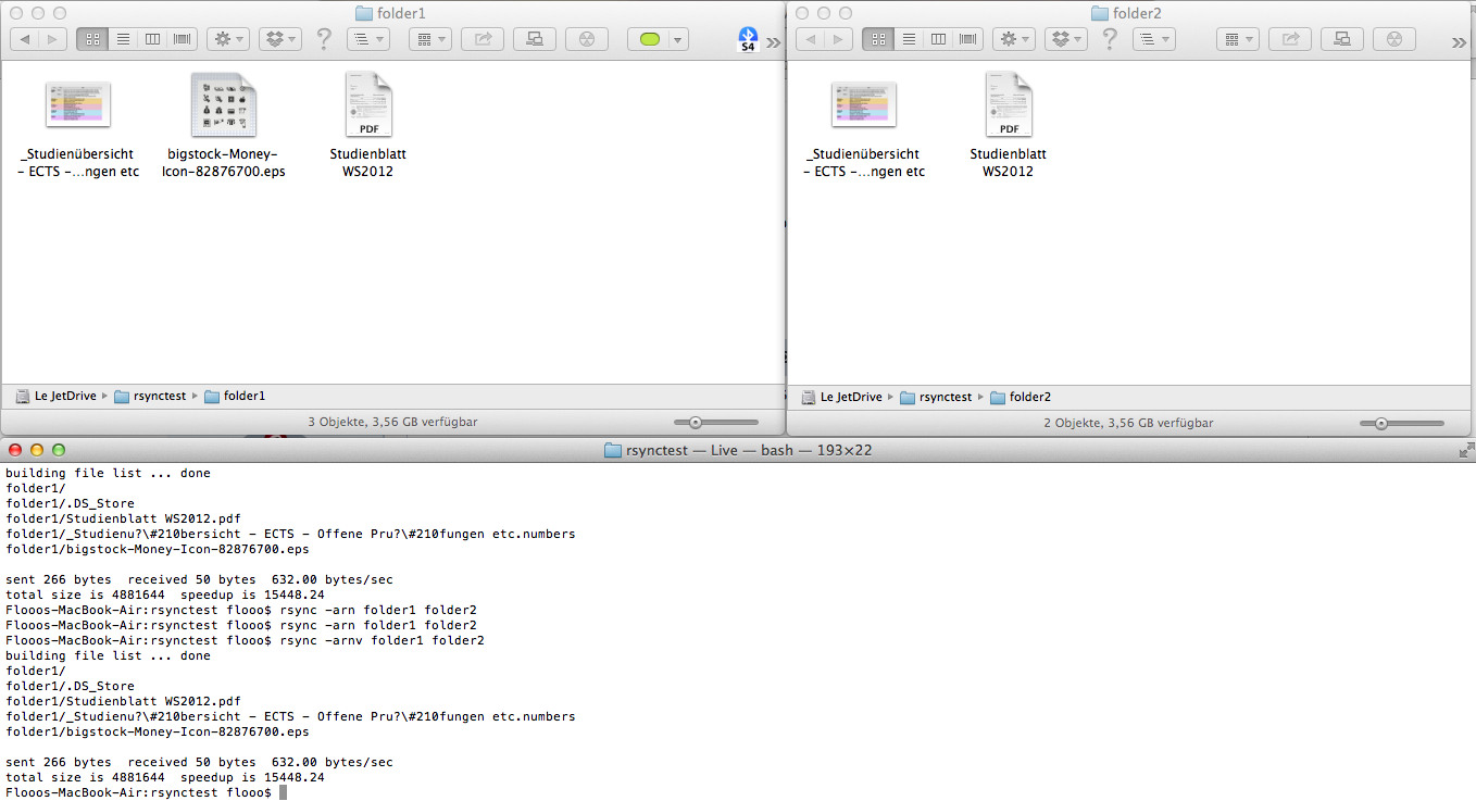

Sorry for the late reply. I was so busy over the past weeks and somehow forgot about asking this questions actually. So thank you for your kind reply. However, I just tried what you suggested, in fact with some testing environment with just two folders and 3 files insider folder 1, of which I copied over only two files to folder 2. Did a quick rsync as you suggested above and rsync doesn't seem to do anything. Weird, isn't it. Even with verbose, the output seems kinda meaningless, isn't it? Did I do anything wrong?
A rsync -avP folder1/* folder2/ will sync the two. If wanting to get rid of the files present on the target folder/drive and not on the source then you add a --delete to the command, to test what will happen before letting it do it a --dry-run should be added then removed when happy it will do what you want.
Thanks! The problems seems to have been with missing the slashes after the folder names to sync between. The following command seems to do exactly what I wanted: get a list of files that are in folder 1 but not in folder 2:
Code:
rsync -arnv folder1/ folder2/
Note: without the -v switch for verbose mode there is no output at all. So this seems to be needed to get any feedback in dry-mode… maybe there are other ways, but at least for me this is now doing the job. Thanks everyone being involved for your kind support and suggesting this alternative to DeltaWalker.
