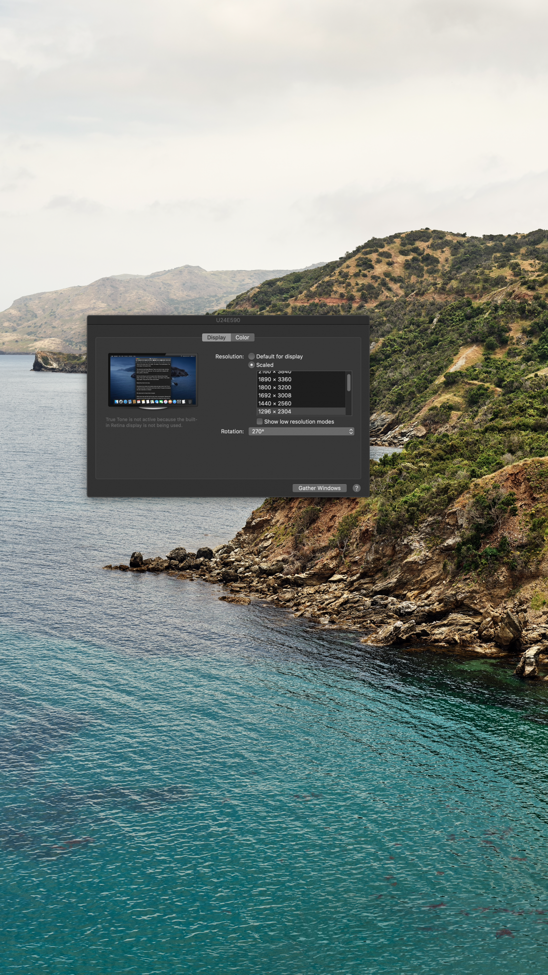

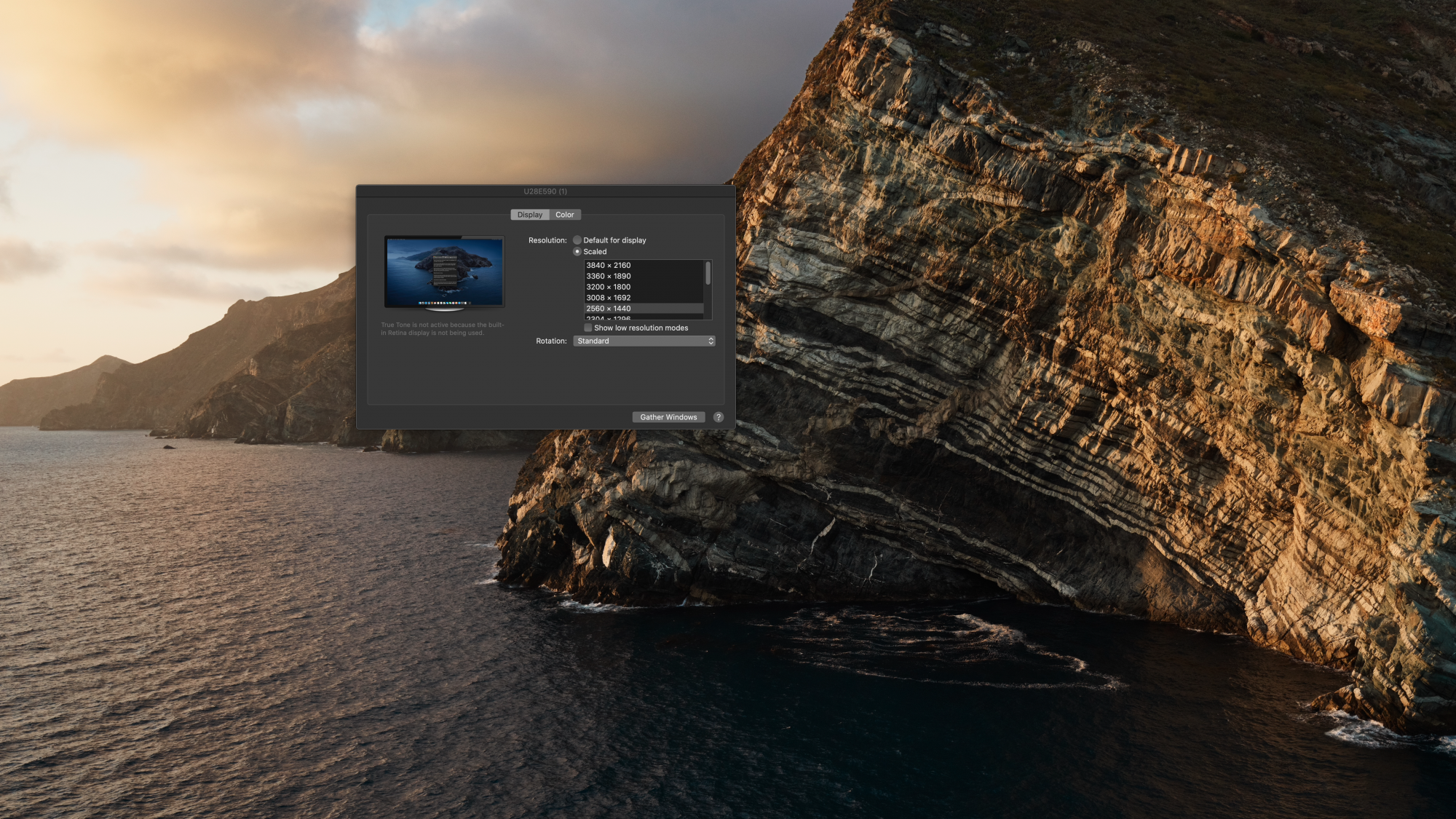

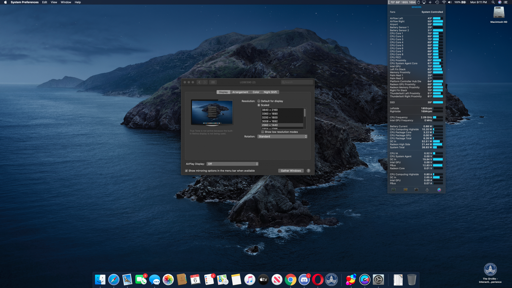

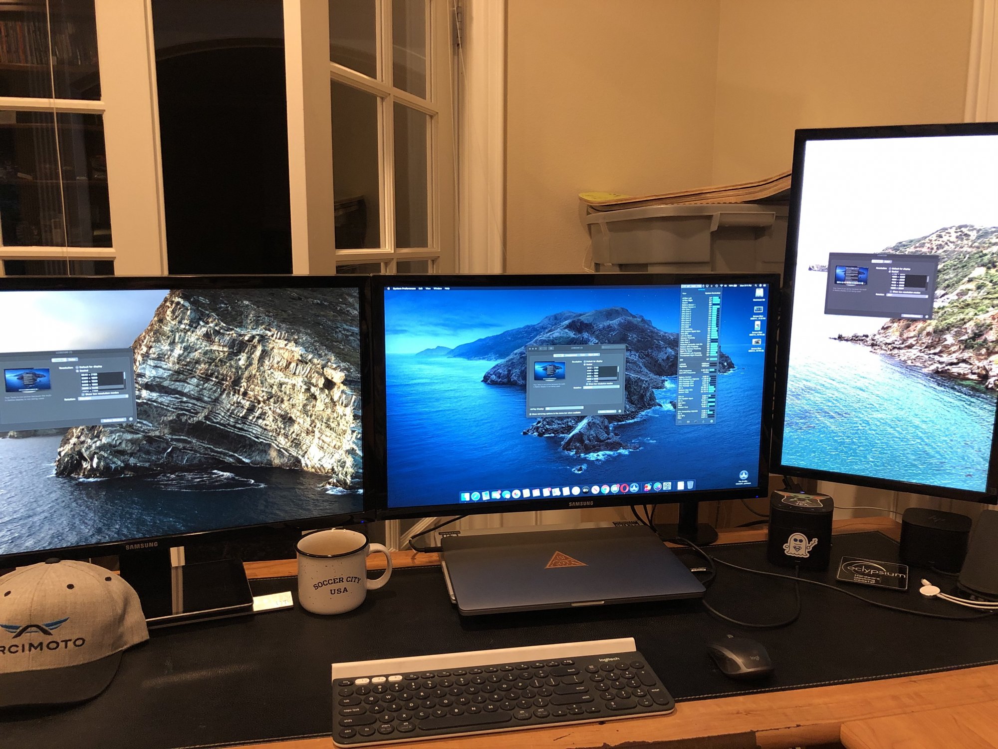

Here you go, at idle, CPU 70°C, GPU 68°C, fans at 1800ish RPM, in lid-closed mode, with three 4K/60 displays at non-2x scaling. (which is more GPU-intensive than operating at "Default" which is "Looks like 1920x1080" exact integer scaling.)
This is my normal. Lid-open temps and fans are slightly lower due to better airflow, even though there's then a fourth display operating.
Heck, while typing this, temps have dropped to 65°F CPU/63°F GPU, although fans spun up to barely-audible 2500 RPM.

Your dgpu is pulling 21 watts in your pics. It’s not too bad if my room is cooled down to 70F and I’m not doing anything too intensive. The problem is using high powered apps and you’re already preheating the chassis with that stupid 18-21 watt gpu idle power usage while taking away heat and power budget from the cpu. If the drivers or hardware were working properly it should only be using 5-7 watts on idle like my MacBook Pro 15 does when hooked up to an external monitor.

Brand of monitor shouldn't matter at all. They're all Samsung UE590 displays - one 24", two 28". Resolution and "looks like" setting are the important things. If you run them all in "native" - or "looks like" half their real resolution, it will be less GPU intensive than running it at non-native resolutions like I do.
